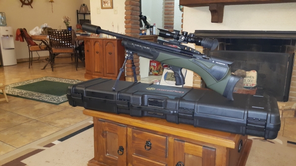

Tried to do some testing with chrony today but only had 190 bar of air. Jsb 25.4 pellets and fired 4 foulers and all were 990-995 Next 10 shots Ave. 975. Velocity then started to fall off. Fired 30 shots in total and pressure was down to 100 bar. Best guess is 30 good shots with 240 bar. Next test will be with the tank tethered at 210 bar.

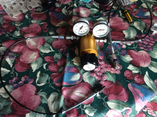

Does anyone have a suggestion for a regulated tether set up.
Pat
Thanks for the tip. My internet searches had already revealed that this guy really does sell kitchen sinks. I gave them a try and explained in an E mail that I wanted to add an adjustable 3500 psi reg. to my fill/tether hose. I also asked for a SCUBA din. to k adapter. Received an Email from Adam who said he was confused and to call him. I repeated my request with difficulty and he quoted $770. I said that is crazy and he hung up. Have found what I need for $389.
