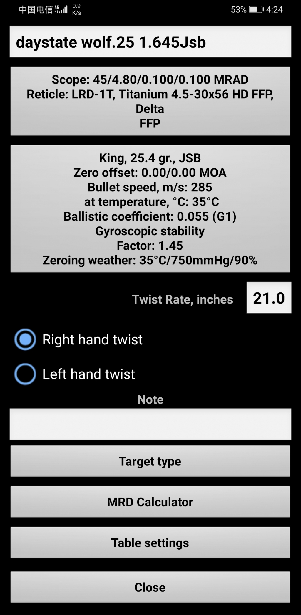

red wolf barrel
Red wolf barrel Twist Rare, inches?
Is 21in correct?
1:17 for ART and HP polygonal barrels. 1:16 for standard and non-HP and .177 and .22 per Daystate. I have the .25 HP.
