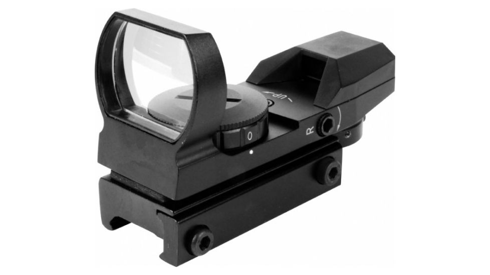

I use this Air Sports red dot reflex sight for my PP700 S/A pistol and it works perfectly. I have no problem with it tracking or the lights going off. Iv'e been using it for over a year now without any problems at all. It will fit on a picatinny rail or you can get a picatinny rail adapter if you have 11mm slots. For 30.00 you cant beat it.
