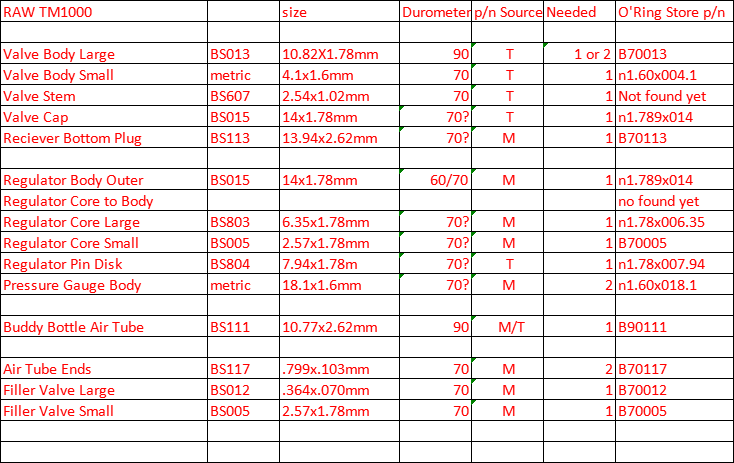

Thank you! Have you personally confirmed that the receiver bottom plug o-ring listed above is correct? It just seems a little big, but I confess I haven't pulled it apart yet.
And I do think you are right about the leaking o-ring... I was just hoping otherwise :( I ordered all of the o-rings for the reg, and the one for the bottom plug. Now I just need to rebuild it and hope for the best.
