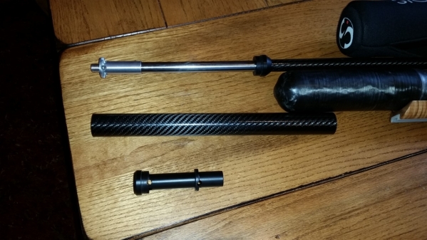

"SMH77"So how exactly did you remove the moderator? Do you have any photos of what it looks like inside the moderator? I'm curious how it attaches and what it looks like inside of one...

Here is a picture. Just unscrew the cap and the tube slides off. Takes about 10 seconds. The HMX .25 is quite a bit louder than the HMX .22. I tried to sleeve my .25 with some high density foam mat. It did not change a thing. I'm surprised they are that load being that long, but it is what it is!
Thanks for the info and the photos-that helps a lot! In the other 'RAW' thread, there is talk that Salticon will be offering a special version of the 'DonnyFL' moderator specific for the RAW's, soon (I believe?). That should quiet them down a bit too. I'm wondering how much louder mine will be going from .25 cal in 50 fpe up to .25 cal in 60 fpe? Additionally when I install the .30 cal barrel setup on it to. I'll have my answers tomorrow.

Interesting question as to what exactly is causing the change in POI. Perhaps the carbon fiber silencer external shroud is not machined true on the ends and is pulling the barrel from straight as the cap is tightened?
