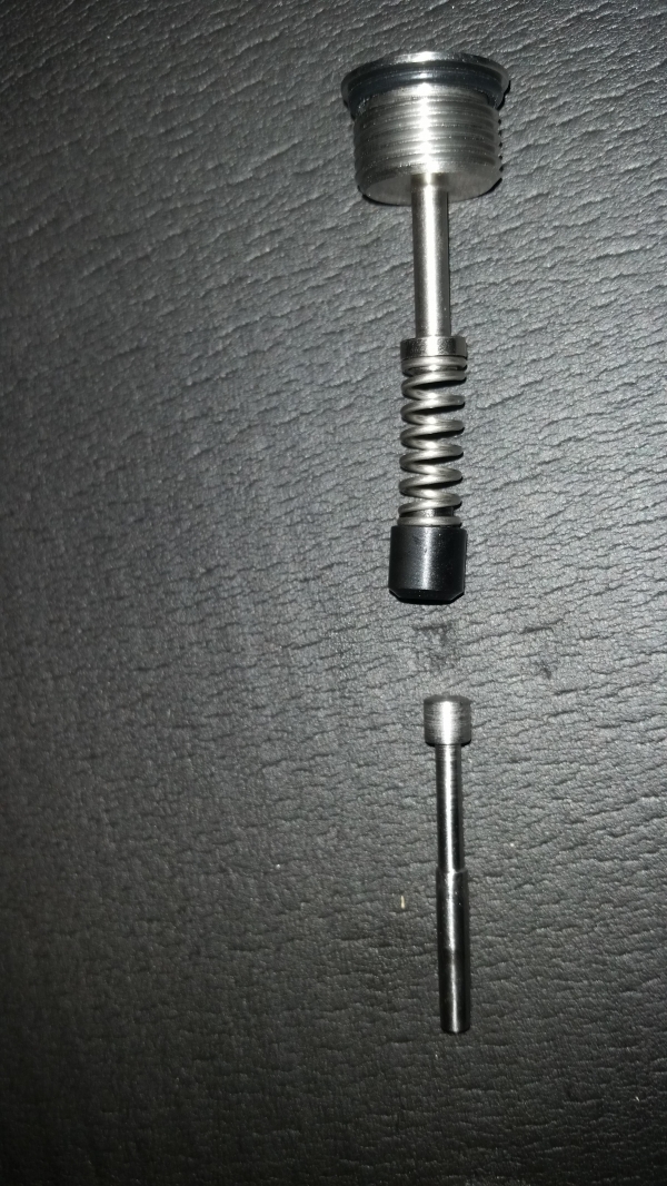

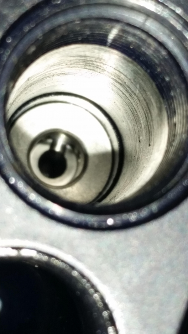

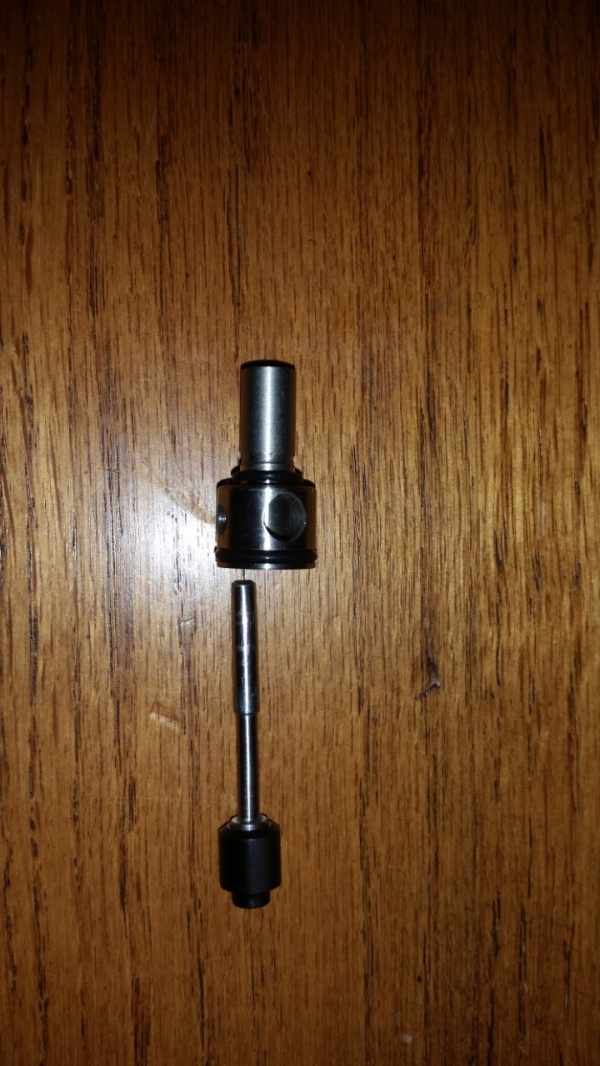

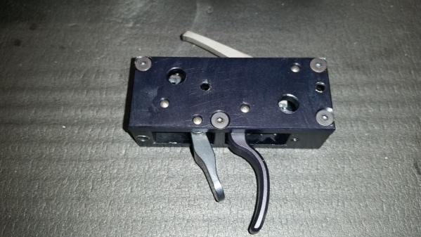

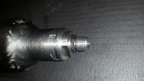

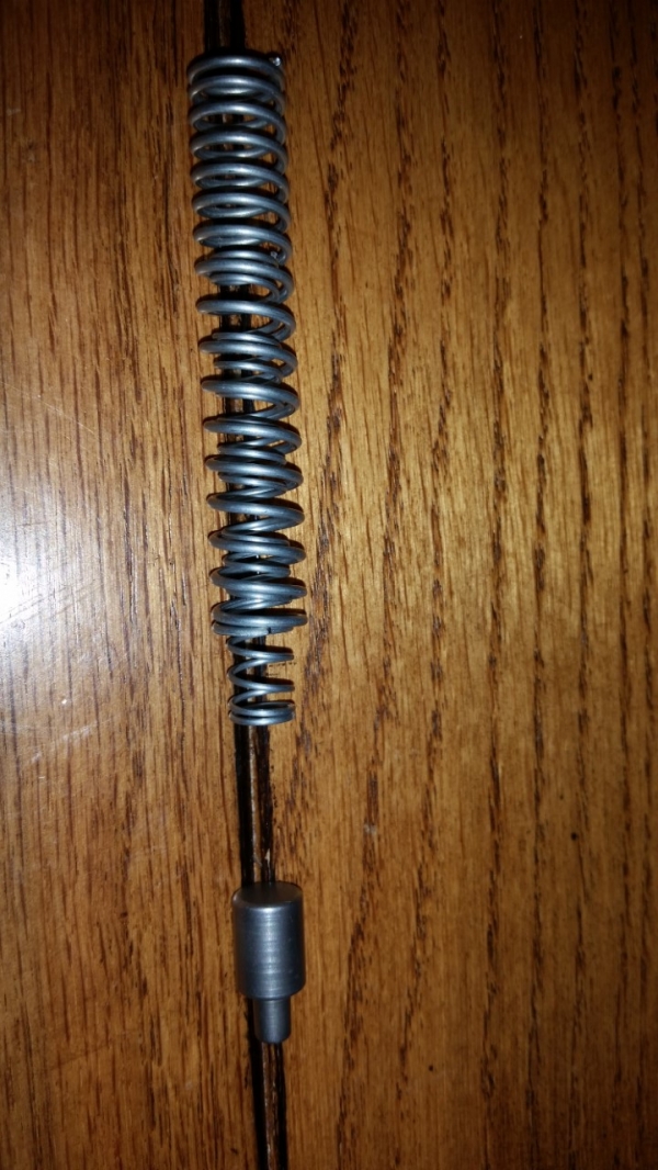

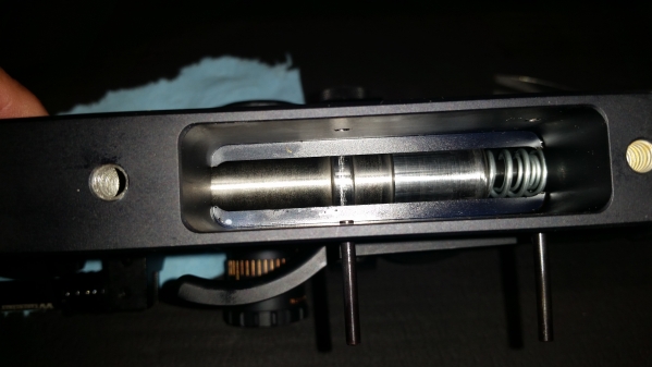

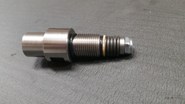

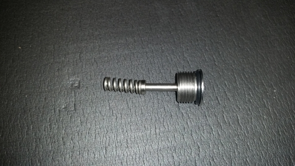

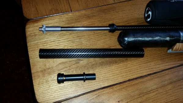

RAW HMX Parts (Pics of inner Guts)
V Quick fill block, Foster, check valve, spring, gauge and 4 o'rings.
Regulator and I believe 4 o'rings.
Trigger assembly.
Hammer Assembly Hammer, inertia weight, 2 springs. spring guide, power adjuster plug and o'ring.
Valve spring, plug and 1 o'ring.
Valve bore with seat.
Valve plug, spring,delrin guide, and valve.
Valve with delrin guide, valve seat with 3 o'rings.
Standard round moderator assembly.
Bottle neck with o'ring.
This is a Rapid Air Weapons HM1000X .25 LW
A few questions have come up lately about RAW parts and/or what's the inside look like. I have never seen a parts schematic on the RAW HMX, so I figured I would compile a few pictures of the guts from my gun.
My opinion is...... The HMX seems to be a simple design which is built like a tank. Feel free to correct me or add pictures or other information. Other parts can be found here https://www.rapidairweapons.com/xcart/home.php?cat=256&sort=title&sort_direction=0&objects_per_page=50

what are your guys opinions do you think the walnut is still drying and shrinking thats why there super snug my laminate wasnt pry bar material but once out it goes back and forth nice and snug,,,is it just walnut that super tight? pat love the pics unfortunately i had to brake my rig down like yours,, according to mark b some of the hammer springs are diferent mine is doubled up like DIRTES some may be singles
