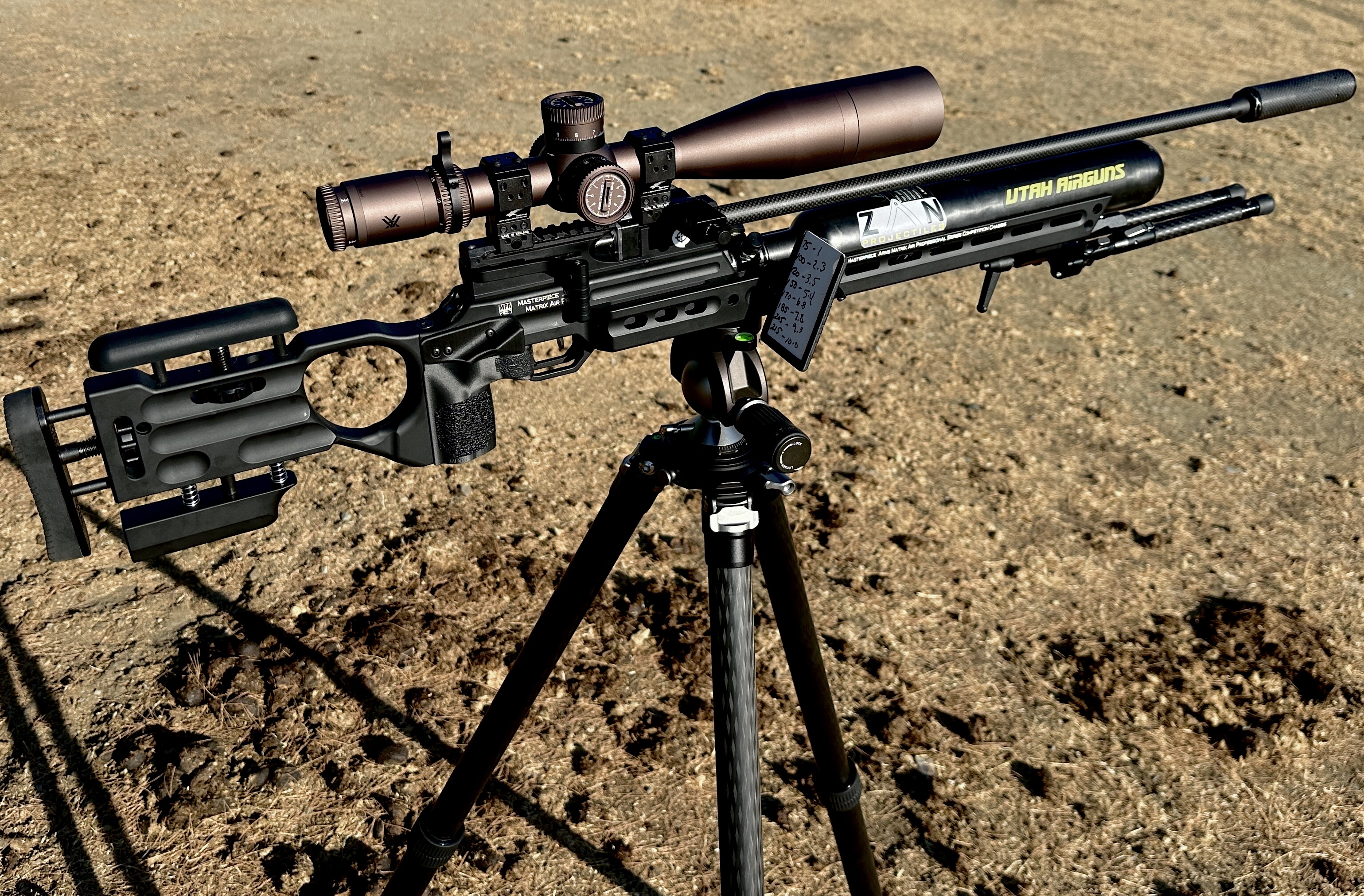

My son Cooper has been shooting a .25 RAW HM1000x for a long time and was super lucky to win a Masterpiece Arms chassis for it at the RMAC banquet. The RAW has been the most simple, reliable, durable, accurate airgun in our lineup and we have some nice airguns. The addirion of the MPA chassis made Cooper, his brother Alex & I all fall in love with his airgun again.
So, I’m sure you can see where this is going… Cooper hasn’t been shooting airguns much since our return from RMAC. School, football, girls & deer season have him busy doing other things. I asked him if I could borrow his RAW for an upcoming NRL22 match in Sept. & he said yes. I got it set up specifically for NRL22 matches. I mounted a new optic on Eaglevision rings, added a Tier One ATAC bipod, an MDT electronic level, a Midwest Elite Airgun high capacity magazine & a carbon fiber Donnyfl Tanto… The new Donnyfl Yokozuna & RYU get here today & they're sick!!! The Ryu will go straight on the RAW! We know which slugs shoot best out of the .25 RAW so I tested those slugs, found the best & tried to validate dope out to 350yds. It was dead on to 160yds but got weird past that. Since I‘m shooting the Varmint Knocker 32.8gr slugs, I called Dale to confirm the BC & talk about using multiple BC’s for different distances… 0-150, 150-250 and 250-350. He agreed the multiple BC idea works but suggested I shoot them even faster. They perform best out of the LW polygonal barrel at 980-1000fps and the BC matches, or is much closer to matching the Kestrel and Strelok.
As many of you know from when I started posting .25 slug data back in 2017/18, I’ve always been a proponent as shooting slugs as fast as possible, not only for stability & accuracy but also the higher BC & retained energy at long range. I was shooting these slugs around 950fps, about all I could get out of the RAW without pushing it too hard. As I mentioned, Dale suggested I shoot the 32.8gr faster, at 980-1000. I adjusted the regulator which increased the velocity a bit, then I tuned the gun with the hammer spring. I’m now close to the velocity Dale suggested but would like the ability to test the higher velocities and also turn down the hammer spring.

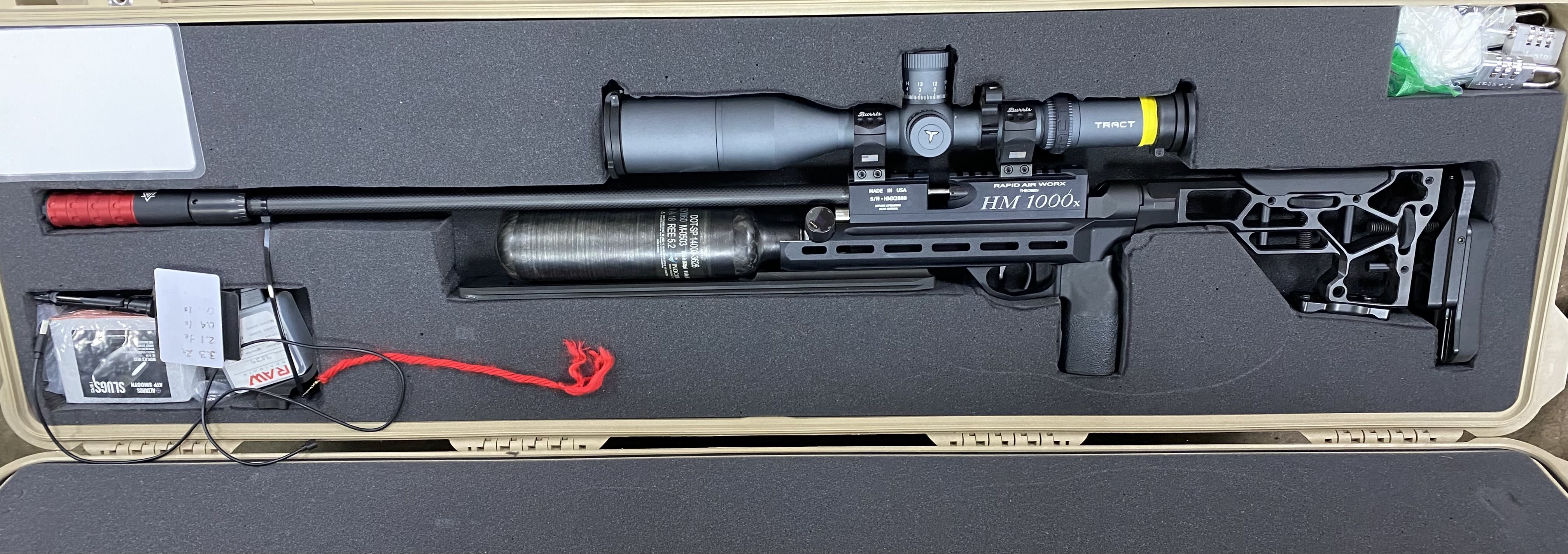

Finally, to the point oft this post…😉 I’m trying to find out if any of you have, or know where to get & external plenum for the RAW? Although very cool, I am not interested in Mubhaur’s design. It will not work with the MPA chassis & I don’t like aesthetic. I am looking for the in-line design(I attached a picture). I do know someone who’s brother makes & has them for sale but he is out of town for a while. I was also told that Martin makes them, he too is out of town until Sept. 6th. If anyone knows someone who makes them or has one they’d sell, I would really appreciate it. I’m normally not in a hurry like this but the match is in three weeks. I need time to install, get tuned, validate dope and practice a little bit.

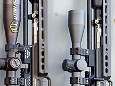

Haven’t talked to Martin, don’t know anything about the specifics of his plenum. I just know he’s away until Sept. 6th. The other guy I mentioned, the one who has the plenums made… The ones I attached a picture of in the post, he contacted me today. I’ll know more about the specifics tomorrow. I know they’re machined from a solid piece of aluminum, thread into the block on one side, the v-block screws in the other end. If I am able to get one, I’ll let you know the specifics. If you have the ability to thread a co2 cartridge, you could certainly be able to thread a piece of thick walled aluminum. You could make it any length you want.

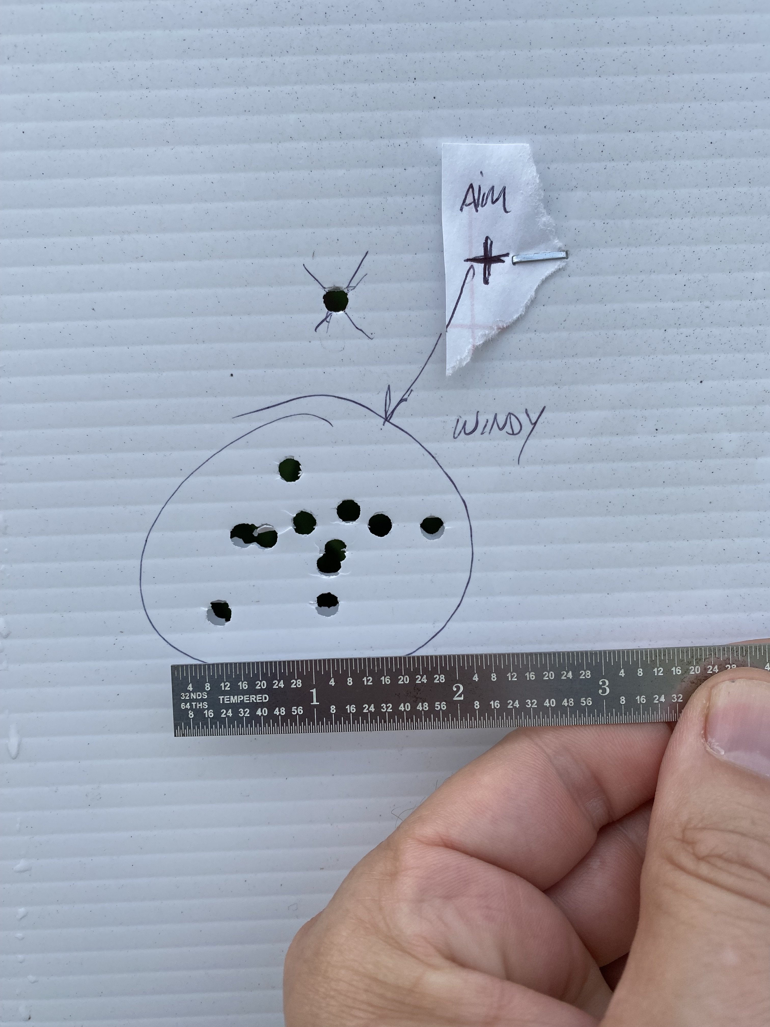

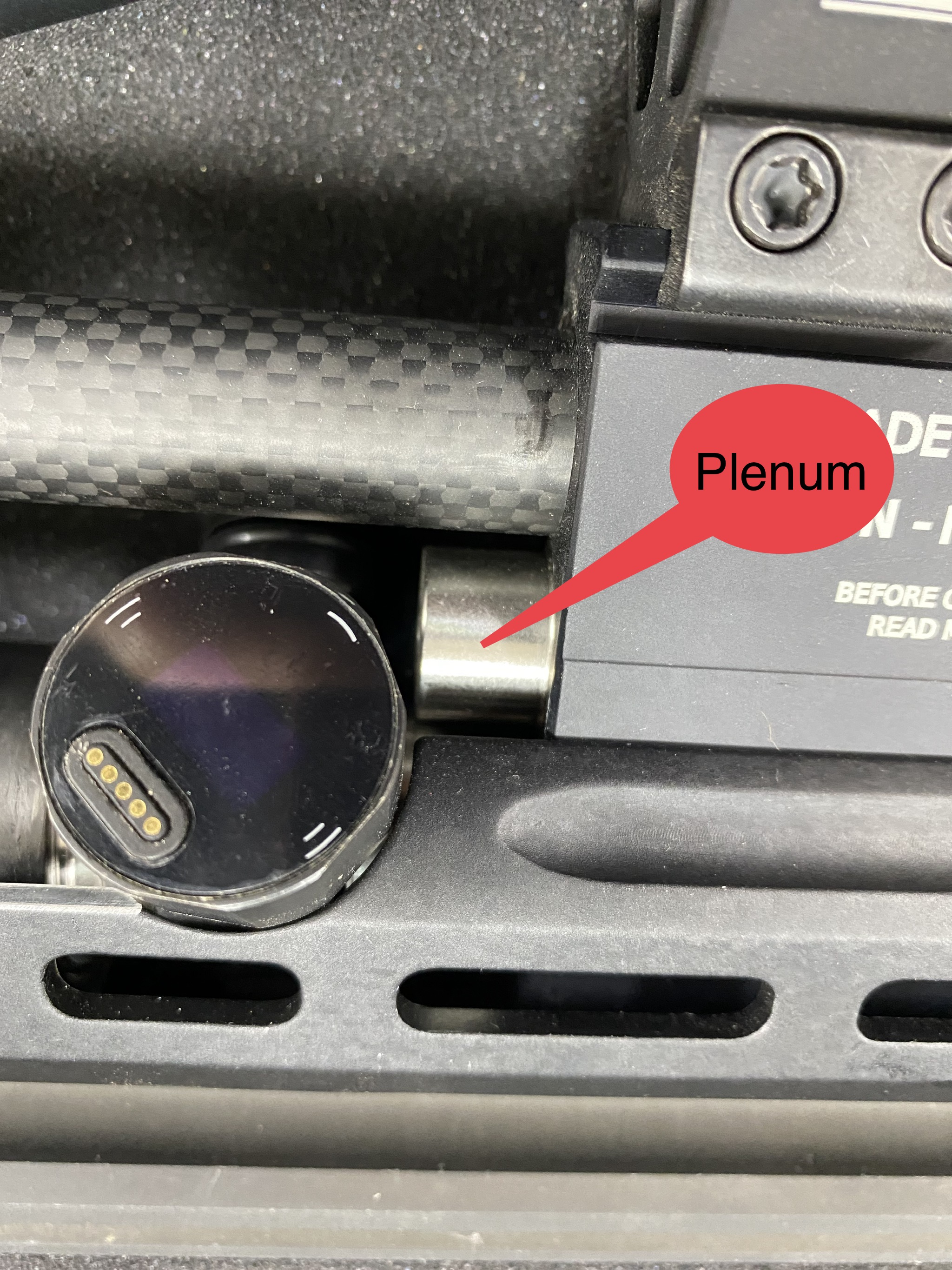

Morning all. You would be surprised that my RAW is actually almost stock, and is shooting Altaros Smooth ATP .22 cal 32.5gr slugs at 915fps. They are incredibly accurate at this speed all the way out to 250 yards so far. See 1 MOA (2”) group at 200yds below.
I have the regulator set at 145bar and it has a dual hammer spring. The only non-stock part is a small plenum extension that screws into the valve return spring plug hole above the regulator. With this gun setup, I am able to achieve a max of 920 with these 32.5gr slugs, and Altaros says they shoot best at this speed. I tried slower and they weren’t as accurate, but haven’t tried faster yet.
I plan to start working on some improvements so I can shoot the 32.5gr slugs faster (980fps) and also shoot the Altaros Smooth .22cal 40gr slugs at 910-920fps when it cools off this fall. One upgrade will be a larger plenum.
