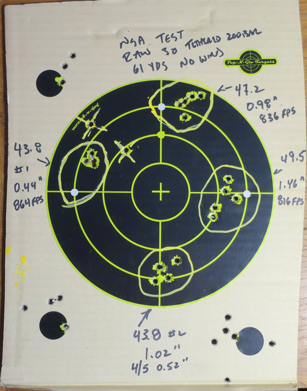

I tried the NSA's in my .30 cal RAW this morning, and especially the 43.8's were awesome (the way my gun is currently tuned). My first group with them was 0.44" (5 shot group at 61 yards), and my second group had 4/5 in 0.52". Chrono says that they are running 864 fps at the muzzle. And only a 5 shot chrono group, but had an ES of 2 fps! That's some nice stuff.
The group for the 47.2's with my gun's tune (836 fps ave/ES=2) opened up to 0.98".
And things opened up even further to 1.46" with the 49.5's (816 fps ave/ES=3).
I've attached a shot of the target. A couple of hits marked with X's were zeroing shots with the heavier pellets, which dropped into the target zone.
All in all, my RAW .30 shoots the NSA 43.8's more accurately than pellets, and way more accurately than FX Hybrid Slugs.
I've got to get me some more of these NSA's... and find out how they shoot in the Red Wolf 303. Thanks again for the tip!

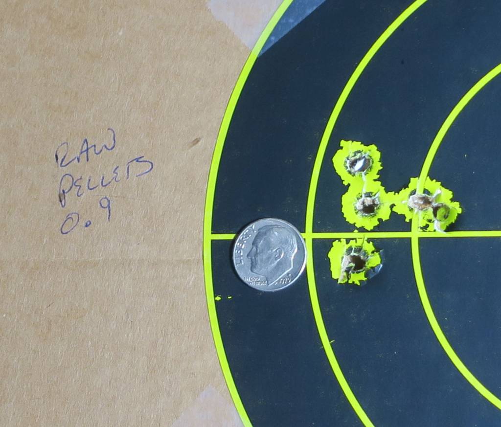

Below is a pic of the pellet group during my pretty quick-and-dirty testing of pellets vs FX hybrid slugs in my RAW .30. Kind of hurrying to beat incoming winds, but I would say that this is pretty normal for me shooting my RAW - 0.9". I can handle the Red Wolf HP .303 better, and my typical groups with that rifle (pellets) are 0.7 or less (both at 61 yards, the longest target box on my backyard range). The pellets I normally use for home practice are JSB variants - Rangemaster Emperor Lite 44.75 gr. I have not noticed any appreciable difference between my shooting of my RAW or my RW with any of the JSB variants - JSB, Rangemaster (Daystate) or FX.
This is why I was so excited today after shooting the NSA's. My RAW (at least in my hands and in its current state of tune) may actually shoot tighter groups with slugs as compared to pellets.
