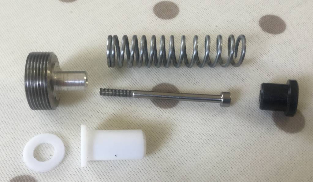

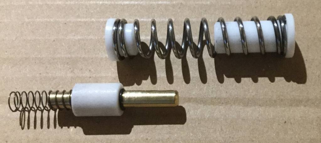

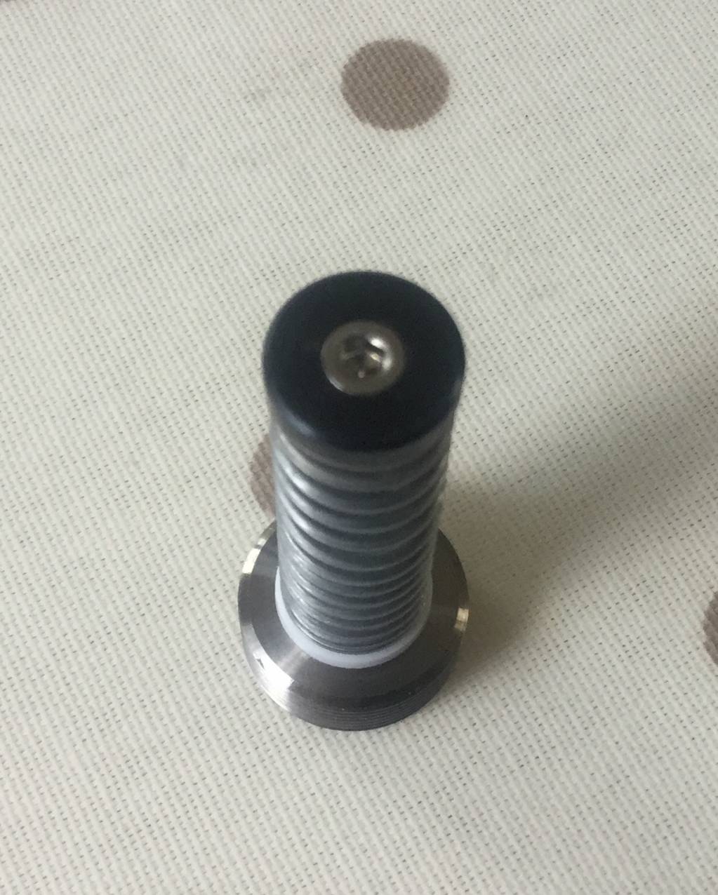

Have a look into the hammer, at the very bottom there should be a small protrusion from the thread of the hammer pip, this it the thing the inertia weight hits, if it doesn’t stick out far enough the inertia weight smacks into the end of the spring.
If it is not there, the simple solution is to make a small bush that is the same Dia as the internal bore of the hammer with a hole slightly bigger than the spring Dia and slightly longer than the pip on the end of the inertia weight. Once fitted, the bush takes the hit not the spring.
this is a heavier through spring inertia weight that I make, it increases consistency and reduce action noise
Bb
Bucket Boy, Thank you for the tip!! I will check and see, I just went to the hardware and got a couple more springs one being slightly heavier than the last two I tried. Don't know what effect that will have but it shot the same speed with the same hammer spring adjustment. My gun is a 20 Ft. Lb. rifle for heavy varmint class so I have the double hammer spring in mine. I think you may have something there about the pip threads not sticking out far enough as I seem to remember it stuck out but not by very much. I will check tonight and let you know. I wonder if cutting the spring a little shorter will alleviate the spring (coil) bind I guess you would call it? you would think that the smaller diameter area on the Inertia weight would be plenty of room for the spring to compress without smashing?? Do you think the stronger spring will hurt the dampening effect of the weight? Again thanks for your help!! J.L.
