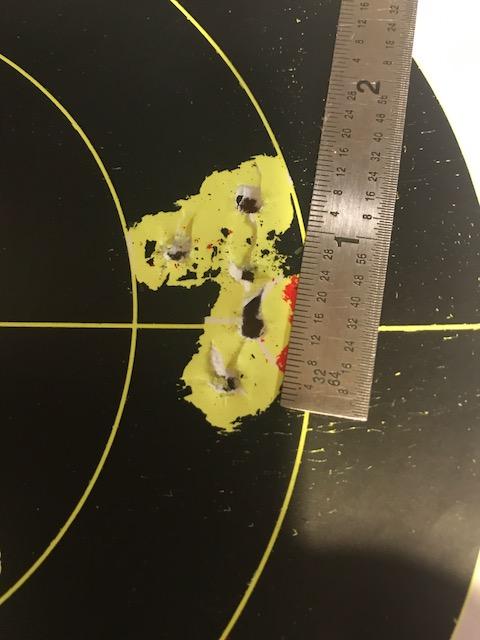

Quest for the Holy Grail: 1" @ 100yds with Gen 2 Marauder .22
Good gracious this took a lot of time, effort, $$$ and I'm still just a little short, but....
I finally got all the stars to align for an early morning shoot with no wind and got some decent groups which were repeatable.
I measure this optimistically as 1 1/8", maybe you'll call it 1 1/4 -- with JSB 18.1 @ 915 fps

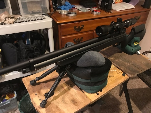

Here's how I'm set up:
  1. Marmot Militia HF barrel
  2. Hill Valve/hammer/spring Kit (custom valve, spring, hammer etc.)
  3. Huma Reg set to 2100 psi
  4. Primary Arms 4-14XFFP R-grid (first focal plane)
    [/LIST=1]
    All these mods excluding the scope cost me more than $500, and I'm still not sub MOA, LOL!! It's only money.
    This has been quite a journey that sucked me completely into airgun world. And now I have a shooter, almost. Its been fun.
    If you're a noob doing research just know that despite YouTubes, blogs and all the rest, my opinion is the Marauder .22 unmodified is a 50yard gun, not a 100 yard gun. Yes you can hit at 100, but not with consistency that will make you happy -- and certainly not with enough accuracy outside 50-75 to humanely take game.
    More opinion: If you want a 100yd shooter for less than the $1300-$1500-$1900 class, consider buying a used Marauder and then spend the real money on all the modifications it will take to build it up. You can get yourself something done perhaps for $700 - $800 with some sweat equity. Learning the guts of these guns is instructive if you are getting into this sport. This is a postive side effect of this strategy.
    Look forward to hearing comments and different opinions.

I didn't haul chrony out to campsite to get #. Shot prone with bipod and rear bag off some firm sand. But I'm confident about the 915 because of the bench work at home and the reg. It's pretty consistent 910-920 ish. Also I overfill this gun thanks to reg. 3250. Might be dumb, but no harm so far and I'm no brain surgeon so dumb is as dumb does.
