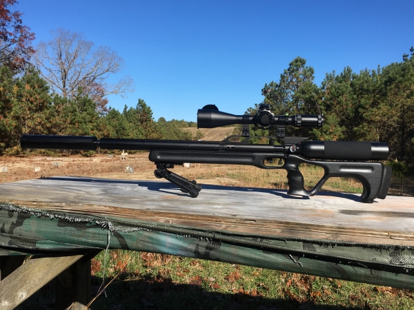

I have the CondorSS in .25, my favorite mods are the Maddog stock and Donny Emperor. They are cool guns, I’m sure others will recommend some good performance mods.

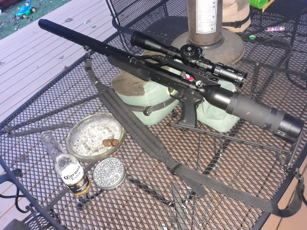

Congrats on the Condor. I have a Talon SS I’ve left stock except for adding a laser. 🤭 and a bubble level. If you want to shoot precisely past 50 yards or so I highly suggest a bubble level addition and use a chrony to get it tuned as suggested above. Since the scope over bore is almost 3” your mechanical offset for close shots is greater than other guns and any cant will make for some missed if you are dialing your dope. I went through a lot of headache guessing until I got a chronograph and found the magic power setting and top hat position for the specific pellet. I also wrapped 550 cord and webbing around the frame in front of the scope and hooked up a two point sling.
