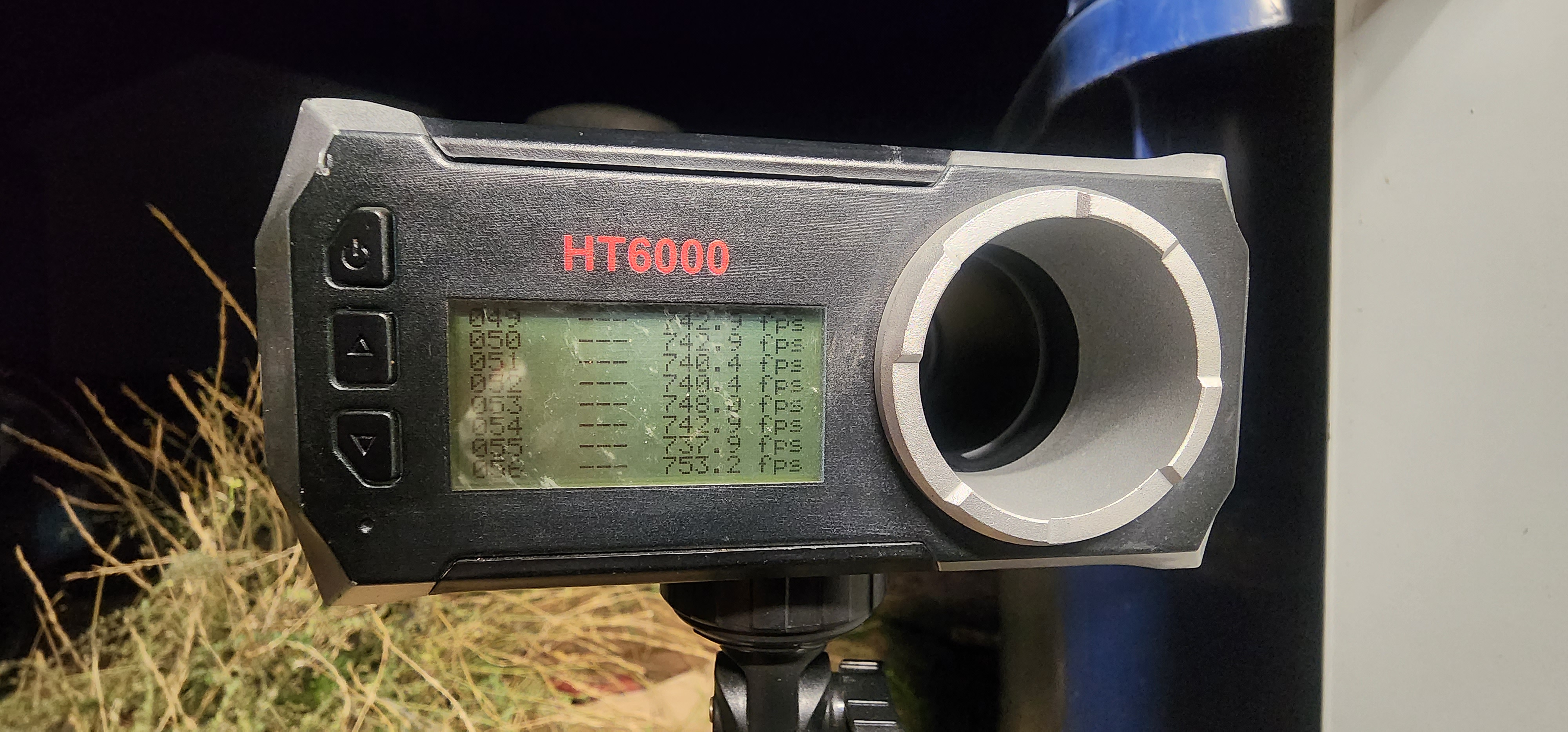

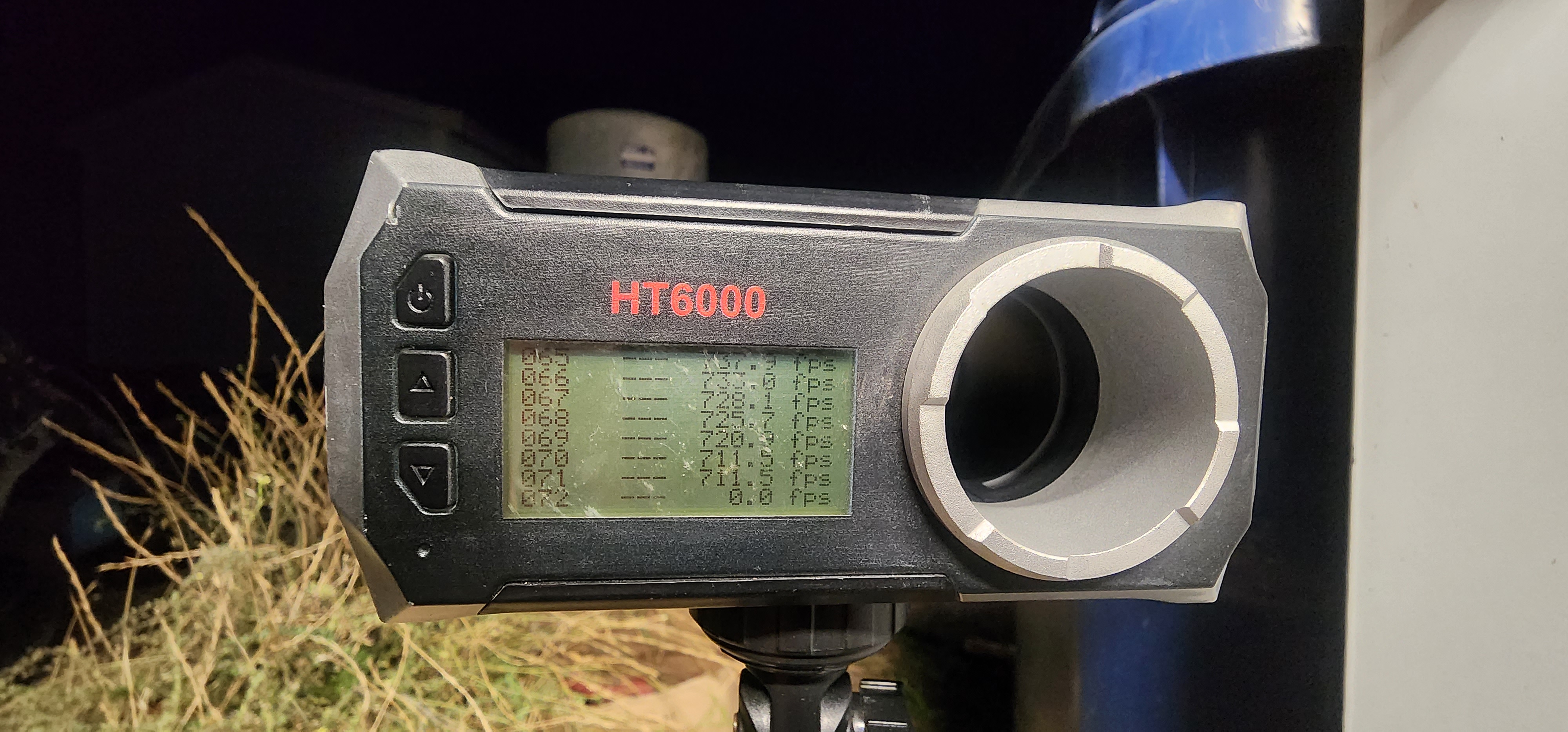

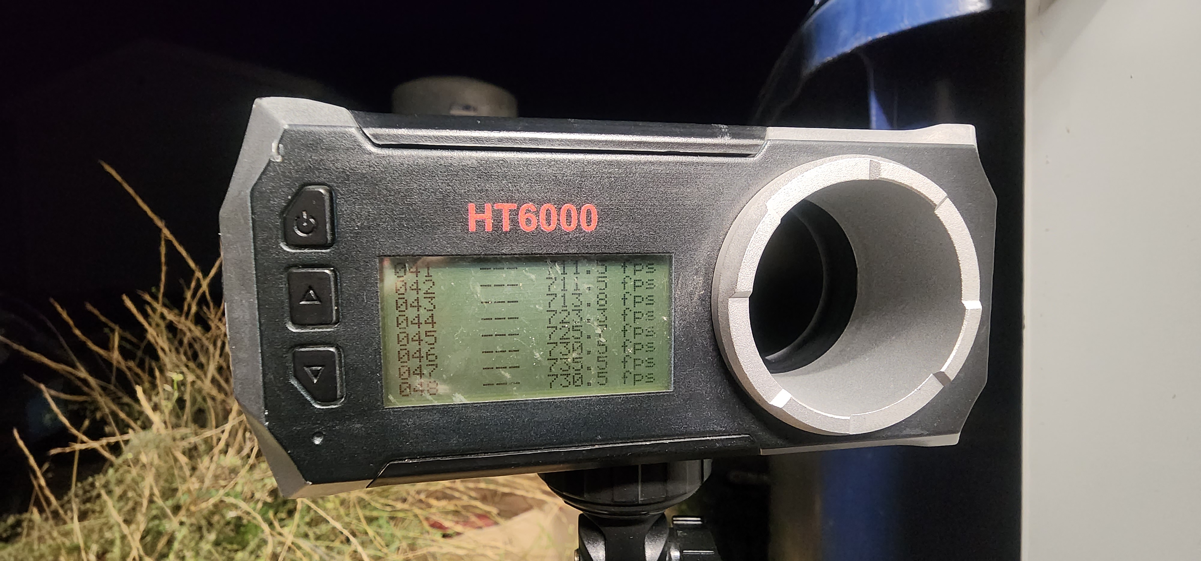

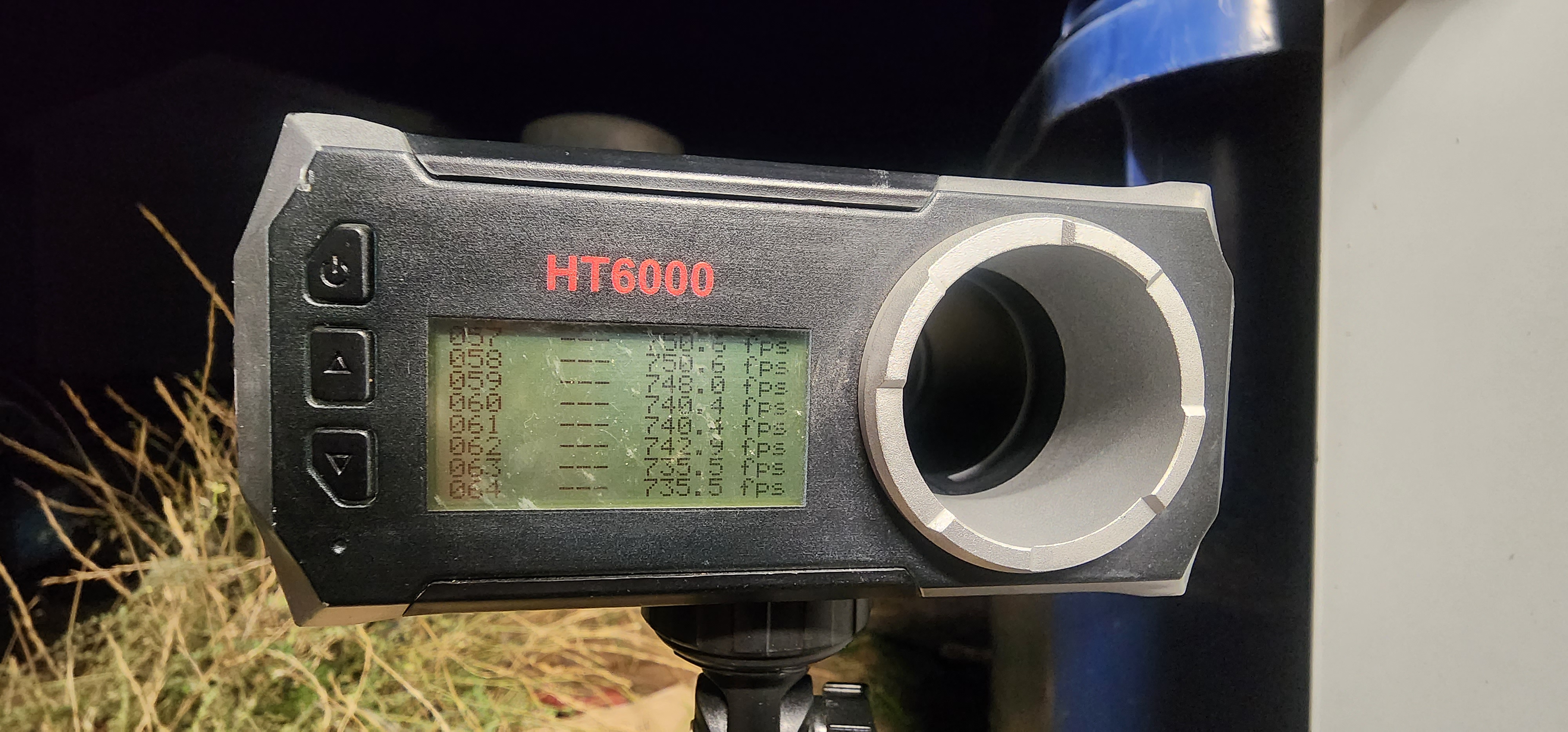

While I was up there he said the marauder pistol I convinced him to buy (6 or 7 years ago) wasn't taking a fill anymore. Seeing it had been a long time since I've done a simple tune installing a Bstaley mod to the gun with a transfer port drilled out to match valve exhaust.
I figured I wouldnt do any valve porting. I swapped the hammer spring by boring the spring hole diameter out to 8mm so I could fit a slightly stronger hammer spring. I increased hammer stroke by a little over 1/8", I stalled two Bstaley orings, backed the HS out counter clockwise to be recessed as much as possible. Shot a string with 30 shots with an ES of 35 around 16fpe w/ 14.3.
The top of the curve was around 2100psi, I increased the hammer spring preload by 1.5 clockwise and refilled to 3000psi.
14.3gr CPHP
17fpe Avg
Low 711.5
High 753.2
32 shots
3000psi to 1800psi.
Im pretty pleased, I know the ES is not the tightest. For my friend this is a 10-25y ground squirrel garden gun.
