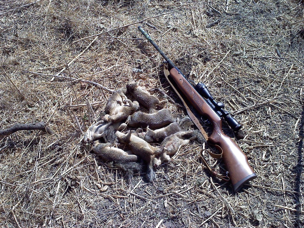

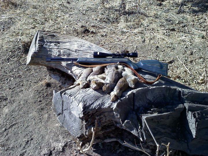

I have an extra Hw80.22 barrel that I had cut down to 13 " trying for a faster lock time. I choose 13" because that's the length of the barrel in my Hw97k in .20 caliber. Paul Watts tuned and the gun is a laser out to 50 years, pcp type accuracy. Proven hunter AC9aG5QuefF6I80ShH_YsK7718YxioKYJ5DKUlG4n8N1lJ1tyVN0ULI6p4suoC6LjJajRWKm6bkSBtH4s-XKyB-0AzlZaR...jpg Anyway my 80 is a great ground squirrel gun , but would like to make it easier to shoot. Hence shorter barrel, faster lock time.0917011431a_zps6riluraf.jpgWhy mess with good shooting gun? This gun has to be shot every day to get to a level needed to be efficient. Anything to make it easier.
