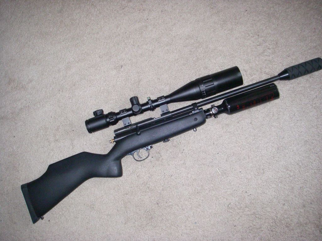

Yes - I have done it at least twice. And you are correct about the valve. Basically you raise the reg pressure so that you get a "quick" burst of high pressure as opposed to a longer burst of lower pressure air. I have a QB79 that I took 6" off the barrel. I put a 13ci bottle on the gun and cut the barrel so that the LDC is right after the bottle. Makes a nice short carbine. I'm away from home right now so can't take a pic. I have the reg set at 1400psi. The gun is shooting between 15 and 17 FPE depending on the pellet I use. This is in .177. It does not waste air and has a very quite "short" report with the attached LDC.
You would be amazed what you can get out of a short barrel. I have a BSA Ultra that has a barrel under 12". It is shooting very efficient at almost 30FPE.
Below is another QB79 that I built last year. It's just about the same length as the one I have now. (With the LDC it is still shorter then a stock QB with no LDC.
This one I regged at 1000psi and tuned it to shoot 12fpe.
