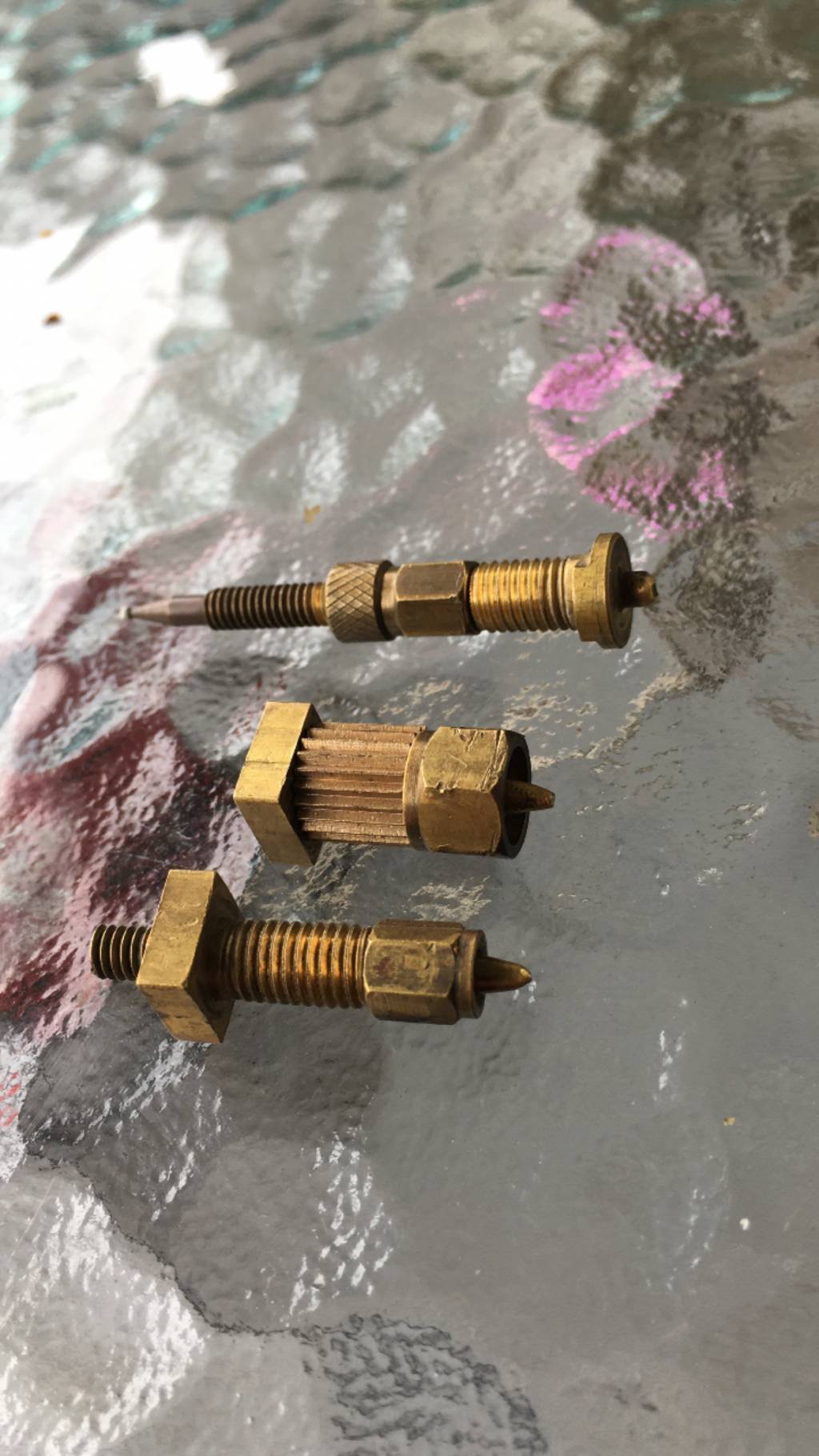

Modified old brass archery sights, or any brass pieces. You can use the flat nut as a stop against breech seal. You can play with depth of seating and see what works best for each gun, and pellet skirt thickness.
You get the idea.

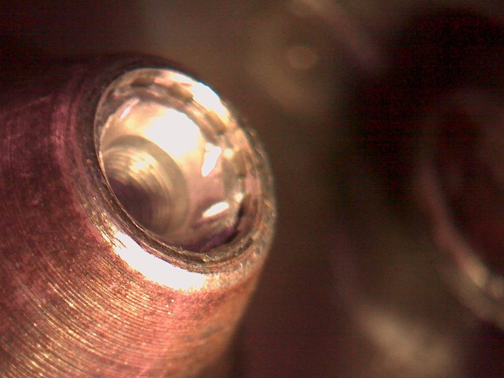

If you have a borescope you can look at lead in. I know barrels with a proper lead in still feel like there's a jump with Wadcutters.
Seat one, push back out with cleaning rod, and inspect.
Breech, Then finger tight, and lastly pressed in with tool until pellet "clicked" into place. As you can see there is only a very small tapered area and then the rifling. The way the pistol is made I have to use a right angle tool since very little space between breech and retracted piston. I cannot find my old beeman tool which looked like a ball on the end of an antenna. I believe the resistance is from the skirt engaging rifling and the "click" is the tool hitting breech. As picture shows the seated pellet still has some skirt in the tiny tapered part of the breech. To seat pellet fully into rifling I would need a right angle version of JamesD's tools. My pellets are marked and measure 4.50mm on the head with larger skirt. When I insert the head of the pellet into the muzzle of the pistol it seems to lightly engage the rifling.
