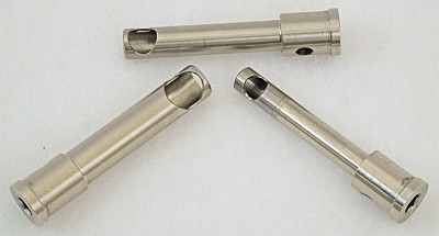

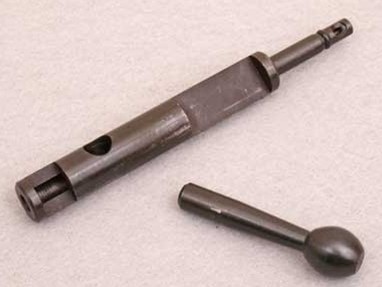

Just curious, what airguns actually do use a flow-through bolt?

Understandable that you may not have run across a flow-through bolt. They aren't nearly as common as pin probes but they can be found at both ends of the price spectrum.
From a $100 QB78:
To a $2000 FX Impact:
From a $100 QB78:
