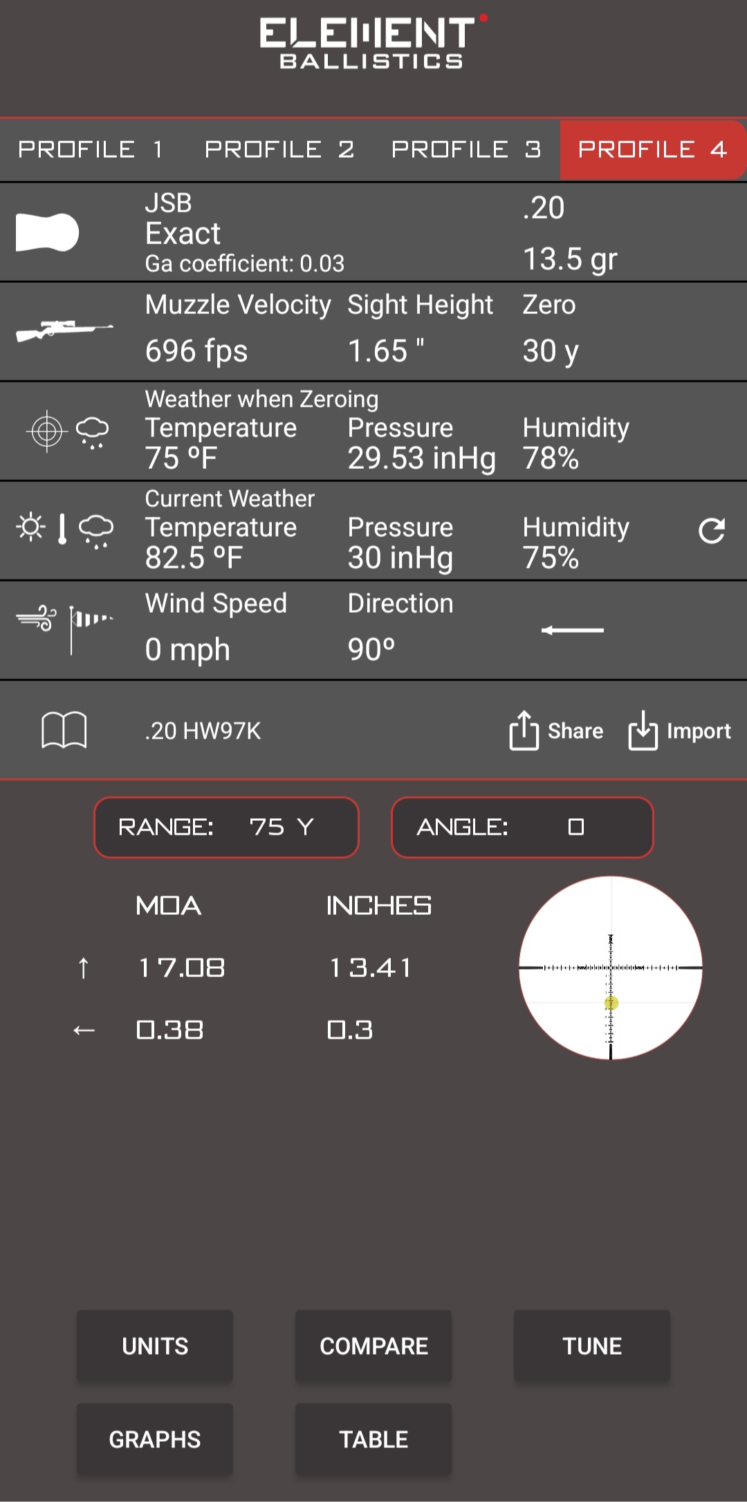

I haven't looked at them all, but the Element Optics, phone app calculates the BC by pellet manufacturer, weight, and caliber. Theres a list to pic your pellet from there.

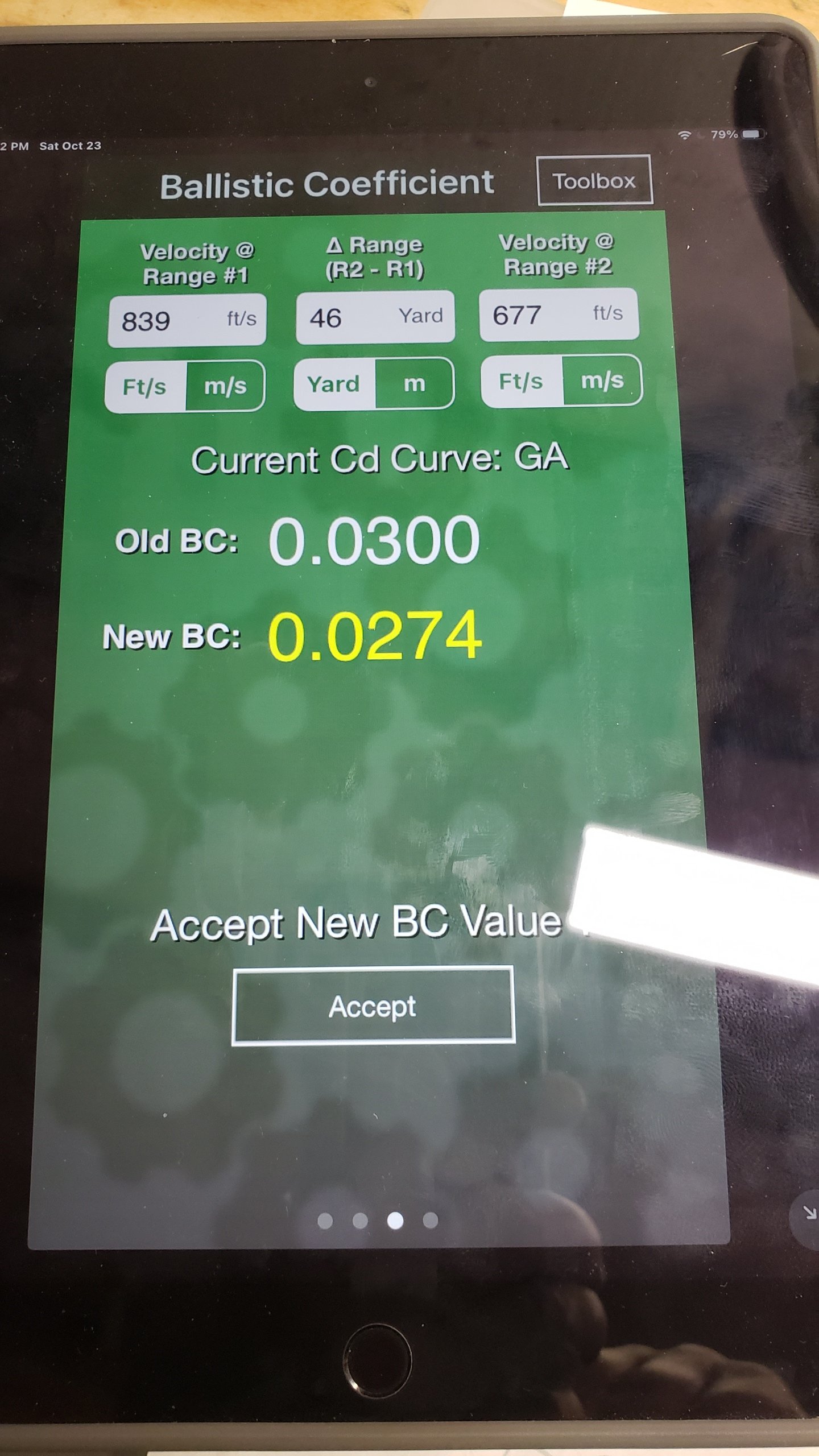

Also even factory specifications can be horribly wrong. H&N listed their 11gr 20 cal FTTs at 0.016 which is terrible. That's about the same as a 7gr 177. Out of concern I and another forum member set up two matching chronographs 46 yards apart and calculated the actual BC as 0.0274. That's worlds better than manufacturer advertised.
We also tested the 13.73 Exacts to be 0.0373 thats also higher than published. The test rifle was my R1
