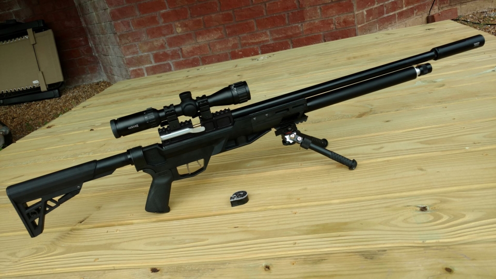

Franken-rod:

Nice build!

Nice build!

Nice build!
Wow, very nice!!
Thank you. The modified Armada stock reduced weight by 8 oz,, the aluminum tube 23 oz, and the shorter shroud almost a half ounce. The shorter shroud still holds two baffles. Of course the moderator adds some back into the rig. But I can take the moderator off to hunt when sound is not a major concern.

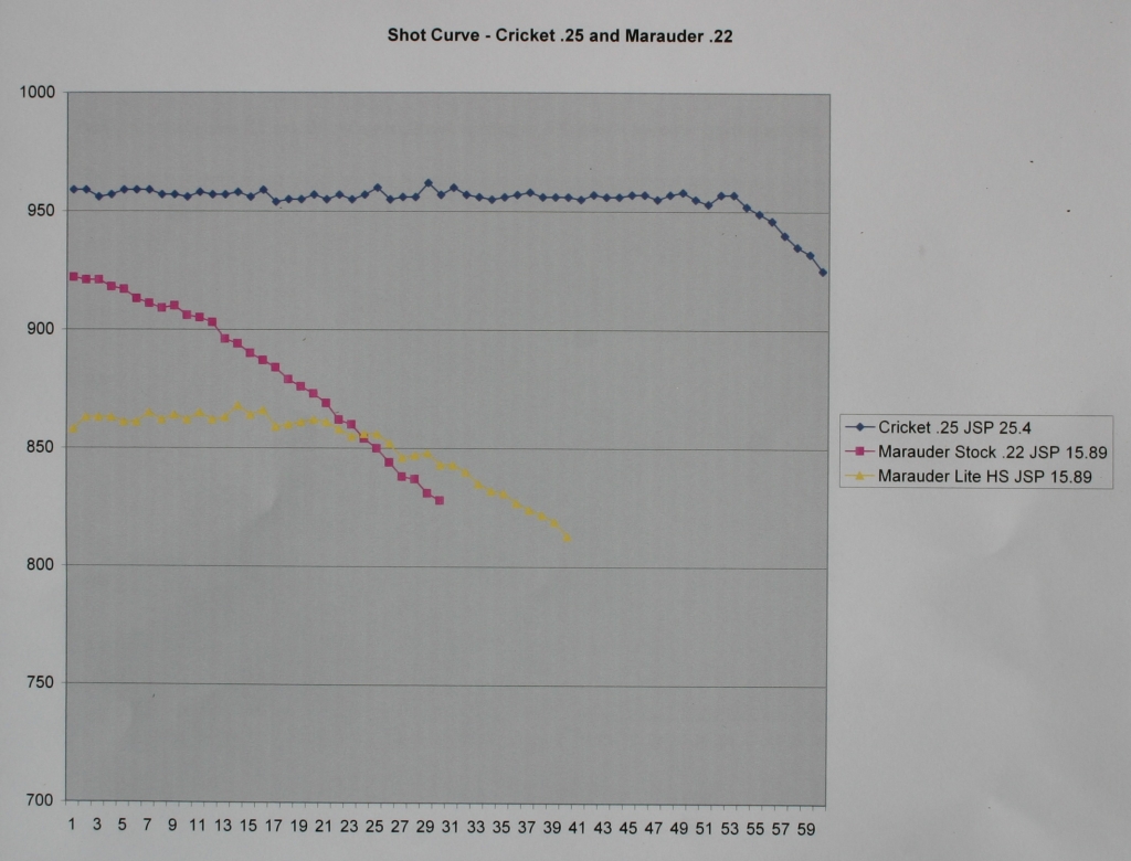

I put wheel bearing grease in a Marauder I had once. The bolt kept getting hard to cock. Un-cockable.
Took it apart several times. No lube worked very long for me.
So I lightened the HS a little and put Disc Brake grease in it. Never had a problem after that. Sold it that way.
I'm not recommending this. Just what I did. The chart below shows the effect it had on the shot string.
Right or wrong, it made that gun shoot better for me.....
