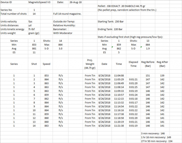

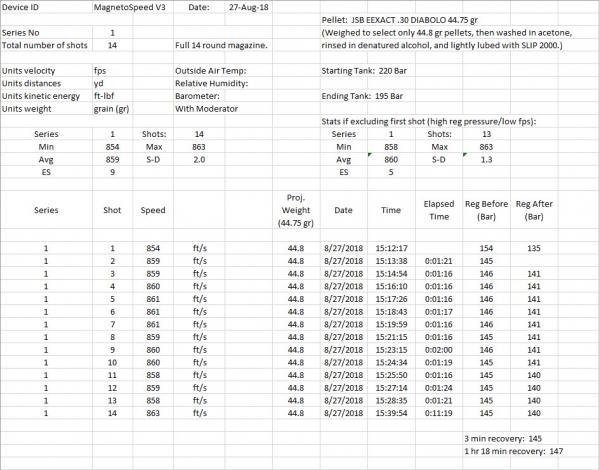

I'm very new to airguns, and I'm working right now to tune and characterize my first airgun. It's an FX Impact X in .30. Kind of intimidating at first, and some will say it's not what should be your first airgun, but since I came over from competitive Bullseye Pistol where I did my own load development for competition, I gambled that I wasn't biting off more than I could chew. I find the concept/process the same, but the mechanics different. It takes a lot of time and testing to characterize a particular gun and a particular projectile and the load specifics propelling it. I've always looked at target accuracy as a shooting system. Typically, over a reasonable sampling size, the more variability in that system, the bigger the group size. You set your core components and major adjustments as close as you can, and that gets you most of the way. After that, I think it's finding and reducing the variability of the system's various components that hones it in and continues the group size reductions, even though the reductions are much smaller.
System variability is always additive, and generally speaking, more total variability means bigger group size. I think the people we see doing amazing things with their air rifles, and getting amazing groups are the people who have sought out the places where extra variability can be removed from their shooting system. I think washing an weighing pellets is one of those things. There seems to be a couple camps on doing it. At least on paper after testing, it reduces system variability. I can prove that. Is that proof significant? Don't know. I haven't tested it in the real world yet by shooting the groups at distance. I've only tested muzzle velocity. But, muzzle velocity is a component in our shooting system that directly affects where our pellets impact the target. I can show data to state that in my gun, with the pellets I'm testing, by washing, weighing and lubing them, I can reduce the standard deviation of my velocity from 1.9 fps to 1.3 fps. Is that significant? Again, I don't know, but I can't think of any situations where a smaller SD will worsen anything in my shooting system.
If I was to make a speculation, I would say the lion's share of this variability reduction comes from the weighing of the pellets, since my tin of 44.75 gr pellets had a huge range of weights in it. I didn't write it down, but I know I saw pellets from 44.3 gr up to 45.5 gr.
For those interested, here are pics of the data sets. Just remember this is for a pretty small sample size (13 shots), and may not be big enough to present an accurate picture, but I think it's a good illustration:
1535416691_14749932565b849973384446.75038350_Pellets Weighed Washed And Lubed.jpg

Well I am not either an expert, but I would believe a most would regard a ES difference from 1,9 fps to 1,3 fps insignificant. But I would guess the most important thing is if the accuracy improve or not, with shooting from the tin, or going true the process you describe. And you would know, as it after all is your gun and test:)
Edit: Did not read it right, see ES is 5 on both (exluding the first shoot)
Yeah, it's slightly more significant when you're talking SD vs ES, but I know what you're getting at. It's very possible that the improvement gained solely by prepping the pellets in my case is not significant. Visible improvement on paper in the form of numbers doesn't always translate to visible improvement on paper in the form of smaller groups. However, if you do two or three different things that provide this small amount of an improvement, it might show up in smaller group size. I was more trying to explain an approach to improving total result with variability reduction. It all comes down to how much improvement vs how much time it requires, and your own sense of worth when evaluating that improvement. However, I do think the people who consistently get slightly better results than most people are consistently paying slightly more attention to little details than most people.
