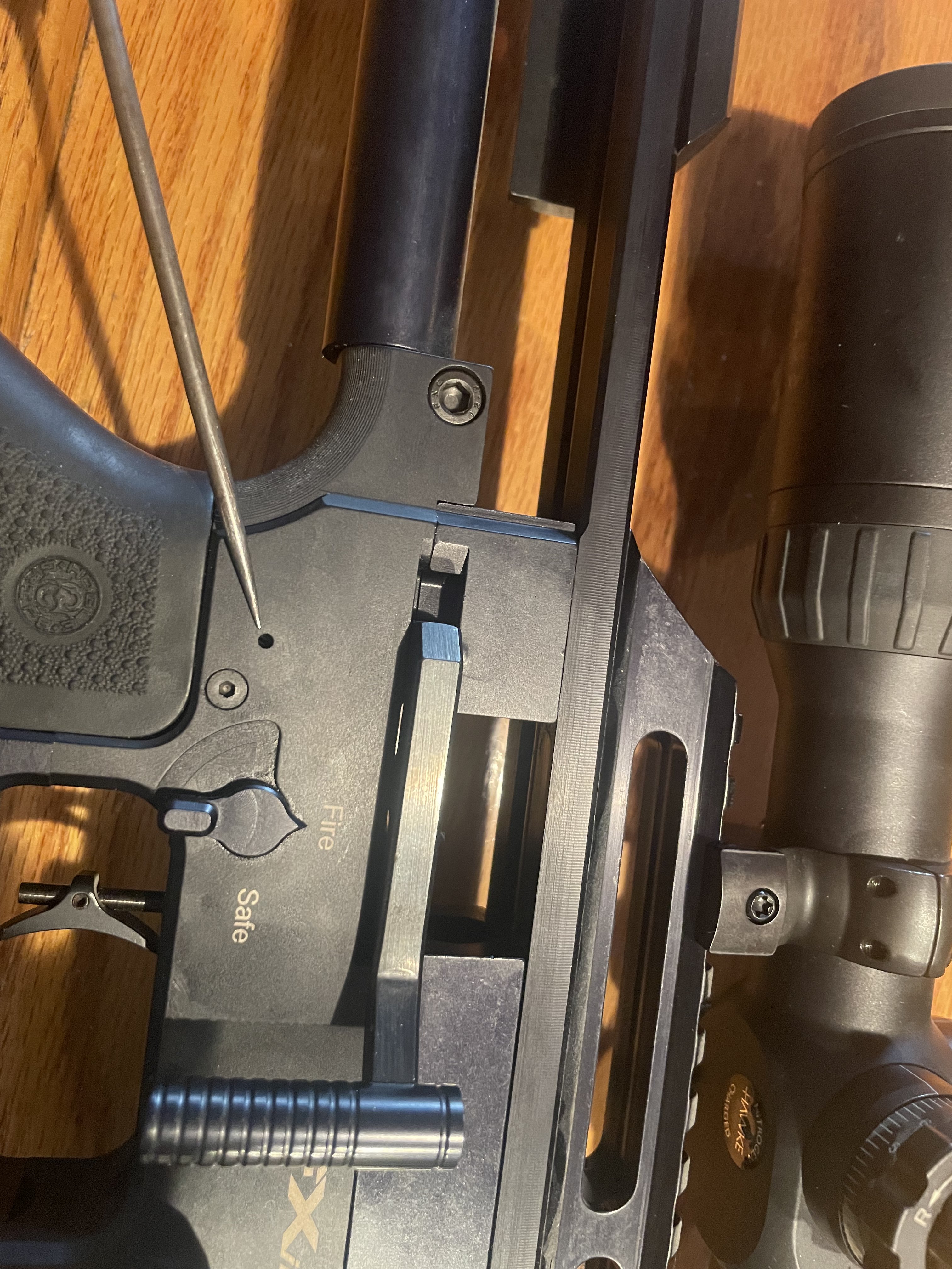

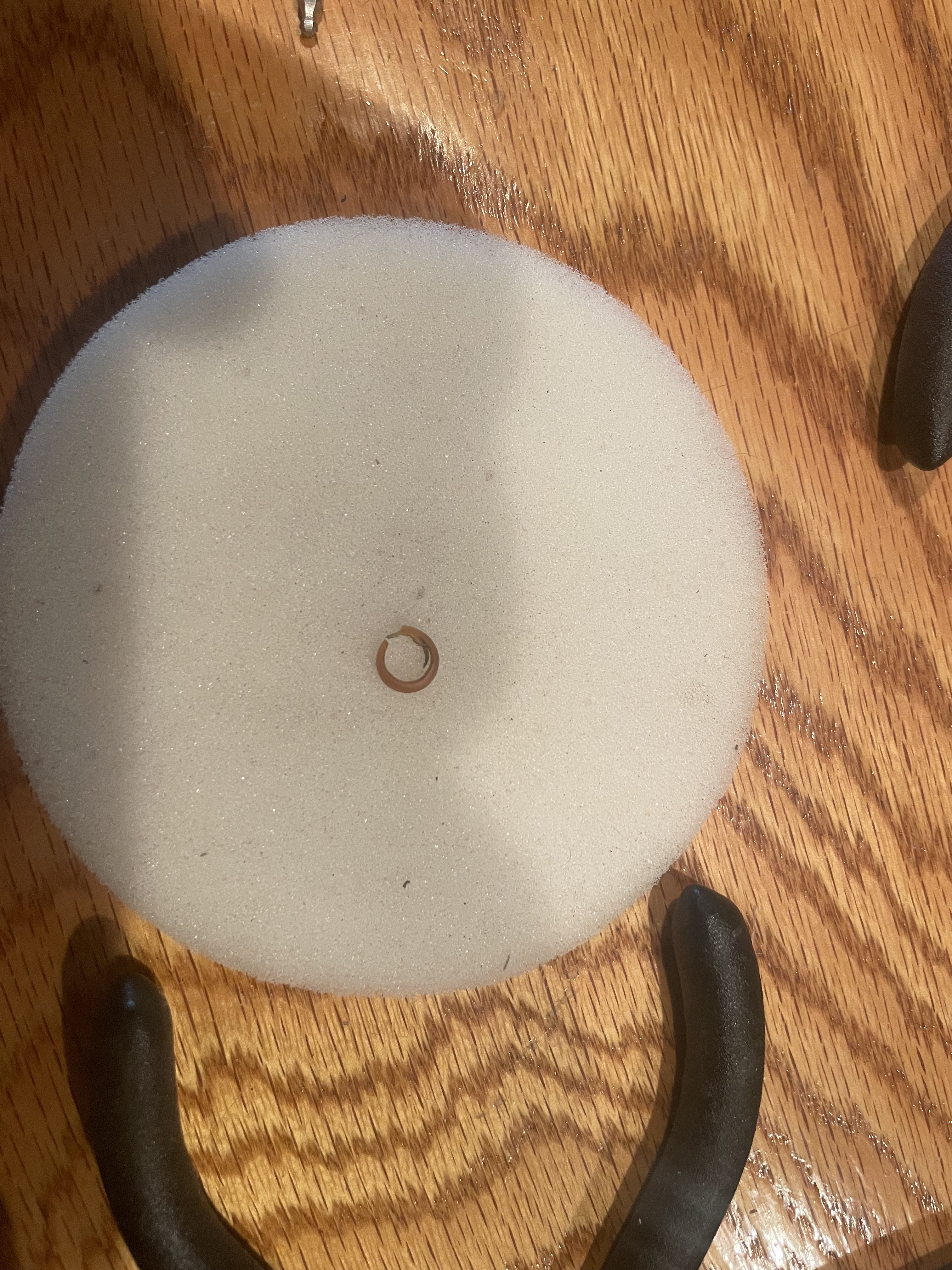

Hay guys haven't been here in a while. I have a OG impact. I was out shooting yesterday and POP!!!!! Air starts leaking out the side hole (by the safety) I have shot tens of thousands of rounds with not any real problems. I thought it might something wrong with the reg went to remove the trigger and there was a little Bushing inside where the trigger catches the hammer hold. Do you have any idea where it came from? It seams to be a darrilon bushing. not an o ring. Here is a pic. Thanks in advance..

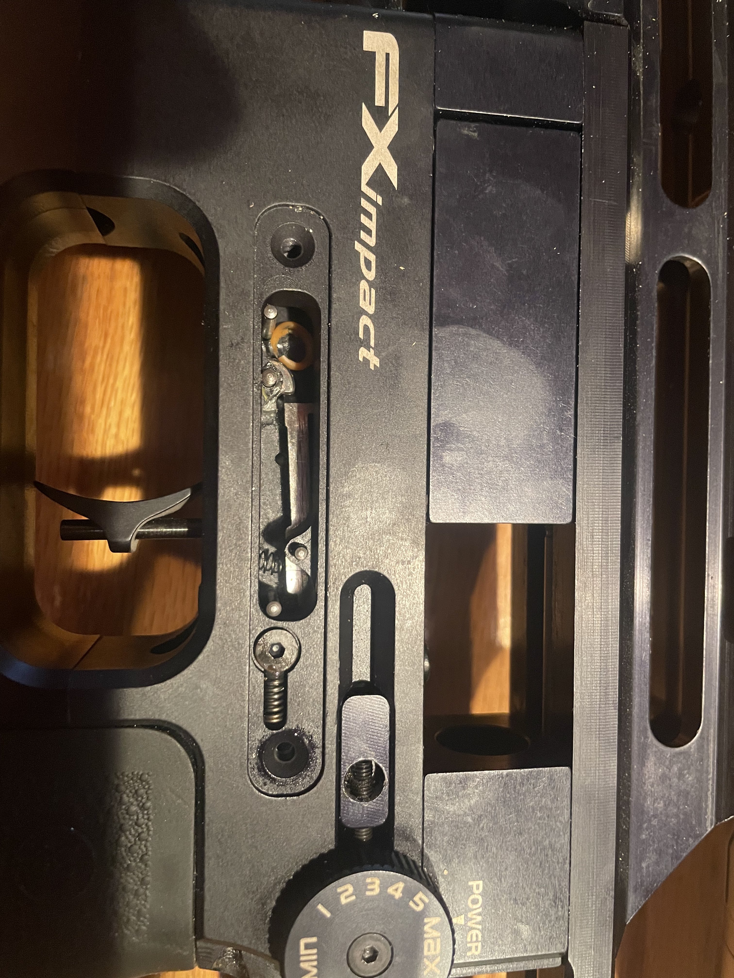

The reg was all together. I did take it apart nothing seamed to be wrong there. This bushing was sitting under the trigger plate.cover. had to come from above where the hammer is???? I have been poring over the exploded view o FX's web page I just don't see it.....Tough to get a new one when I don't know where ti came from. here is where it was sitting when I opened it up.
Ok think I getting to the bottom of some of my troubles. Here is what I got so far that bushing is on the the valve rod in front of the hammer The entire front of the valve rod came unscrewed and buggered the adjuster body (not the cap) still need the new darrilon bushing. I should have never took the reg apart now that is leaking....LOL never did before. but I am on the right track, where is the best place to find the parts? I bought the gun Used on here in 2017. So I am open to any suggestions. Might as well get rid of the crapy OG FX gages. and an entire o ring kit. Thoughts????
