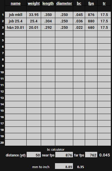

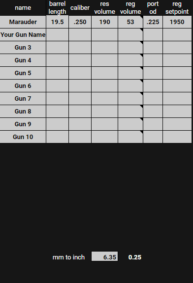

The simple mobile version includes:
  • max fps based on gun/ammo parameters
  • efficiency calculation (fpe/ci, and other air usage data including thermal efficiency)
  • pressure gradient for tune and plateau
  • comparison charts for changes in a single gun parameter (plenum size, barrel length, port od, pressure, caliber)
  • trajectory calculation along with some additional trajectory data (currently done in MIL only, no plans on supporting moa)
  • bc calculator from far/near velocity and distance between two
Here are this versions pictures and link to make your own copy (be advised, on edited copies you can edit formulas/fields that will change how the sheet works, I made the lay out pretty self explanatory as to what fields to edit and which to leave.)
View attachment 1584842705_6079582645e76c7d1a96c26.35742214.jpg View attachment 1584842711_1066357835e76c7d7a75469.26696610.jpg View attachment 1584842723_325979285e76c7e381b138.03037681.jpg View attachment 1584842737_11312755755e76c7f15866c8.72127619.jpg

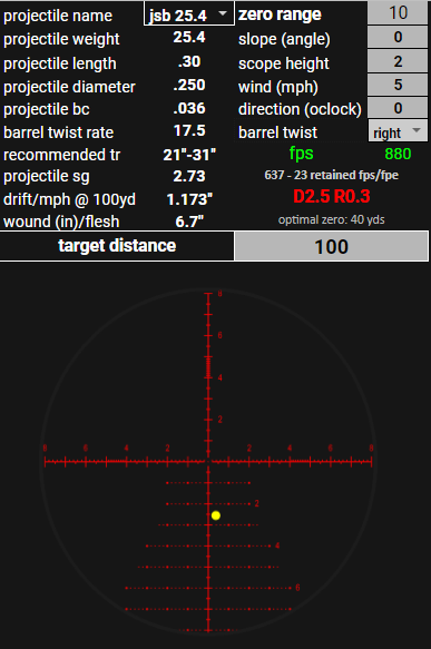

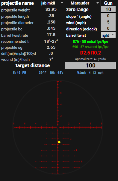

Small update. Changed a few things around with the GUI, and added the ability to retrieve local weather data for wind/temp! Screenshot below of changes. Same link as in original post as any update I make will apply to that sheet, you just need to make a new copy and copy your data over which should be super easy with a copy+paste of your gun or ammo data.
*Once your State/City data is entered ( on the GunDB sheet ) , the spreadsheet will update every 10 minutes* Currently only set to work for US states as I am too lazy to code for international atm, but later I likely will!

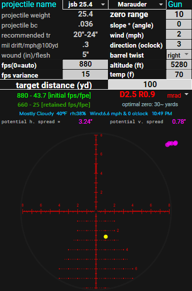

v1.33
Change:
Added fps variance + spread visual on external ballistic sheet. Added temp/altitude variables, and a few other minor UI changes that got rid of what I found unnecessary back end data in exchange for more important shooter data (vertical and horizontal spread)
