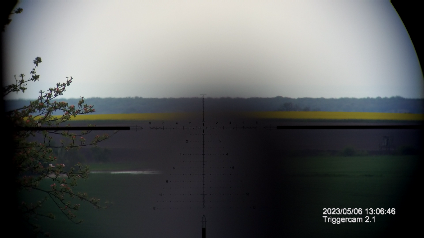

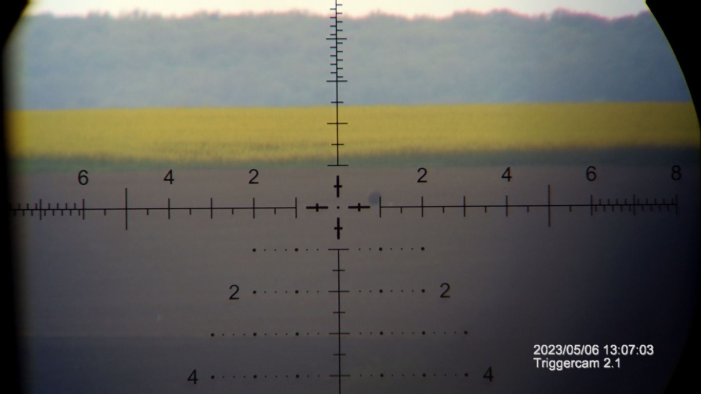

thank you all for your kind words, it's been a really long journey. At these distances, every +100 yards means a significant increase in difficulty, so even if only +377 yards were added to the original record, the difficulty has increased by much more than just the ratio between 1400 and 1777 yards.
the periscope is raised a lot, but the image of the barrel/silencer already extends into the area of the reticle, as can be seen here in the photo.
If you zoom in as much as possible (24zoom, this is a black larger target than was used on the record), you can usually see through well. Unfortunately, the scopecam video for the record is of poorer quality, as I was moved by the placement of the TriggerCam
236 bar -3422PSI was the outlet pressure from the regulator to the valve chamber. 144J - 108FPE was muzzle velocity ( at the end of the barrel ) and 33J- 25FPE on the target.

This is not any world record, but it is my personal record for longest hits string over 400m for a reasonable target size relative to the distance . I believe that it will also work for a target of around 1.5 MOA, as this was shot only after the first 15 shots after cleaning the barrel (that is, between 15-30 shots after cleaning the barrel) and you can see in the video how I first adjust a few click on the riflescope on beginning and then I correct the drop by using a hold over.
I made these corrections not only based on the fact that I hit the target below (when hitting this type of target below, it will swing more, as can be seen in the first couple of shots), but also based on the immediate measurement via the garmin chronograph. Record of this MV can be seen in the photo below, including marking the section in the graph in which the video was shot.
