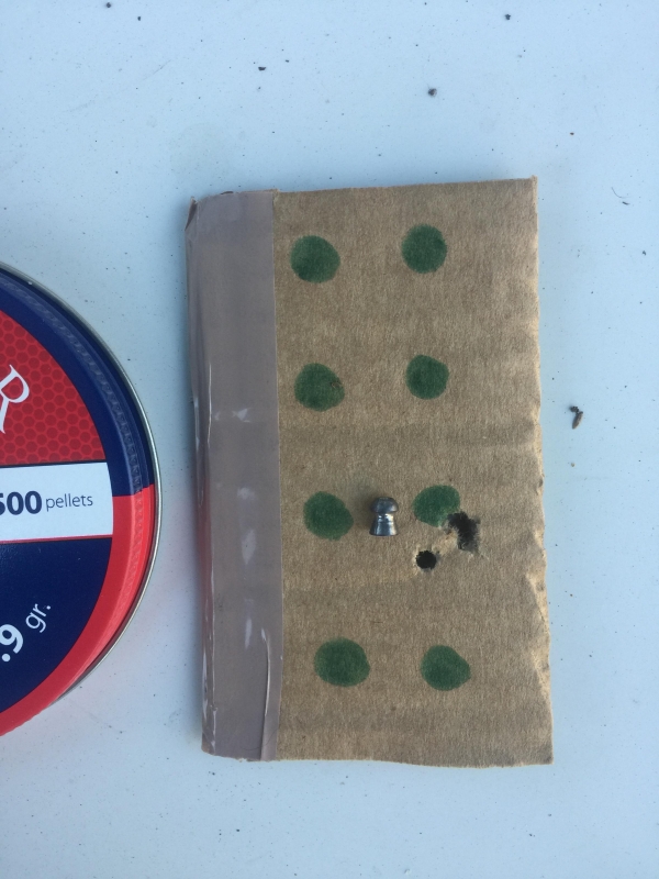

So after multiple shooting sessions I have some very pleasing results to share. I have a top dollar call girl now in this tx, and she absolutely loves $.99 cheese burgers. Of all pellets tested, and I tested a lot, it appears the crossman hollow points 7.9 grains from Walmart are the pellet of choice. I was very impressed with the performance of the 7.87 jsb’s, then on a whim I tried the crossmans. They are shooting at 10.6 fpe. Very very accurate. I’ll try to post some groups today after work for you guys. Yes Spysir, that’s the extension. I used that extension with the full pg2 12fpe kit. Davemac, I think the seal is relatively the same size, however there is a machined aluminum bit that you fasten into place in replace of the factory seal.
First 5 shot group fired when I got home. Walked through the door, grabbed the TX, put some dots on some cardboard and fired 5 rounds. I apologize for that flier. I knew when I pressed it in the breach it might fly astray. Went in pretty loose. These are unsorted straight from Wally World. 25 yards. Front was setting on my hand which was resting on a bag.
