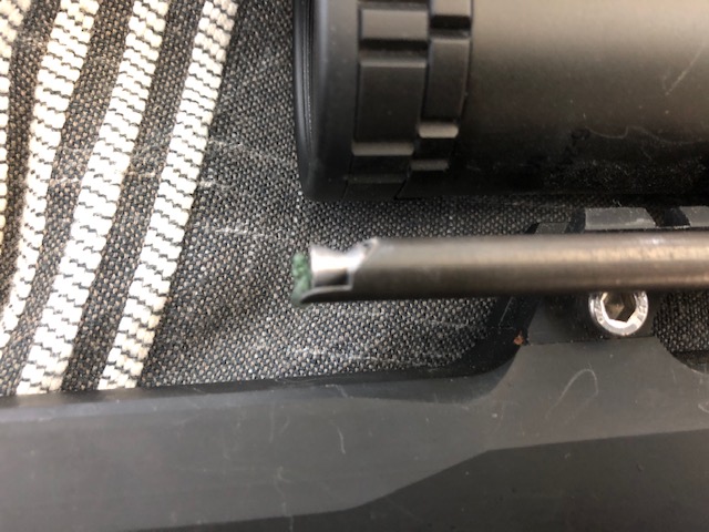

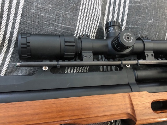

Check out this updated tubular magazine I made for my Edgun. I used a carbon arrow and cut it to the desired length. Then trimmed the feeder end with a dremel tool. I think you can see it in the picture. I cut the top 2/3 at an angle then a level section for the bottom 1/3. I used a mono filament line knot as a pellet stop. So to get a pellet I point the gun up, put my thumb on top of the pellet skirt, then I pull back and down. That pulls the pellet head back enough to clear the top of the tube and it then pops up for easy removal. Works like a charm. A few zip ties lock it in place. I put enough pellets in it for a full use of the air in the gun. When I run out of air I need pellets. Cost about $2.00. Free if you have a spare carbon arrow with an inside diameter of greater than .22 or .25. There are lots of arrows out there so try to find one that is as close to the needed diameter as possible. Good luck.
