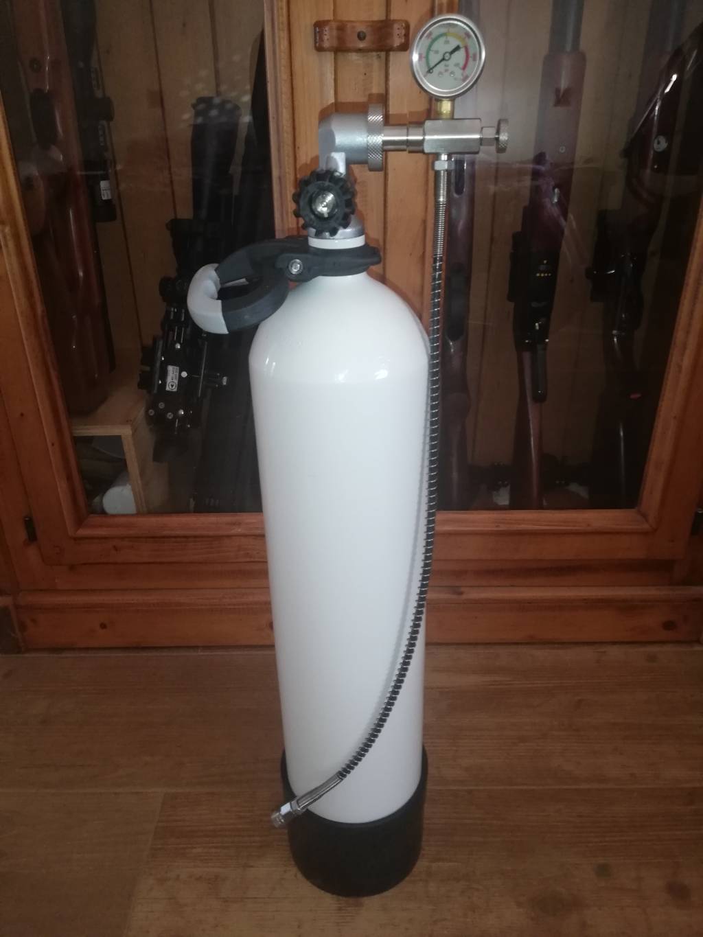

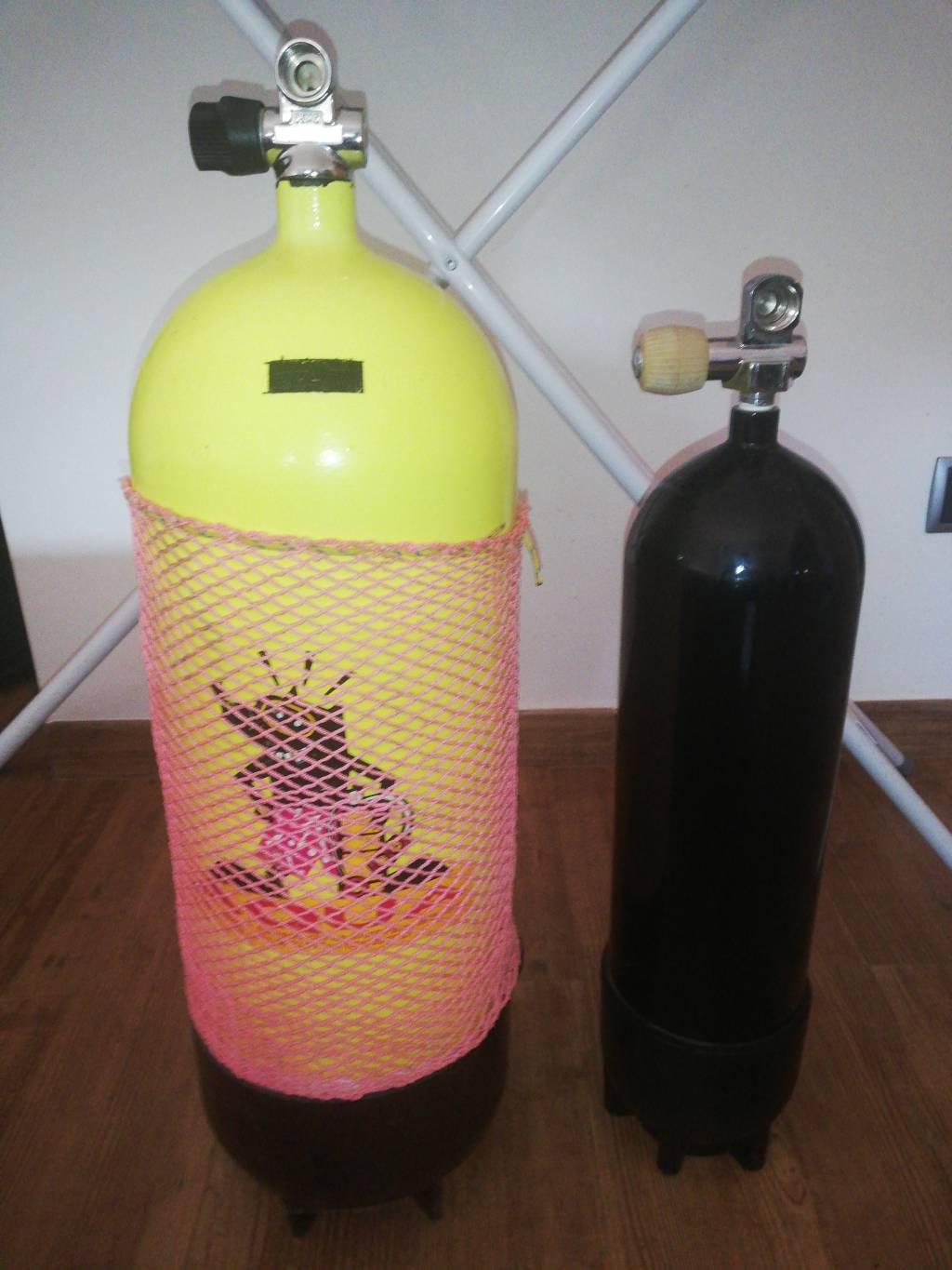

After years with my tanks expired and nervous every time I recharge them
I decided to buy a new equipment, a 7L 300bar bottle made in the Czech Republic with CE certificate

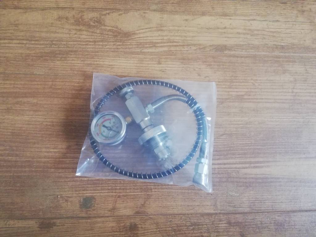

I also bought a new Chinese charging station from Aliexpress recommended in another forum, the truth is that I am amazed by the quality and the low cost all in stainless steel and gauge with glycerin

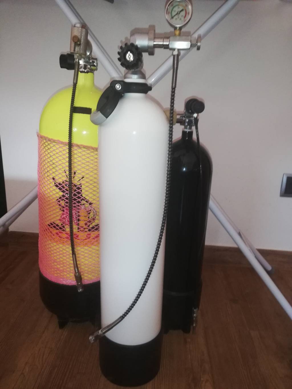

All equipment complete bottle with lower rubber support, neck handle for transport and charging station placed at the door of the house 230 € / 270 $

BTW, your fill adapter from Aliexpress is decent for the price, but their gauges are notoriously inaccurate. Do compare your readings to another gauge that you know is reliable. I got one and had to replace the gauge which was reading 400 psi or 28 bar lower than the actual pressure.

If the gauges are always inaccurate the same as those of $ 2,000 airguns but I never fill my airguns to the maximum and with an approximate estimate is enough
