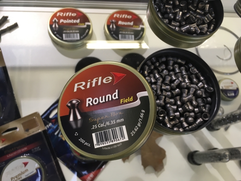

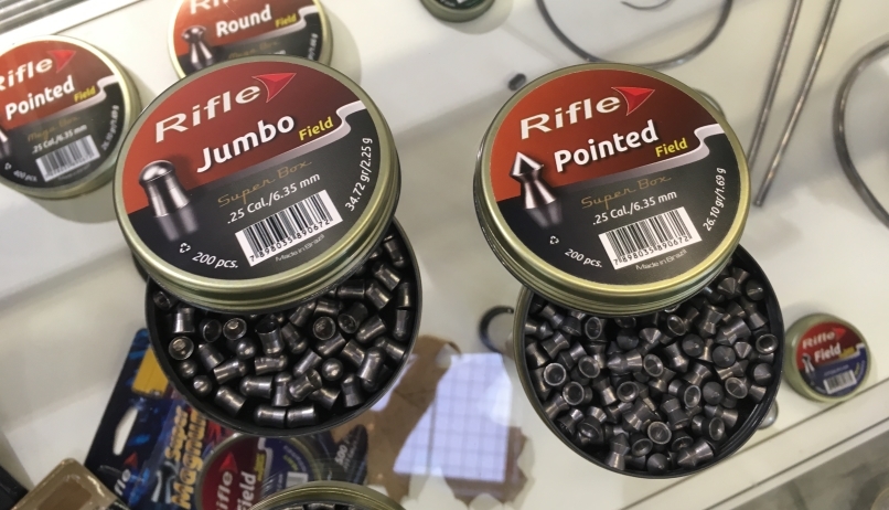

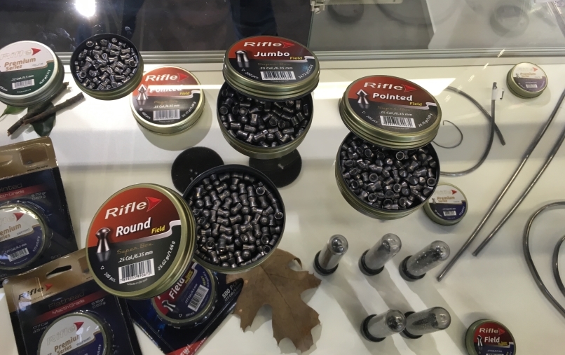

The topic title might look a little misleading but the company is actually called Rifle. They're are a company with produces lead wire and airgun pellets. We've found the company at a stand at the IWA and started talking to them. One of the reasons that we were interested is because we were looking for an alternative to JSB (being dependent one solely one company for great pellets isn't what we like and want :) ).
This was the flyer of their company:
and some close ups of their pellets:

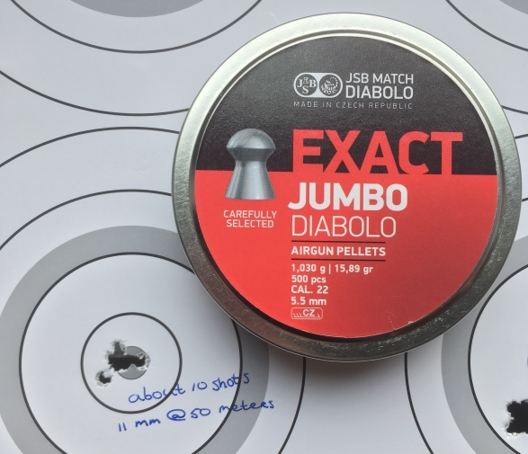

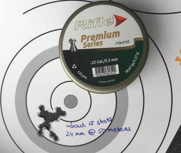

Of course pellets are useless if they don't fly so we asked for test samples and received them. The available samples were in .177 and .22, .25 is in the pipeline so they'll be coming out soon I guess. Yesterday I was able to do a test with two types of their pellets. First a pilot group was shot with the current best performing pellet in my Steyr LG110 High Power Hunting in .22 and after that the Rifle pellets:
The JSB Jumbo Exacts were shot at about 280 m/s and the other two at around 270 m/s (which came out best during a rough test). I think the conclusion is pretty clear, they have a pellet that is capable of producing really good groups!
I've already send some feedback to these guys about the premium pellets and they are looking into it now so it can be expected that the results will become better over time :)
