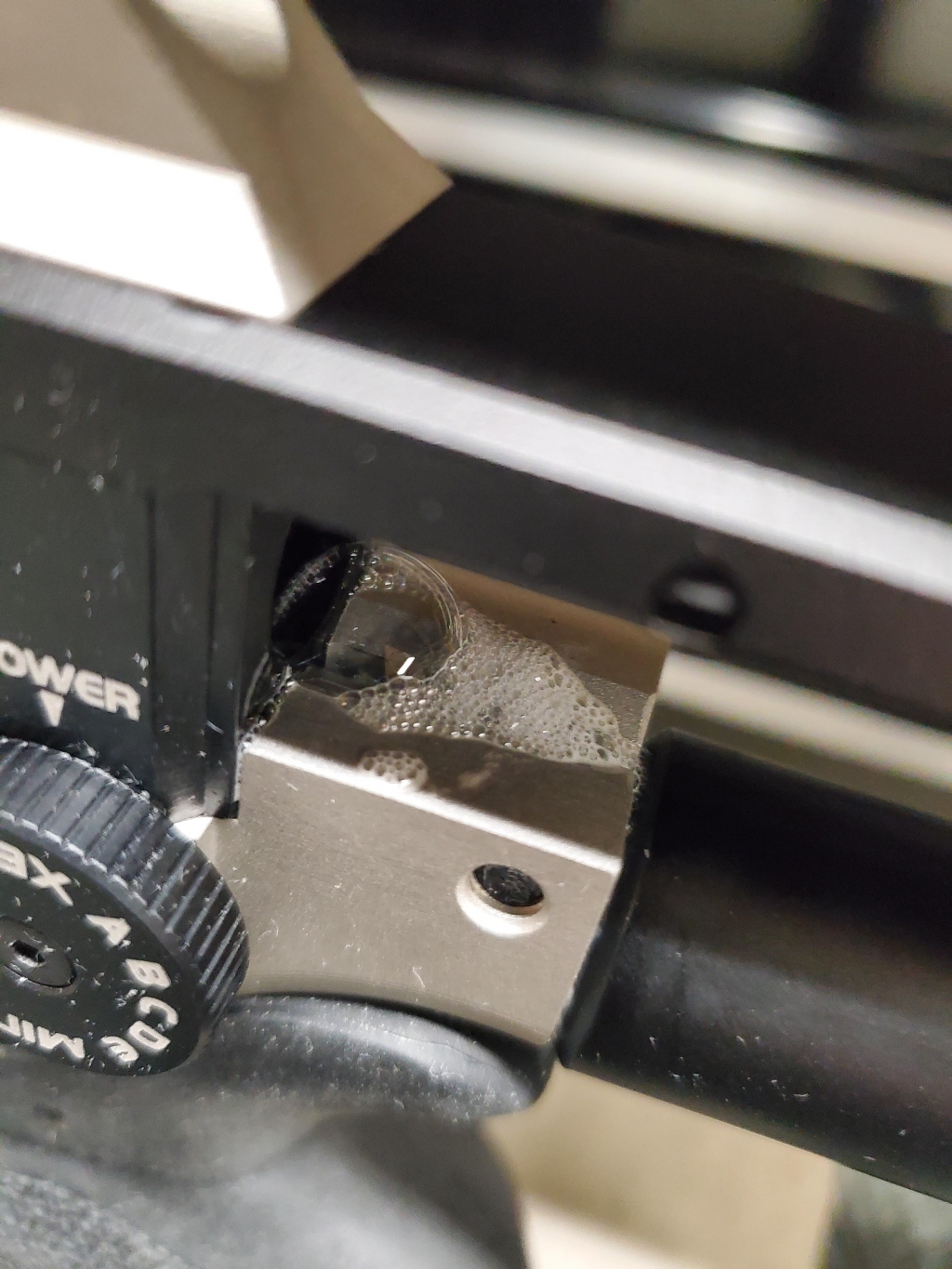

I just got my new FX Impact MK2 and it had a air leak when I received it. I finally found out where it was leaking, where the regulator is clamped into the receiver.
I sent a email into FX USA about it but thought I would ask here. I would rather fix it myself than to send it in, but I haven't been able to find a good video on how to fix it. Anyone have tips or a link to a video? Thanks.

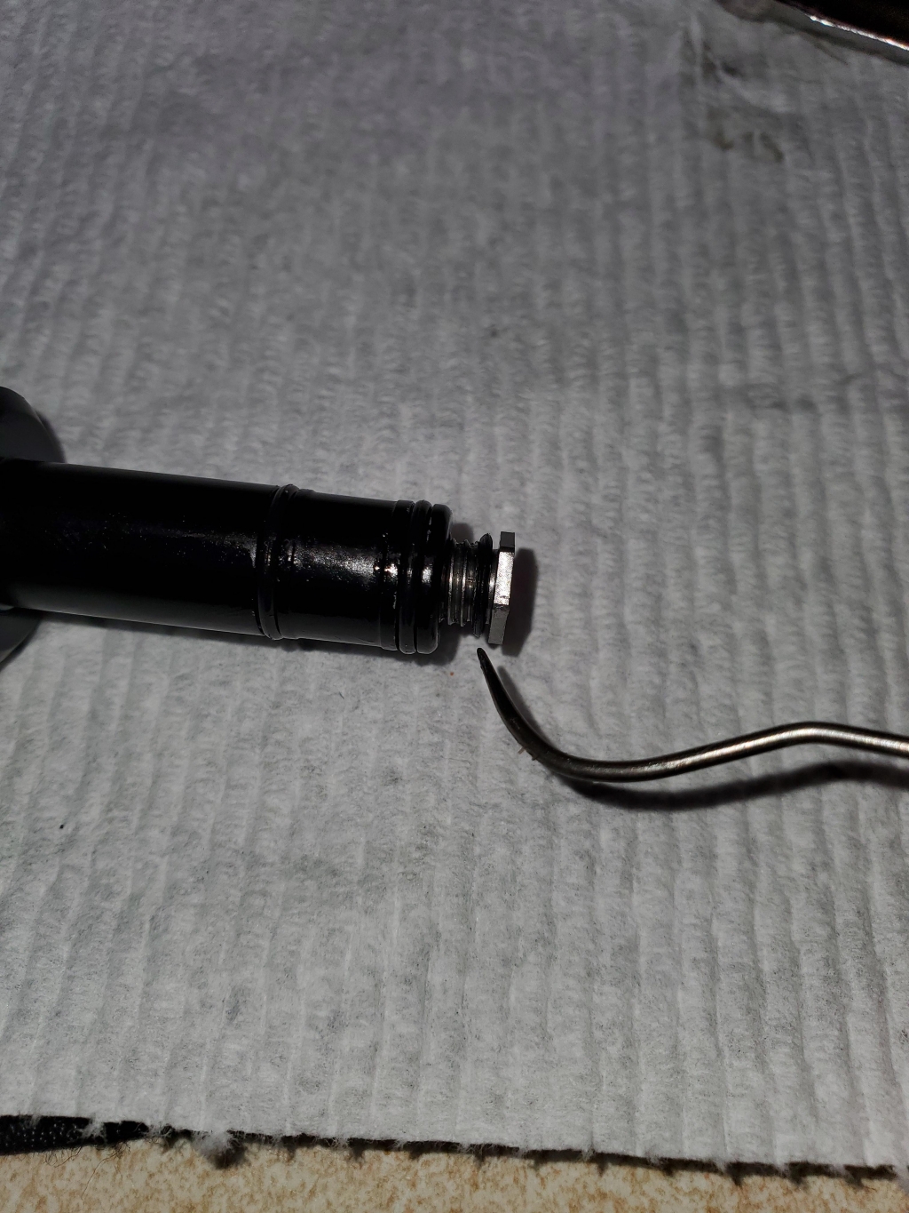

Ok I got the gun apart, I saw those videos before but wasn't sure I wanted to tackle it. Now I need a little more help. The one oring that looks bad I dont think I have to replace it. Can anyone tell me what size this one is?
It is the one that the 8mm bolt goes thru. The other 2 in the picture didnt look bad but I took them off, cleaned it up and put new ones on it.
I found out the oring that I needed was a 6mmx1mm. I found one in some of the oring packs I had from some airguns. I got the gun back together without any problems. I tested it for leaks over night and it held air great, no leaks. I got to put some round thru it and it is shooting great again.
I have no idea why you have an oring there on your gun. There was not one on my original MK1, and there is not one on the upgraded valvetube im running now. Also, it´s not on any diagrams i have ever seen. "Secret MK2 option" ?
I also fail too see what function it could have as the large oring/xring inside the tube does the sealing on the inside ???
