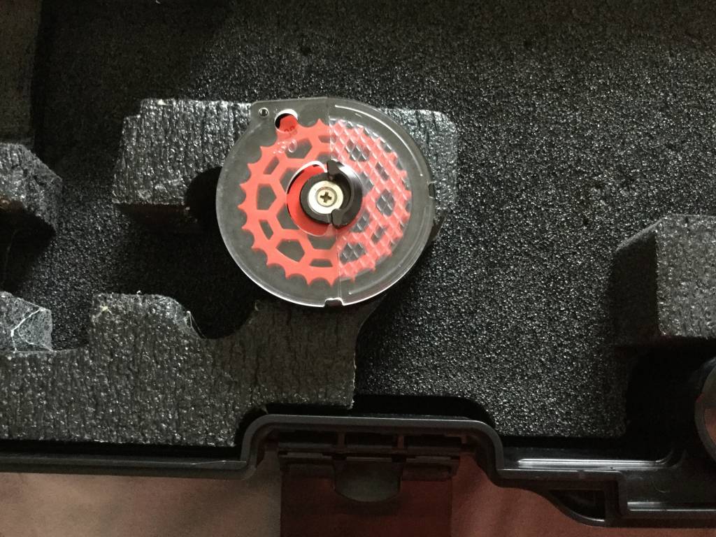

I have been having issues with FX hybrids laying down sideways using the plastic side-shot magazine that came with my Impact.. I don't know if I received a bad magazine or not, but I have seen others reporting the same issue and others saying they have not had issues, Maybe there was just a bad batch of them. I haven't found where FX has addressed this issue in the forums, or anywhere else. I have been having to hand feed the slugs because of this.

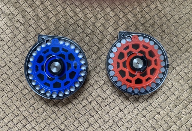

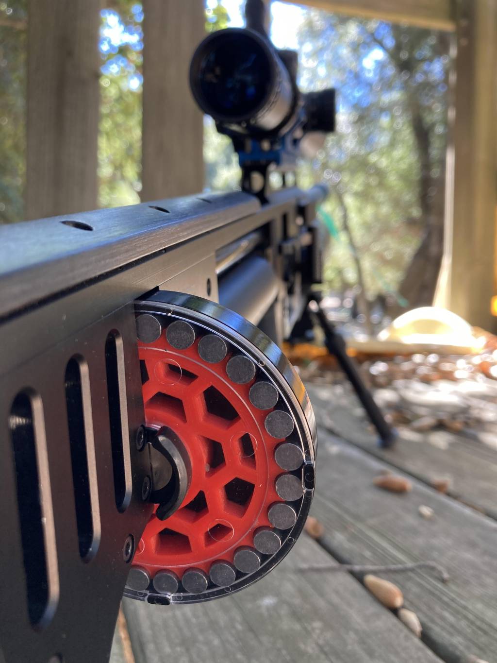

Well not anymore thanks to one of our members here on AGN !!! Orion is the member (Sorry, I don't know his name). I saw him post in the classifieds here an insert he was making that matched the original metal Side-Shot magazines that didn't have this issue. This has resolved my issues when using FX slugs.
I didn't want to say anything about this new insert until I ran it through its paces. Well, I have done that now and am letting others know that there is a rainbow at the end finally thanks to Orion. This new insert is also plastic, but is well made. I also tested it with JSB MKIIs and had no issues with pellets.
The only digs to talk about is the fact that it drops the total count by two. 28 shots down to 26. in .25 cal. No loss in shot count on the .30 cal. The other minor one is that this insert doesn't work so well now with my FieldPro speed loaders, but still kinda does, too. I believe there is a speed loader for the metal mags that would completely resolve this.
I am very pleased with this low cost insert that saved me a bunch of coin over gambling on buying another plastic FX Side-shot magazine. Thank you Orion!

@triggertreat I'm really happy the replacement part is working well buddy! Yes I have friends that are really frustrated that they couldn't use their magazines to shoot slugs when they bought the entire setup to build a slug gun. It's something that I really don't understand how it happened. I'll be frustrated too I just don't have an FX but what I have is a 3d printer :)
The online store is up but I don't know if it's against the AGN rules to publish the URL here, if you send me a private message I can send you the link if you are interested. I'll contact Michael to ask if I can add the link to the product on this post.
And yes, FieldPro will have the speed loader with 26 shots that will work with this new feeder.

There also is a guy in europe making similiar inserts https://www.oh-snap.dk/vare/magfx/, which work great. I agree the original high capacity magazines for the impact is not good for slugs. They might work for long slugs (have not tested), but shorter medium weight ones will easy flip sideways. The reason is that the cups which feed the slugs are to narrow, and doeas not give enough support on the side on the pellet/slug. They are probably designed that way, to give room for more shots. With custom made inserts, the cups are spaced further apart, and encase the pellet/slug all the way to the side, holding them in place while feeding. Loosing some shots is well worth the benefit of having precise feeding.

Specially on the .25 cal they went greedy and added too many shots there, 28 shots don’t fit well, when I tried, the circle for the pellet overlaps with the next circle and that reduce the size of all circles, even 27 was not perfect, with my insert in 25 you will have 26 shots but should work perfect, and if not working perfect just contact me and I’ll take care, I’m not perfect and errors can happen but I’ll always be there to make it right.
