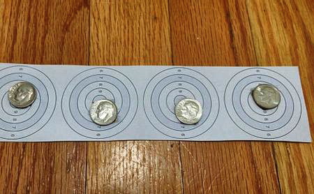

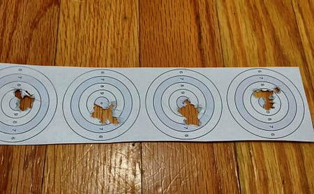

7 years ago on 02/25/2014 (pics are time stamped) I shot the following four, 10 shot groups back to back from my first pcp ever, an FX Royale 500 at 50 yards, no wind. 40 shots, no flyers. I had no other experience with PCP's just thought that is how PCP's were. I sold the Royale 500 to try other guns and could never get that level of consistency again from many other makes and models including other FX's. Back then (before AGN existed 😲) I didn't know what "harmonic tuning" was (I don't think many did) and I just didn't know how lucky I was to get that kind of a "tune" out of the box. Only, 7 years later...............

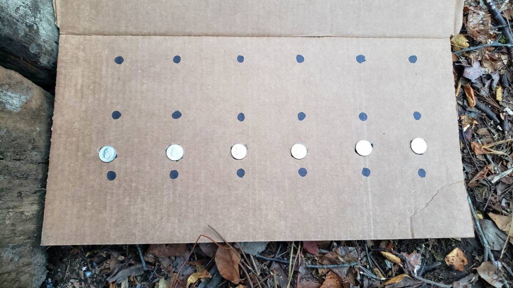

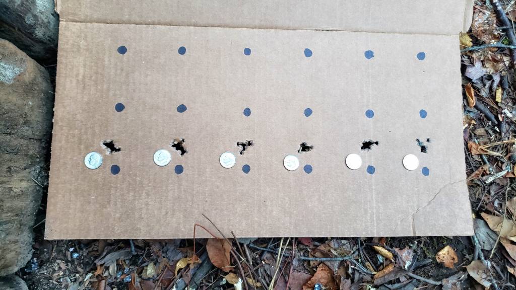

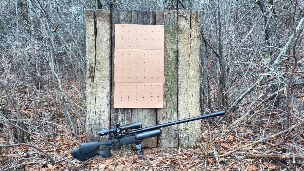

After about 2 weeks and well over a thousand shots of beginner tuning with the Crown, these six, 10 shot groups, were shot back to back this morning with:
JSB Kings 25 grainw - no wind - 50 yards from the muzzle - 700mm barrel - 900 fps - 120 bar reg pressure
Over the last several days I have only been trying to replicate the results of my first Royale 500 from so long ago and I feel like I'm pretty much there.
I'm pretty proud of these results and quite frankly I don't think I could do any better even if the gun could.

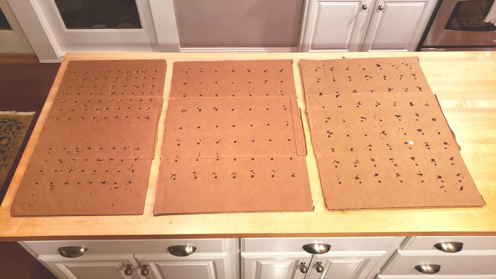

Here are the three previous target cards I shot trying to get the Crown dialed in.

Cliff, I'm duly impressed. ⭐
When I get to where you are now, maybe I have some advice.
But for now, I only have applause. 😊
Matthias
Thank you Matthias, it only took me 7 years and many guns to get back to groups like this 😉

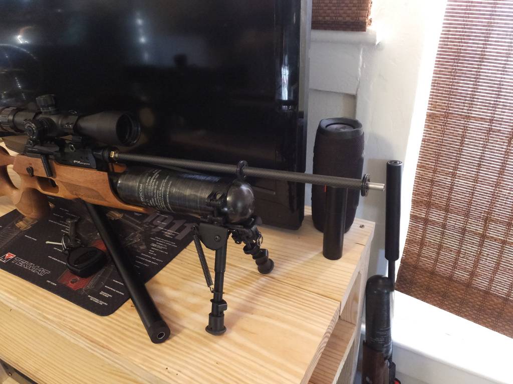

Search for Earnest Rowes custom shop. The tubes are a specific size he has made up. They're not a generic size. They don't cost much. I just slathered epoxy on mine, and worked it slowly in under the full length of the tube. You can see I cut mine. I think having the one space at the muzzle is possibly all that is needed? But I felt more comfortable doing it like this. Eventually the middle support will fatigue and fail. And I will not be able to replace it, lol. But I left a little off the end because I don't think it's necessary.
