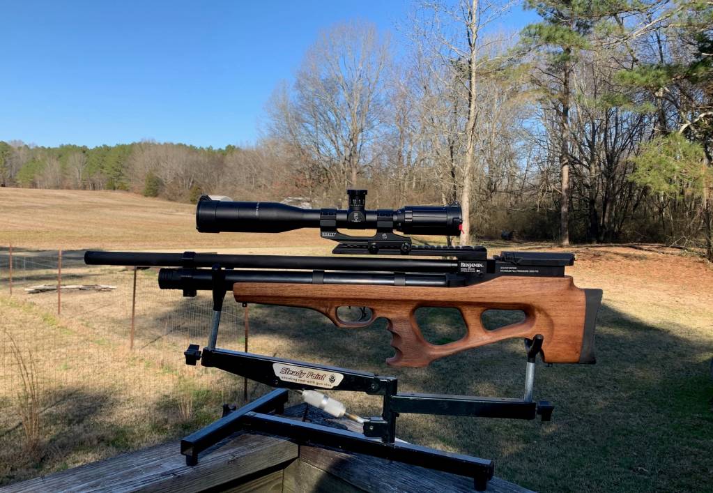

I am pulling together the support I need to start shooting Hunter FT. The rig I am starting out with is a Benjamin Akela with a fixed 16X SWFA scope. Being stuck inside the house during the cold winter months, this Akela set up seems quite comfortable to handle, but getting used to a shorter configuration is going to be key. Once I can get outside and can start the tuning and zeroing process, then I can beging to get a feel as to whther or not I can deploy this rig for the season properly.

Dragon64, I'm not stalking you but at times just like to follow what's happening. Please don't let me discourage you from trying your new rig in HFT but you might find out that a regular type pcp might work better for you. I really don't know anyone that has reached any recognized status shooting a bull pup in Field target. I never really like the looks of them and it took me 10 years to warm up to them. I have owned a couple AGT Vulcans and that is about it. I tried my Vulcan 2 .22 in one competition a couple years ago and most likely shot one of the lowest scores I have ever shot. It shot great on paper at home but I had a very bad day on the first field target course I tried. My remaining Vulcan 2 is in .25 and the only reason I'm holding on to it is the fact that it shoots a very tight SD and just before the CV19 entrance in the fall of 2019 I shot a couple of sub 1" groups with it at 100 yards. Hopefully this year maybe I can get to someplace that has a ERB event. I honestly don't know of any fact reason why they couldn't be used successfully in FT and maybe you will have better luck than I had. Best of Luck with it. P.S That is a beautiful Pup!

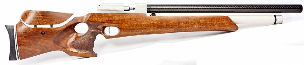

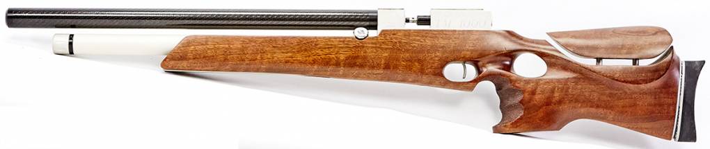

That being said, I put out some feelers for a rifle I have always wanted to own; a RAW TM1000 in .177. This morning I found one at a North Carolina Gun shop at a reasonable price, so I pulled the trigger and bought it... Buy Once Cry Once.
I will pull the Falcon X50 scope from my WFTF rig, and mount it to this new rifle, as the Falcon scope has a 16X mark. Also, I live close enough to old RAW facility in Tennessee, that I may be able to get Martin to go through the rifle and make sure it is competion ready. Here are the pics from the firearms store that I found this morning.

Check and see what barrel it has. If it has the polygon rifled barrel, you should definitely check out the old style JSB monsters. They tend to shoot very accuratly out of those barrels. Of course, with that heavy pellet, it's going to be falling out of the sky at 50-55 yards, and you're shooting hunter, so the range finding at that distance is going to be tricky. Worth a try though.
