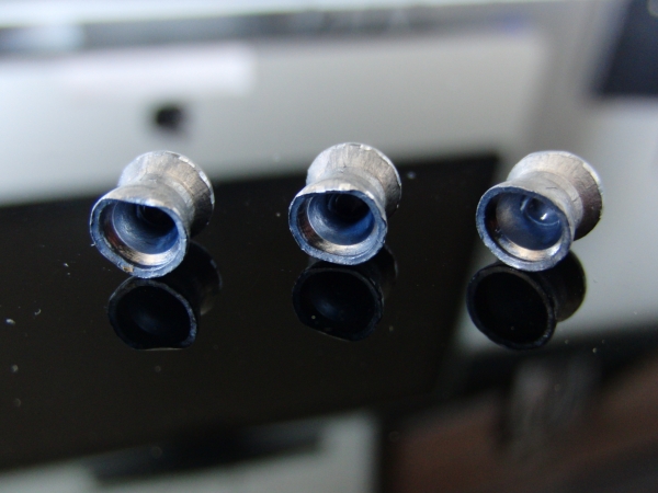

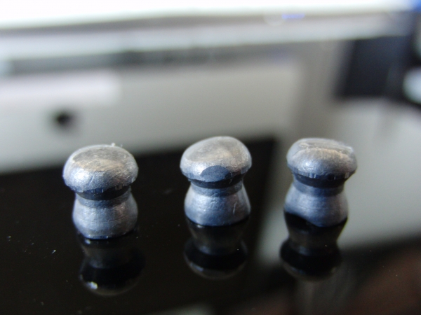

So I have been having some POI issues and slightly erratic FPS issues. So I shot three pellets into a bucket of water and here is the result. Not conclusive till I shoot a couple mags into the water but thought I'd post to get your ideas.

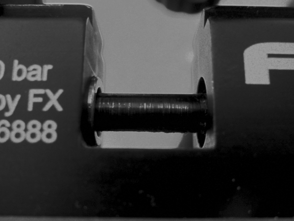

If you look at my bolt probe, there appear to be machining chatter marks. Can't really see them being from the gun cycling.

How much play should there be in the bolt probe?
I don't know anything about Monsoons but are you able to chamber one with the probe and remove the barrel safely then push the pellet through? Shooting them in water would distort them so much might be hard to get any solid data to troubleshoot.
And yeah definitely looks like chatter marks, I would guess something is off in the probe mechanism if there's any play side to side when inserted in the barrel.

The violent action of the probe bolt action causes a lot of wear on the slider. Aluminium casting.
