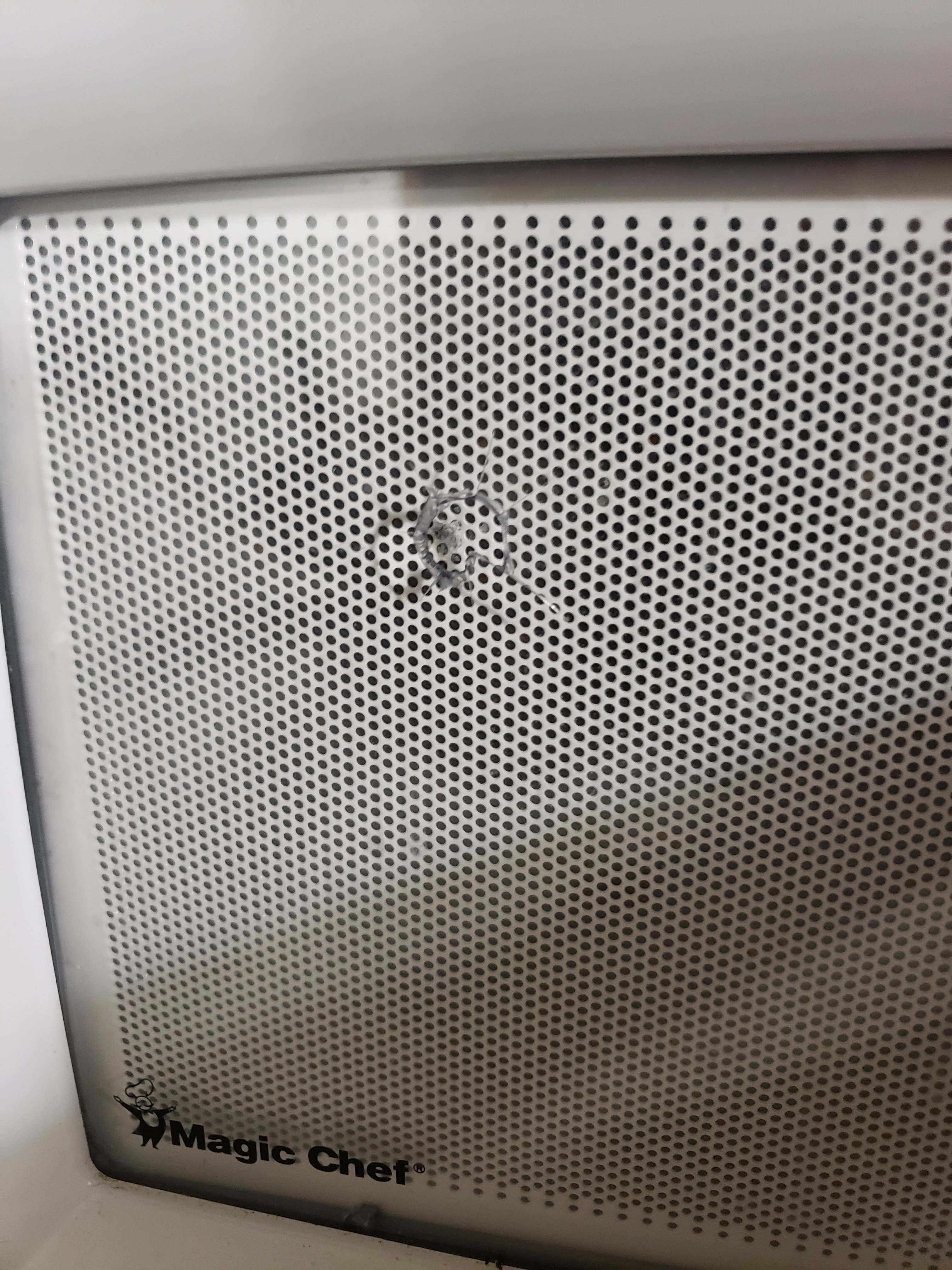

I mean, it probably can kill mice but I dont know how humanely. I may or may not have accidentally shot my microwave with mine at 10m and it broke the plastic but it just barely managed to dent the metal mesh screen inside. To be fair, it did pass through what was left of a paper towel roll first...

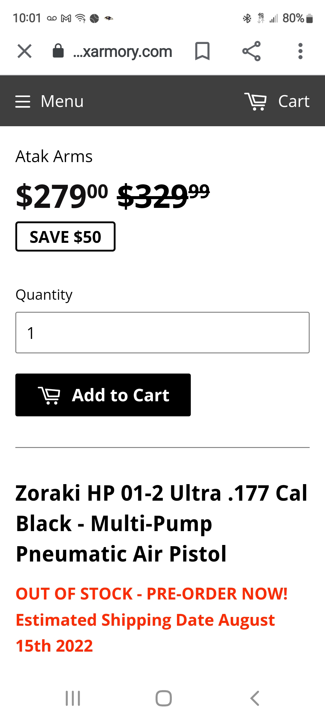

I just looked, nowhere can these be had right now ! All on..."preorder"..! And my guess, that's an...extended...preorder. Well, I found ONE...that MAY have them, some oddball country that no one ever heard of..!!

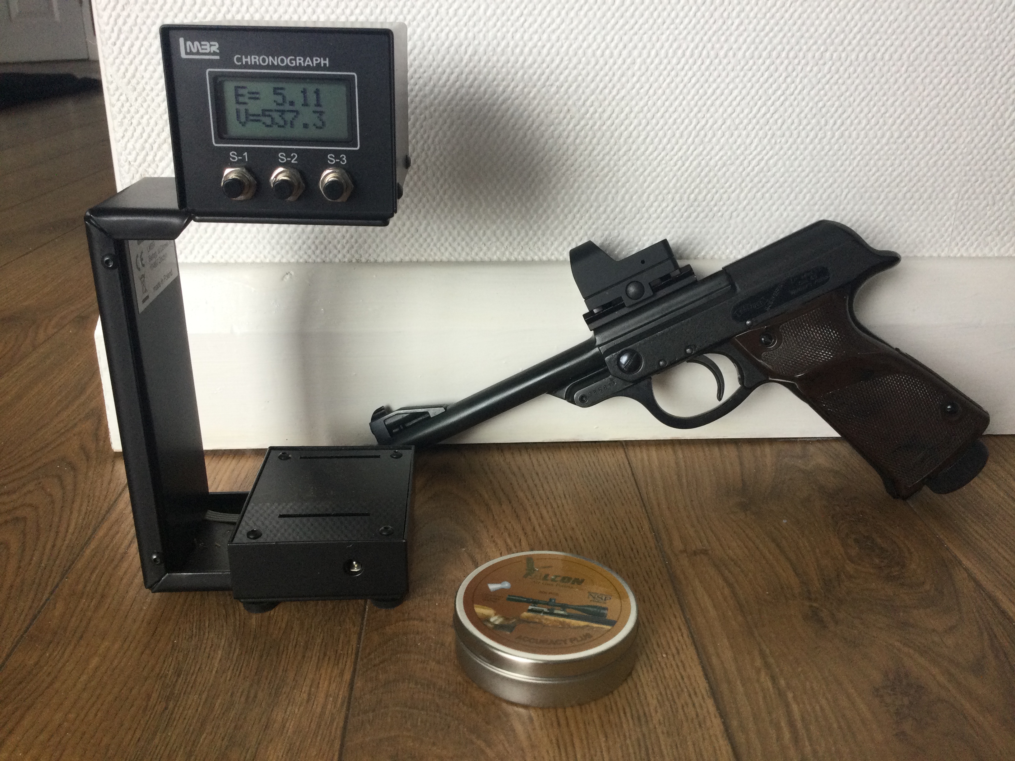

You really need 500 fps with a dome pellet for it to be a realistic proposition, given the pellet will lose some 40 to 50 fps over the usual 8 to 10 paces you might encounter them.
This means a 400 fps HW40/P17 derivative, will be doing barely 350fps at the point of impact….risky at best.
Yeah, went to the trouble of testing velocity lost, but if you do want to try this yourself, make sure you build a little wood frame to cover the readout display on the Chrony. Its sods law you will miss the space for the pellet path and hit the damn screen.
At 500 fps, a dome pellet will pass through the neck of a rat, and occasionally do both sides of the skull at 8 to 10 paces.

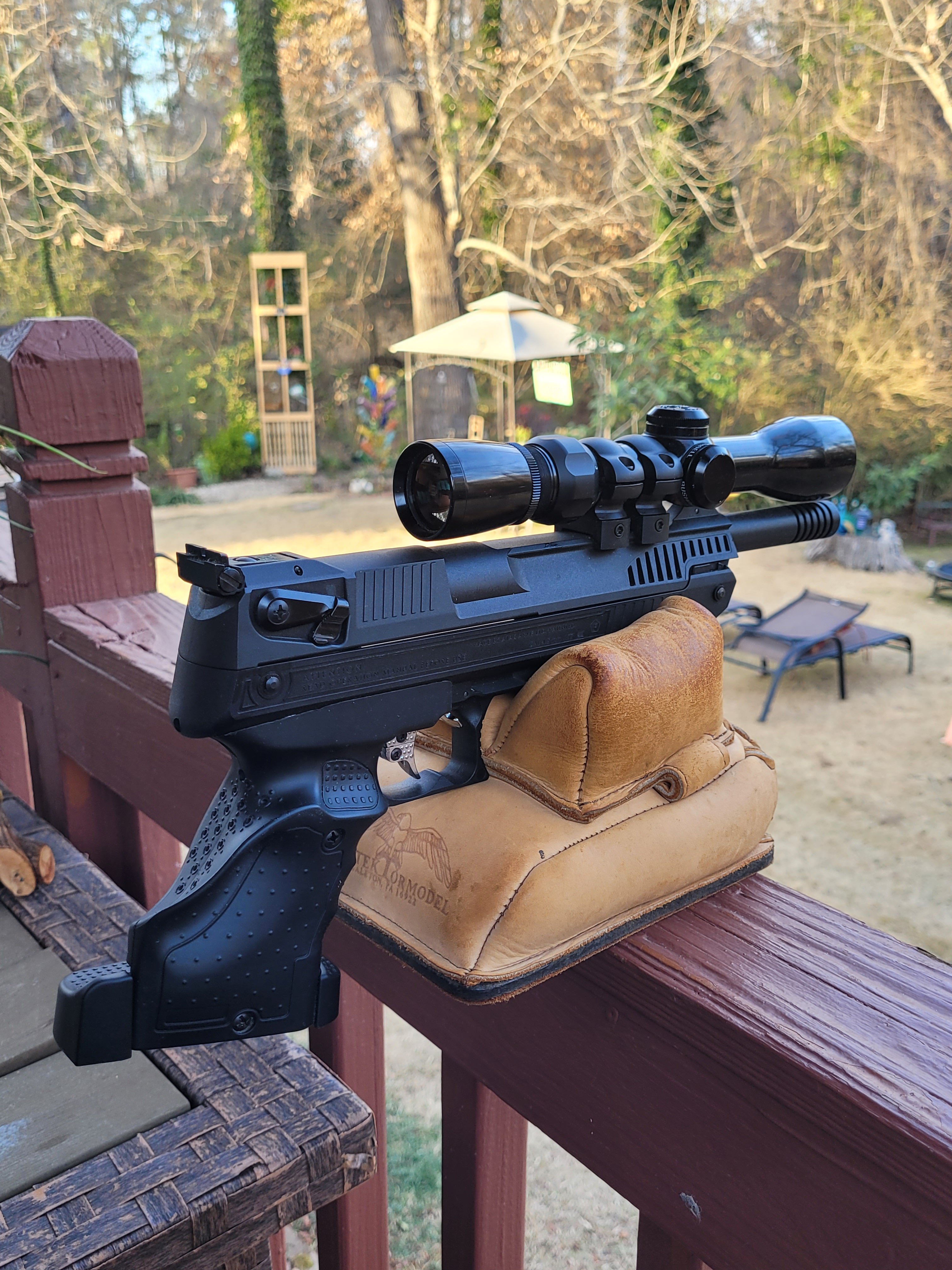

I have one of the Zoraki ultra models. One pump is easy, two a little more difficult, 3 and 4, well at 77 years old, let's just forget it. Accuracy is there, I shoot mine iron sights only, tried a scope and could not find one with long enough eye relief for my long arms. In all honesty, having been in airguns for about 48 years now, you are not going to find much, if anything, suitable for under $100, I would double or even better triple that figure. My first air rifle back in 1975 cost me about $175, think what that would be in todays dollars. Bottom line is now as it has always been, you get what you pay for.

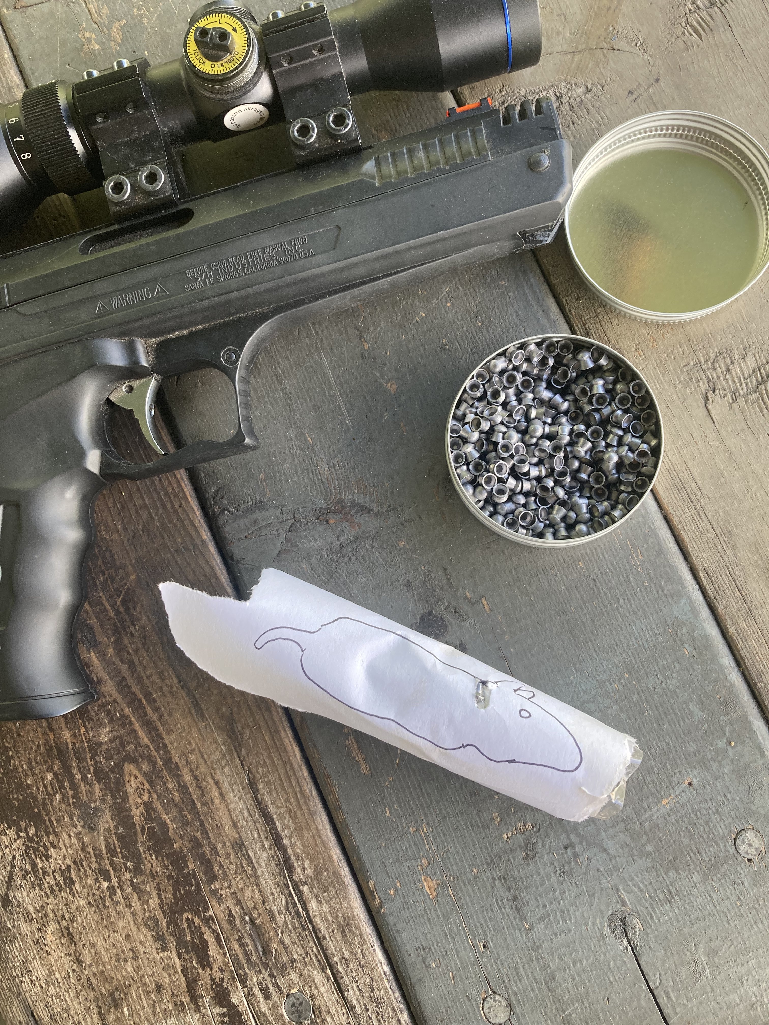

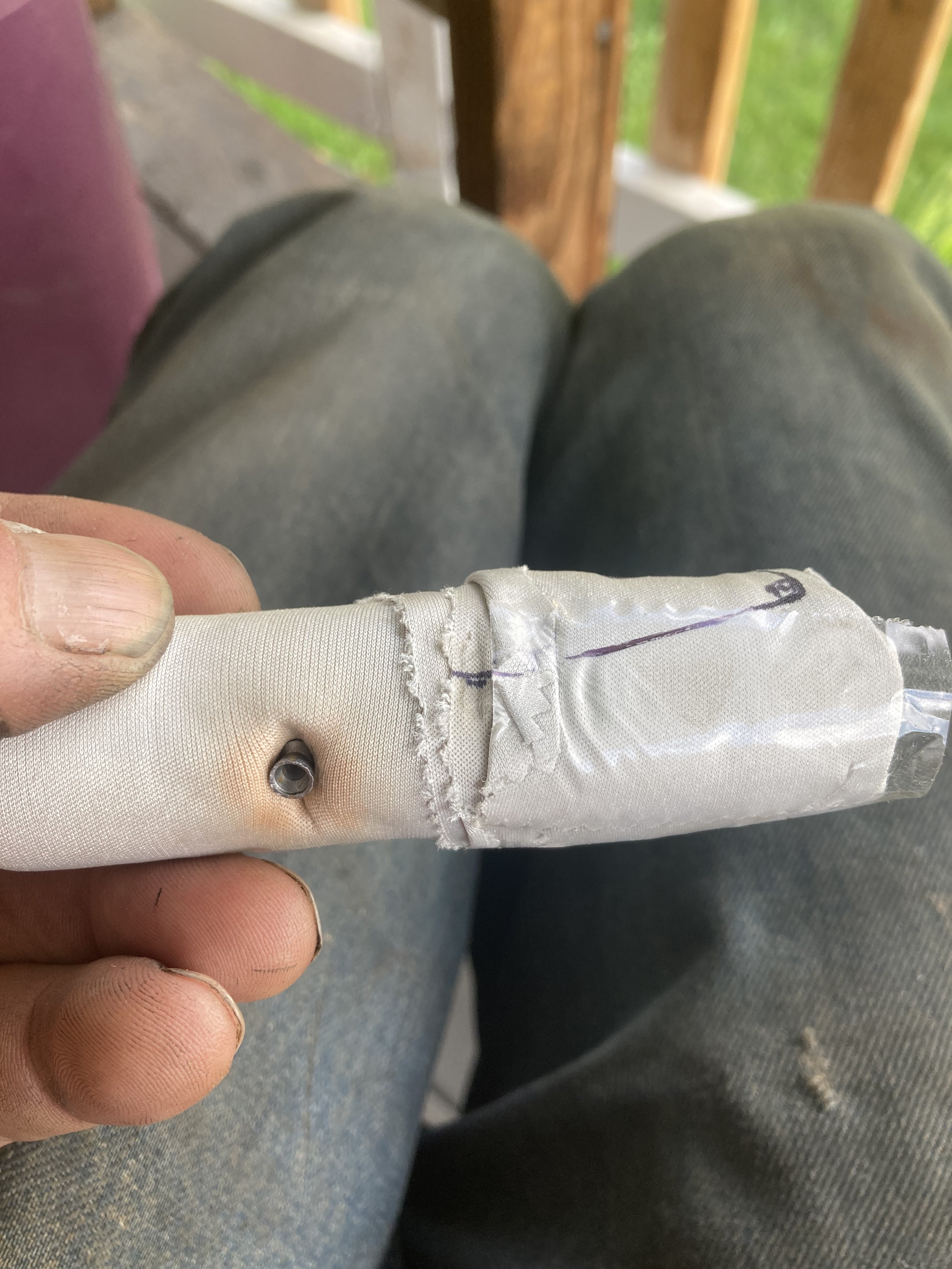

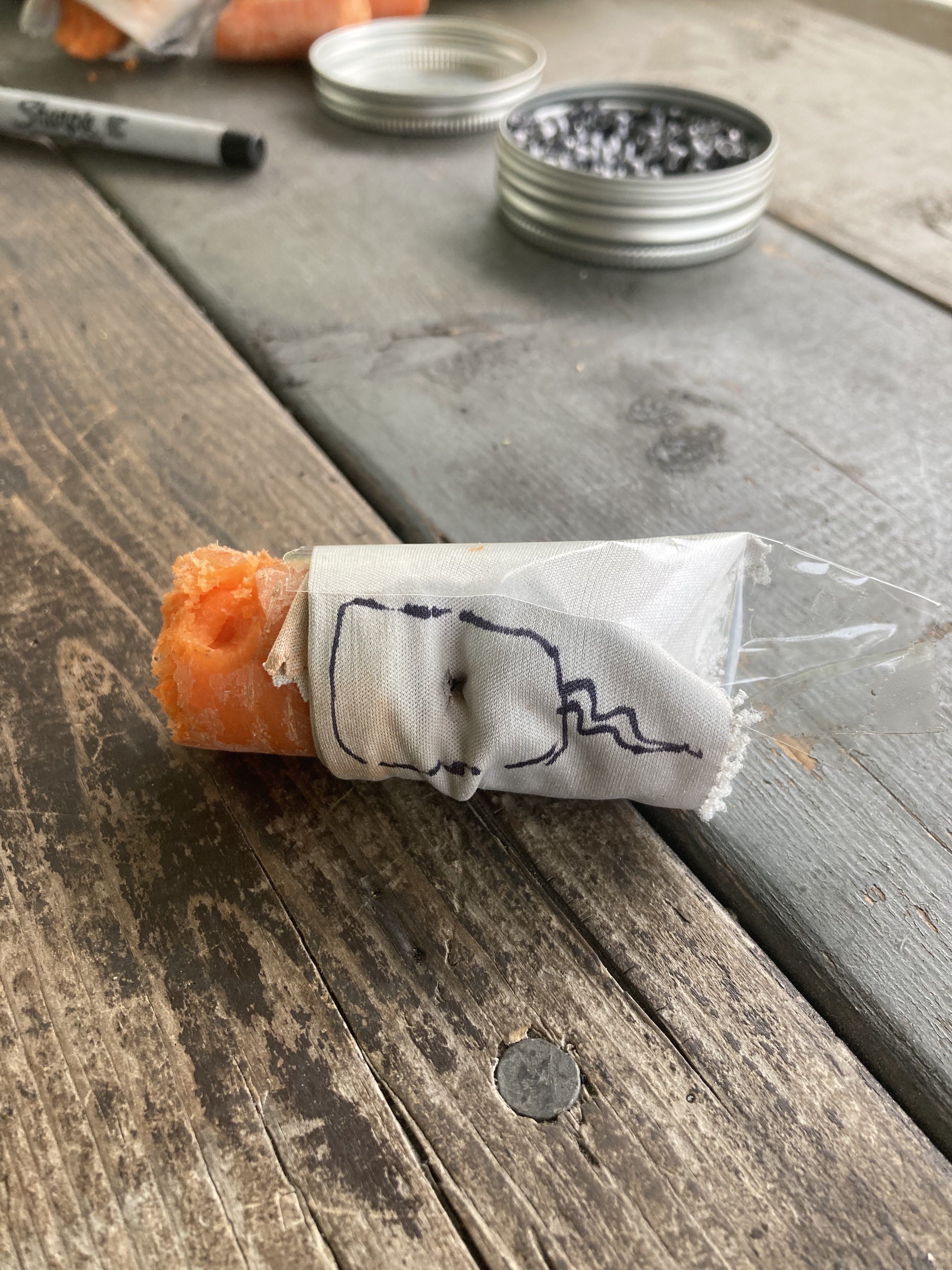

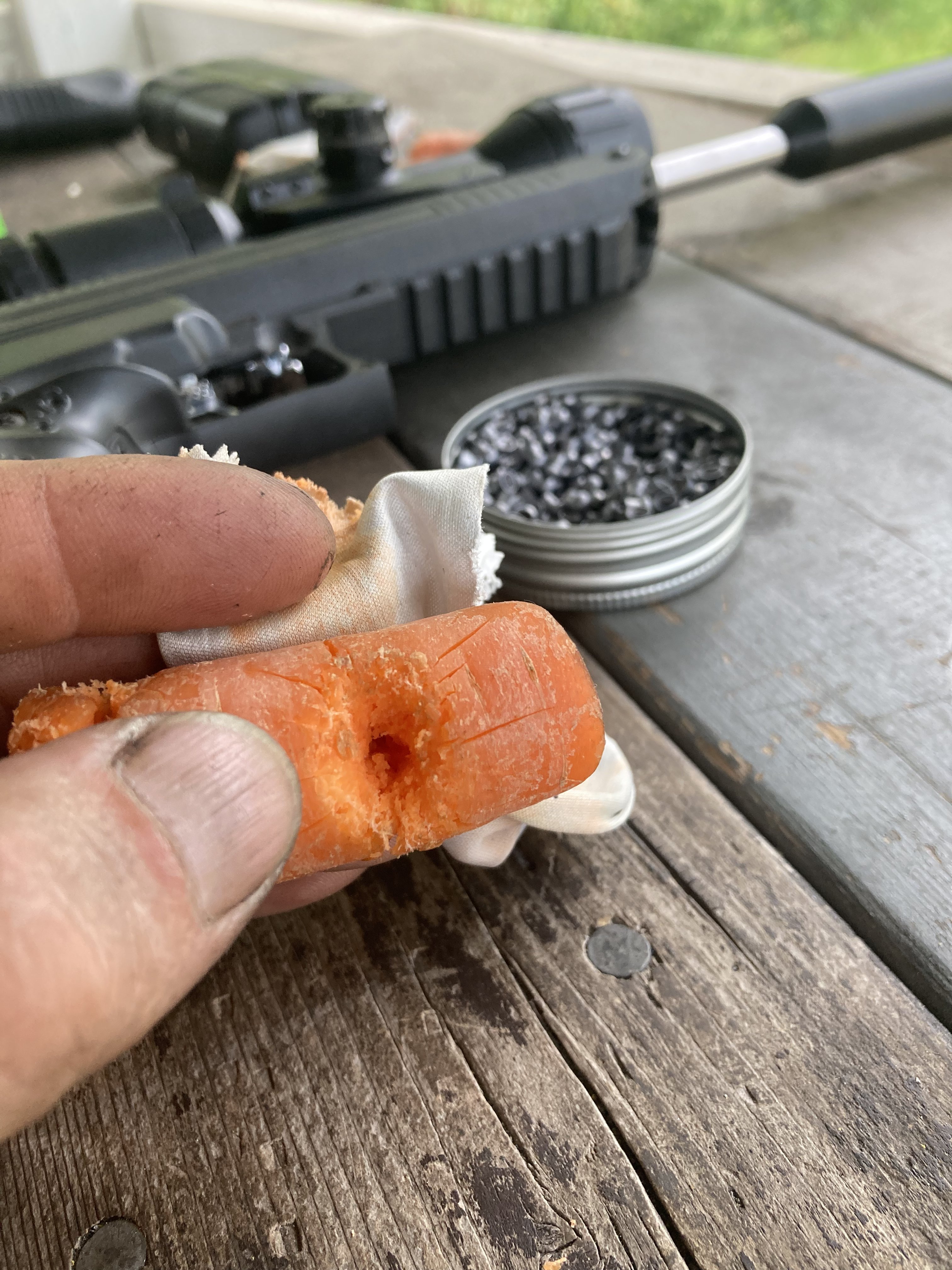

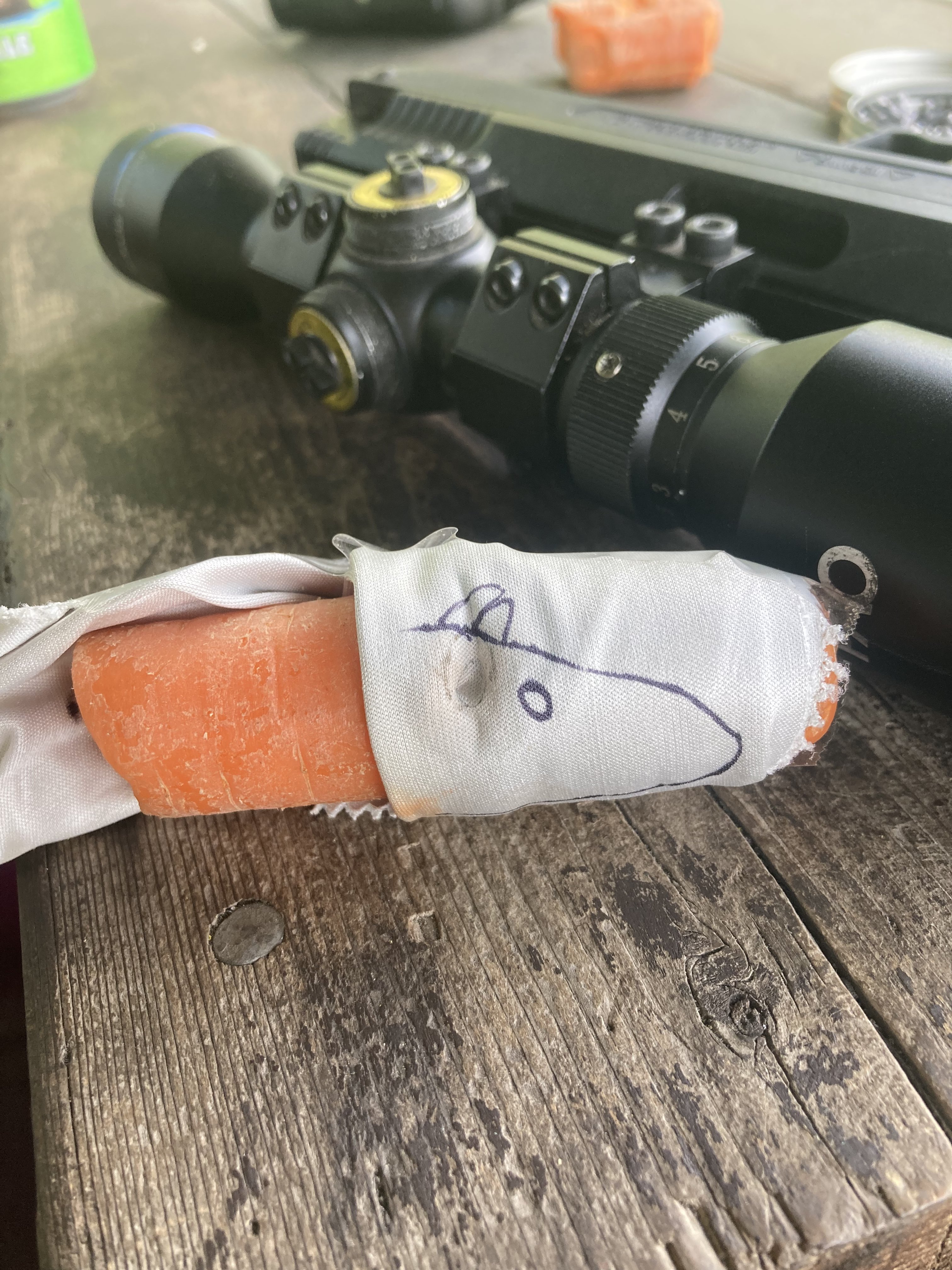

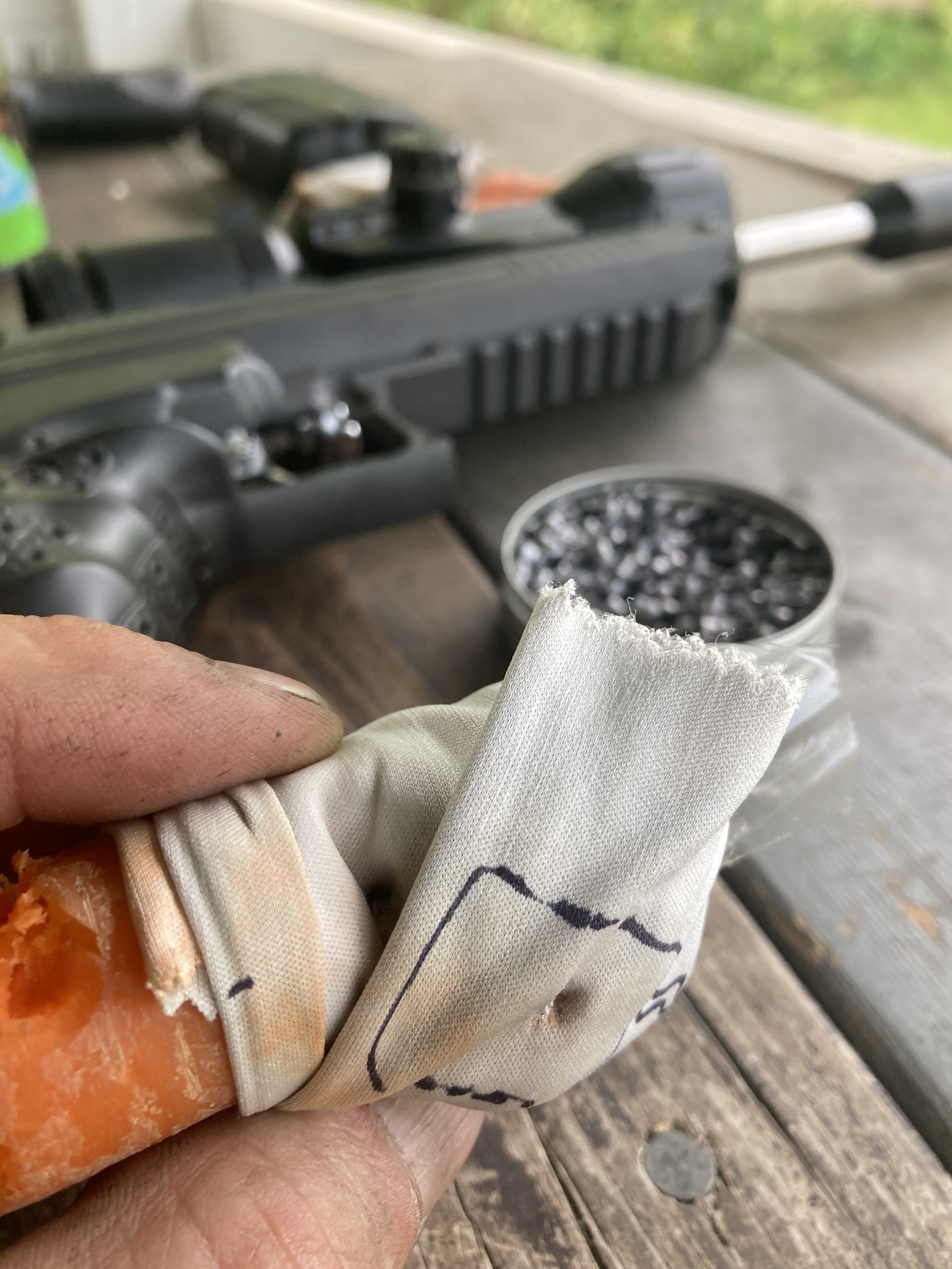

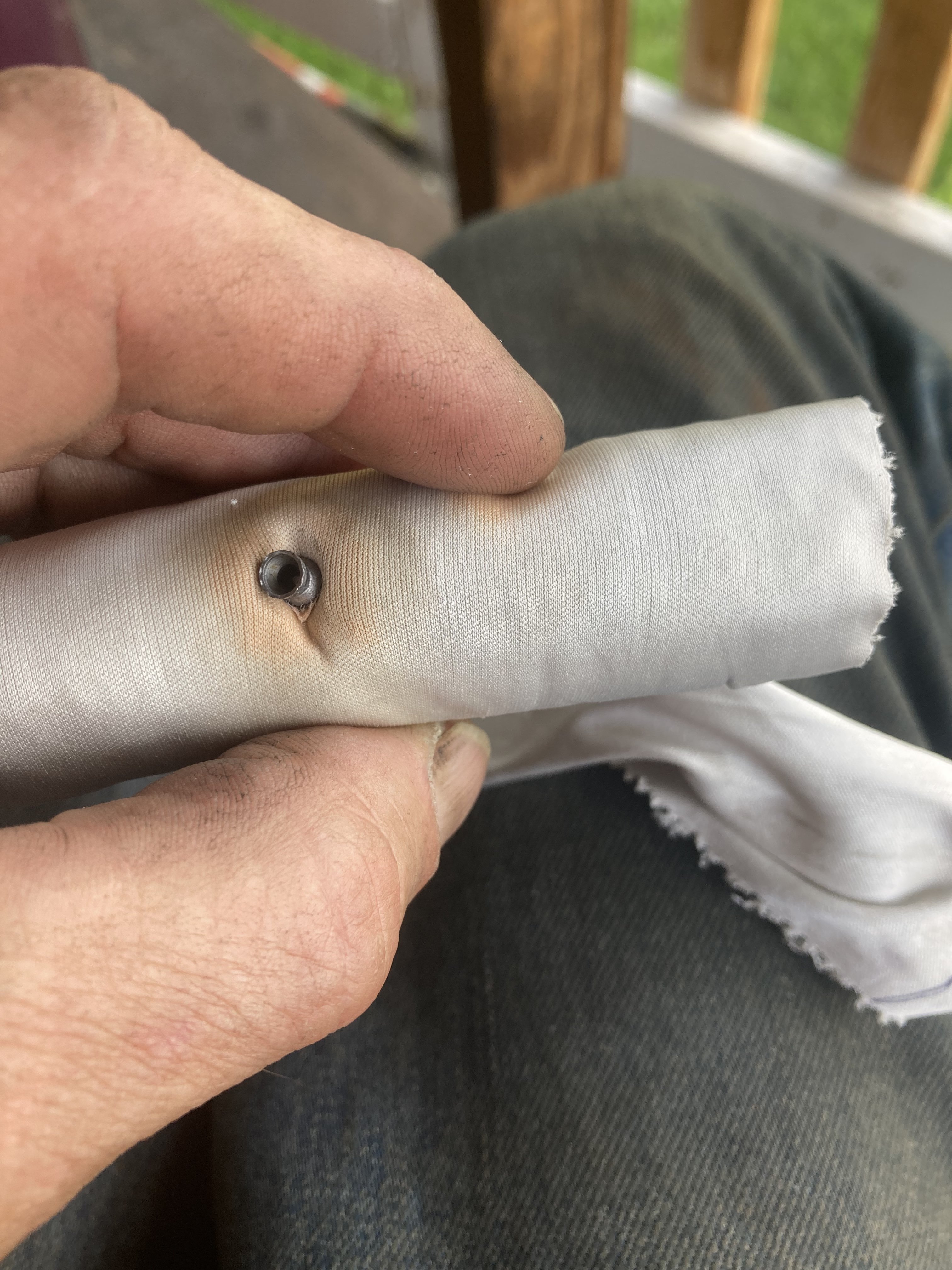

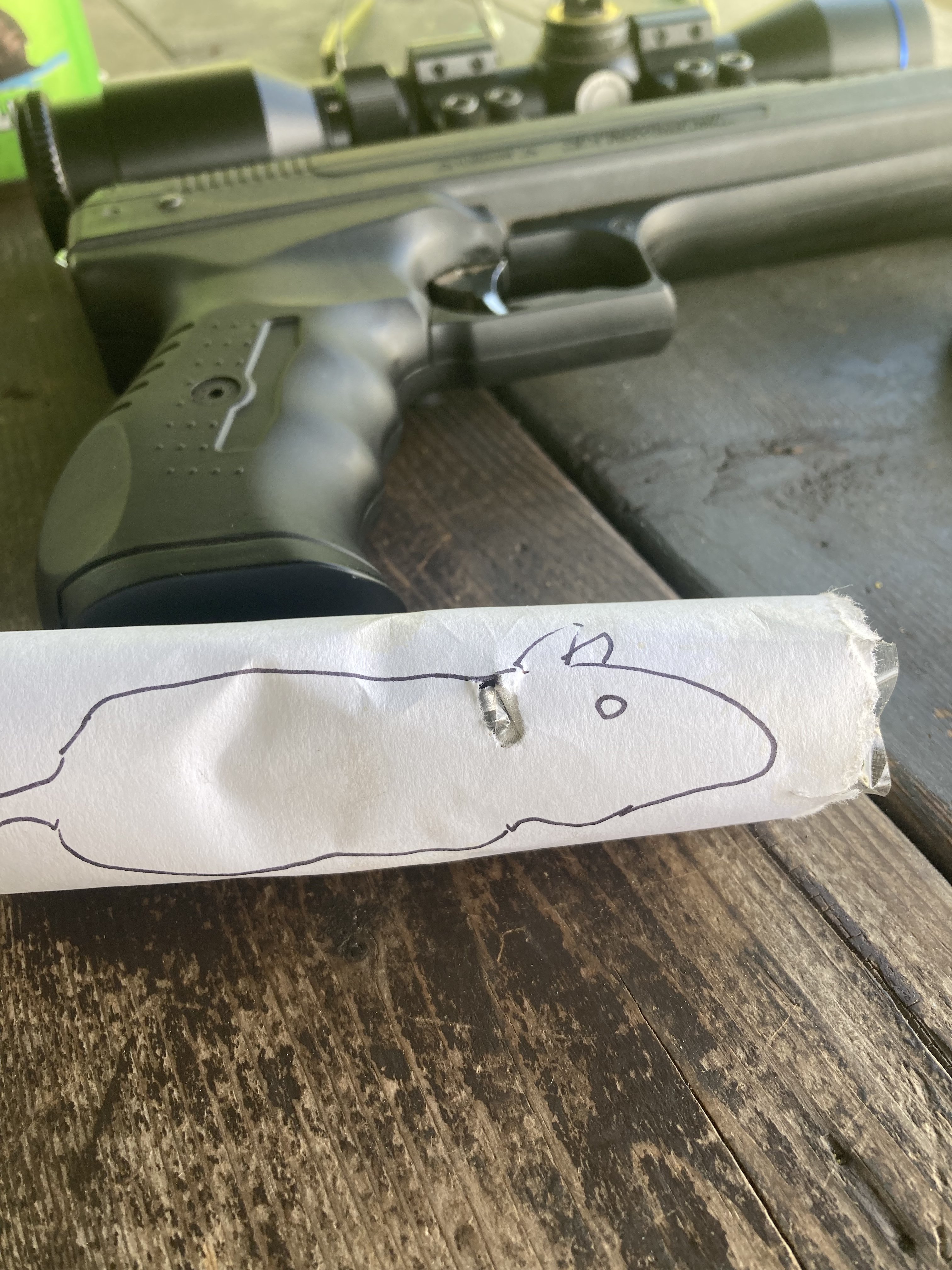

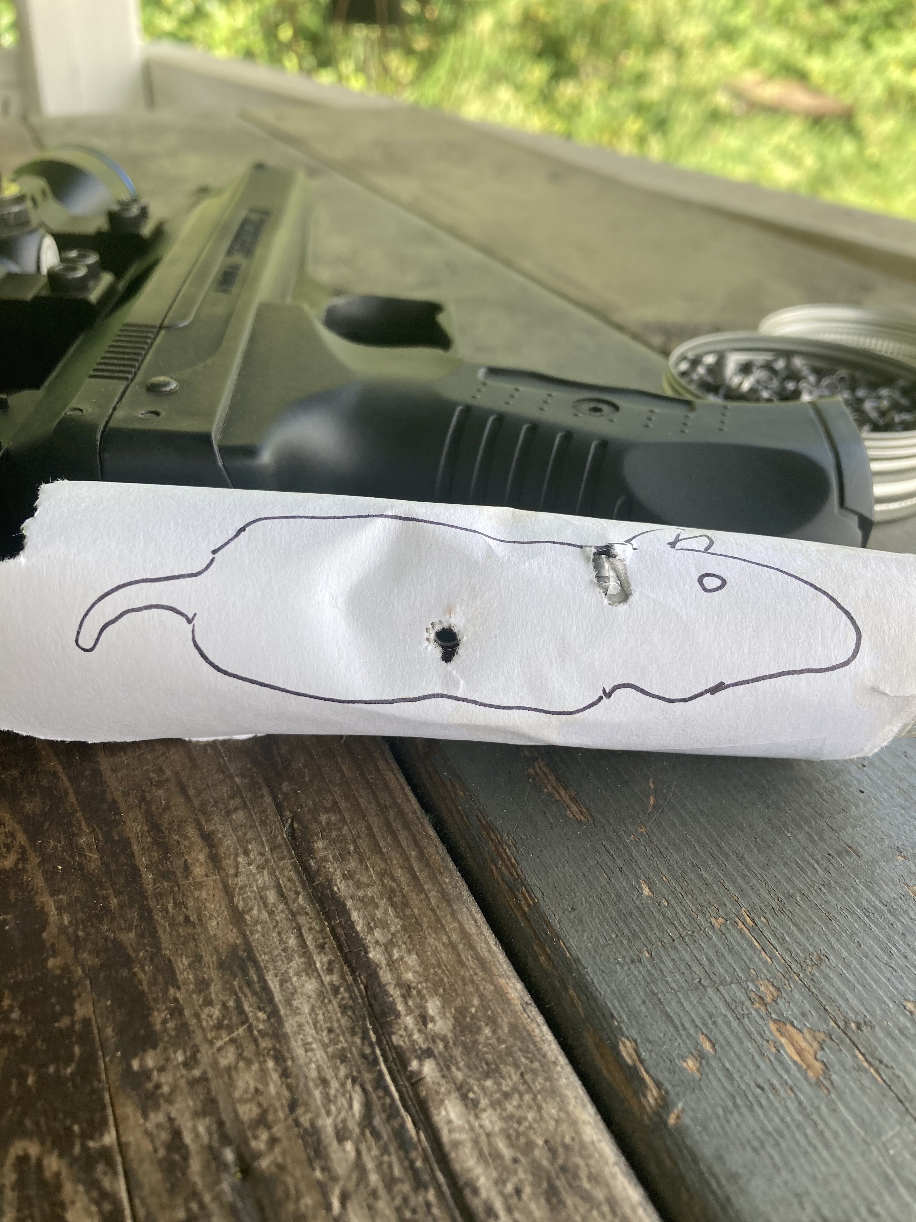

Here’s an experiment I just finished to test the killing power of the P17 shooting the 7.33 grain JSB pellet at 10 yards and at 5 yards.
The target is a hard carrot wrapped in four layers of that glasses cleaning cloth to simulate a rats hide.
This series of photos is all from the P17 at 5 and 10 yards.
Then I’ll show the same exact test using the Zoraki on three pumps with the same 7.33 grain pellet.

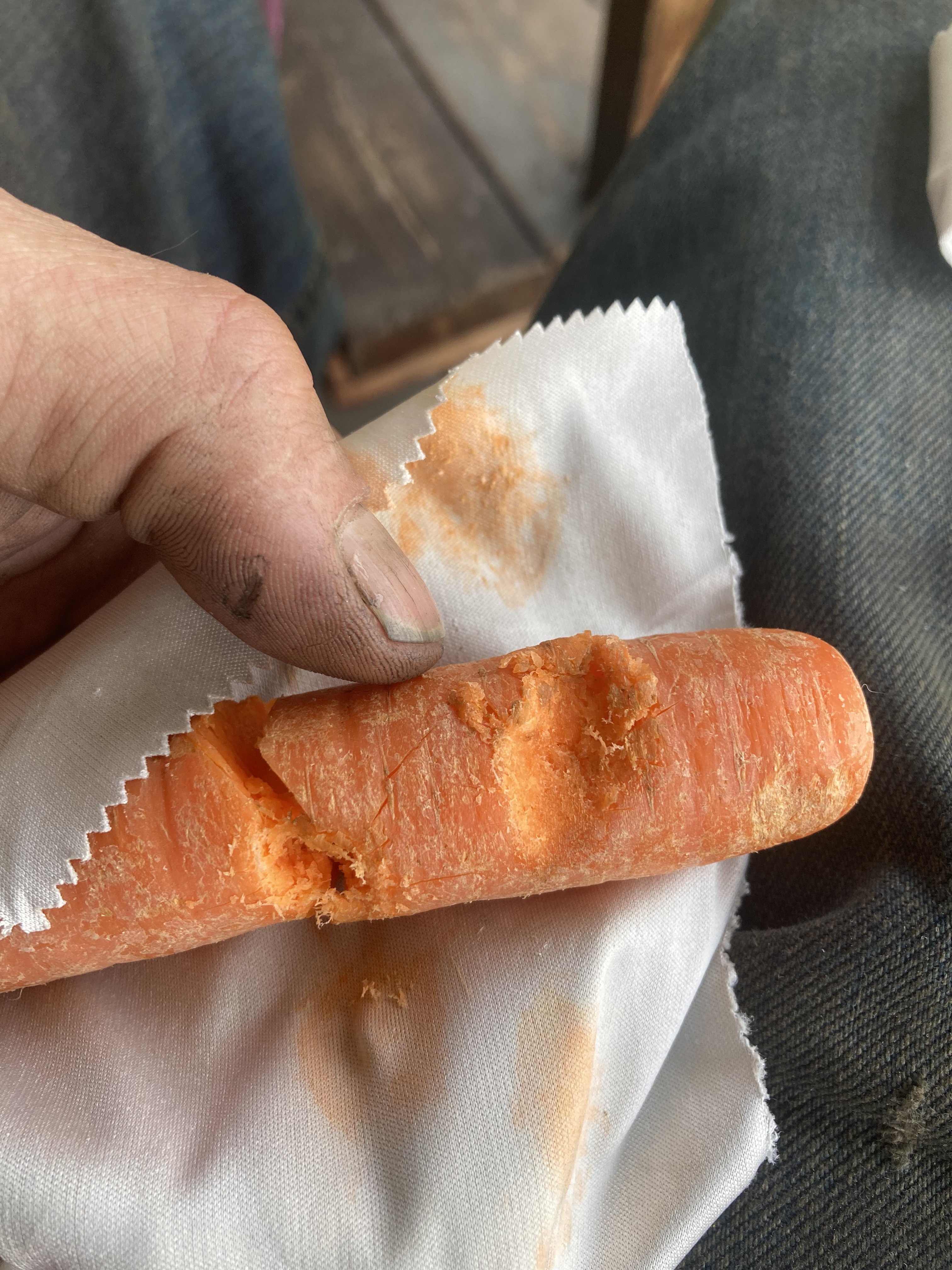

Then I’ll show the same exact test using the Zoraki on three pumps with the same 7.33 grain pellet.View attachment 273640View attachment 273641View attachment 273639View attachment 273638

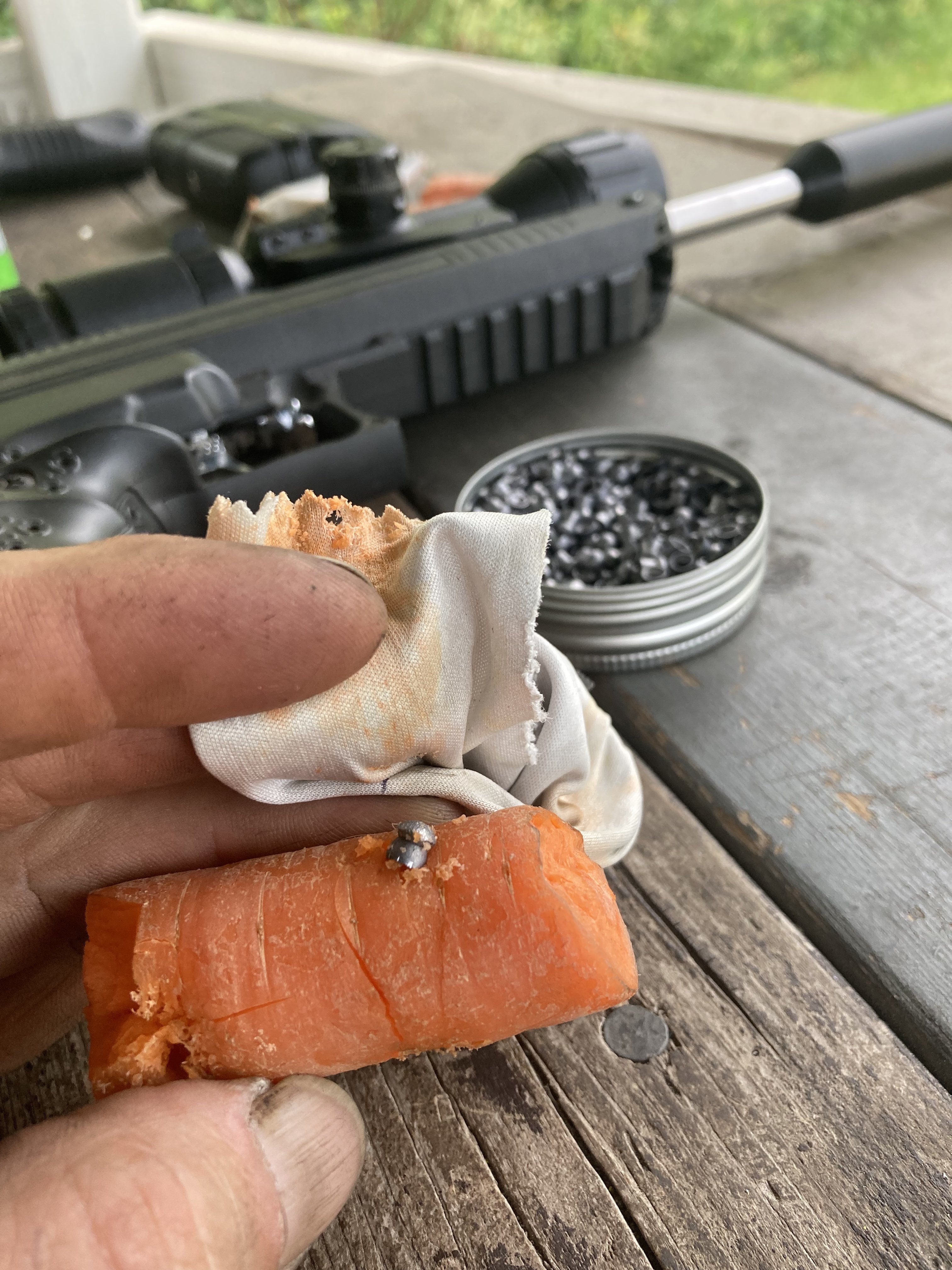

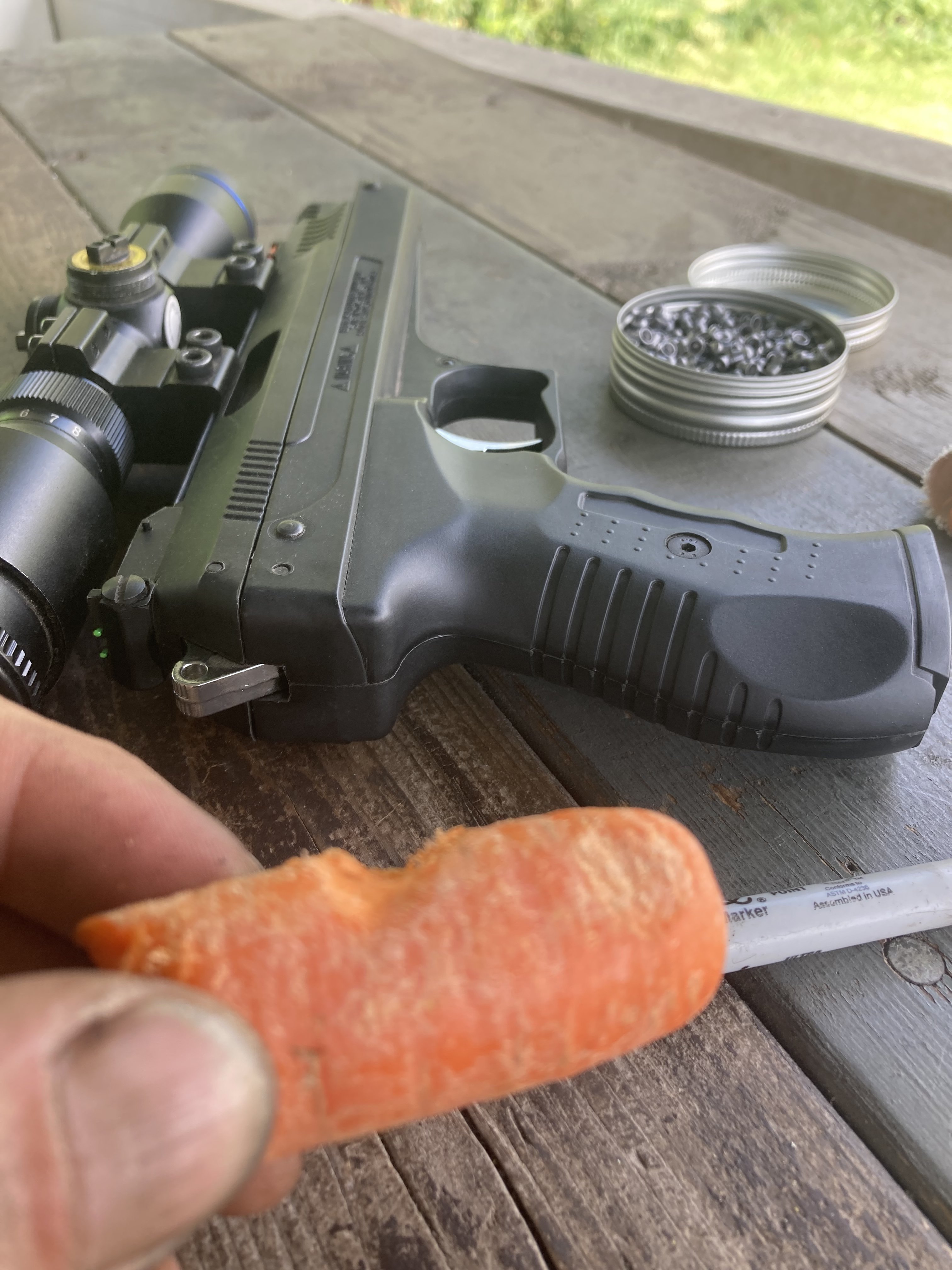

This is the Zoraki at 10 yards, much more impact and damage than the P17.
But if you can hit the head at 6 yards I’d think the P17 would definitely kill a rat.
For $160 more you would definitely have a rat smacker.
But if you can consistently hit a raisin at six yards with the P17 then that’s a dead rat every time!
Let us know what you end up doing!
Practice at 6 yards and the P17 can be a deadly mouse trap!

The last pictures are of the Zoraki at 10 yards, lots of penetration on three pumps, .177 shooting 7.33 grain pellet.
