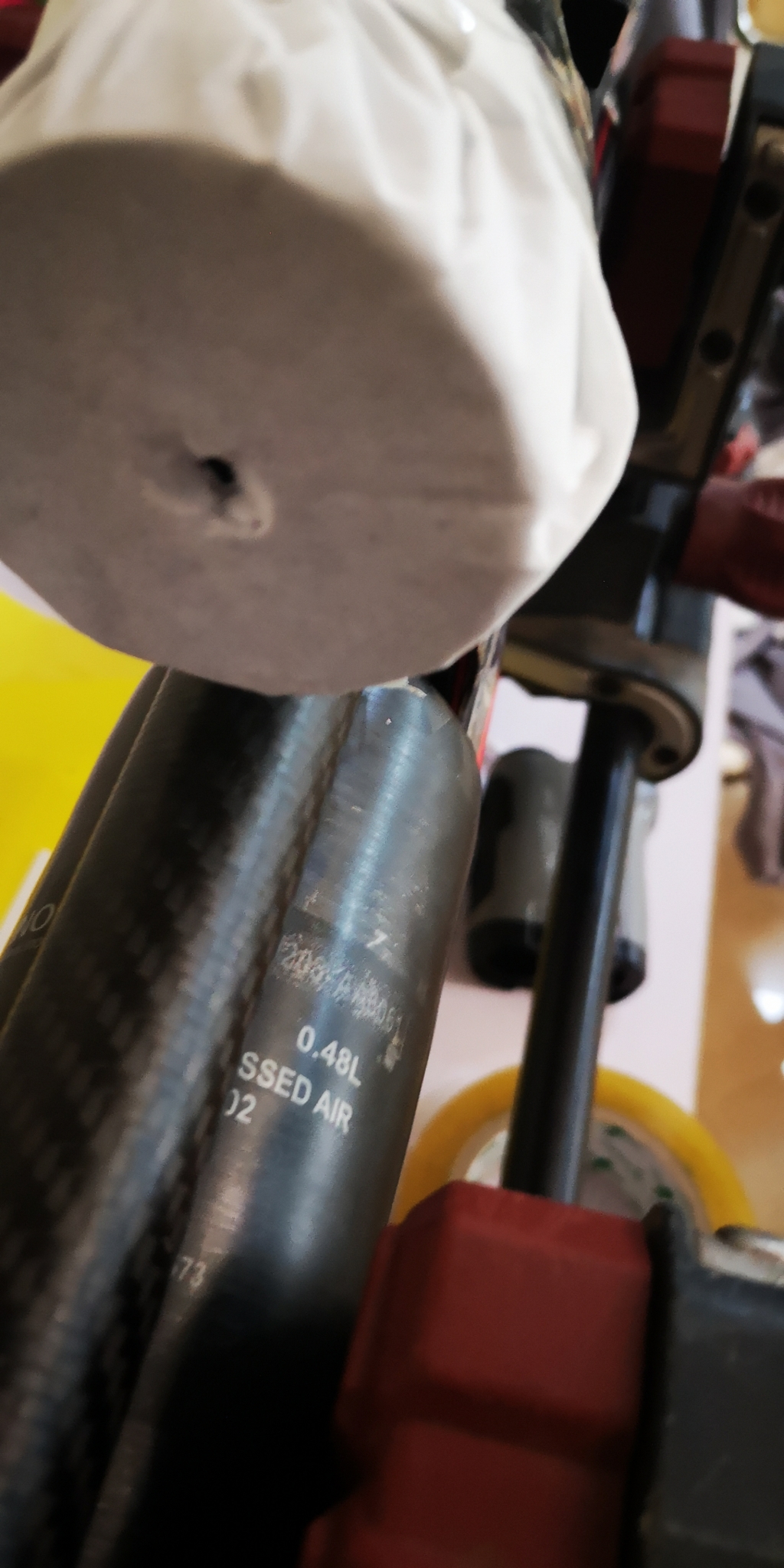

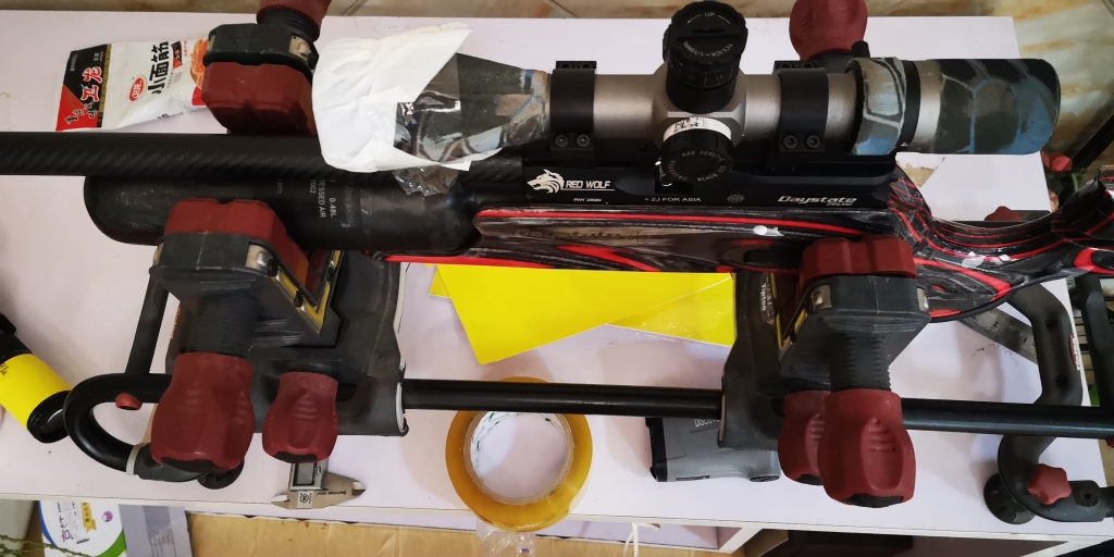

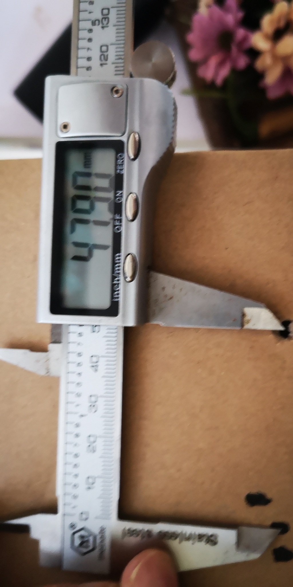

What a name you have chosen, a number, well, I'll call you Pi, even if the number is not 3.14. I'm curios to see your results, can you compute the height with your method and then use the method nisouck proposed and share the results with us? I'm curios to see if we get different numbers.

If the scope objective is over the barrel itself, the measuring method seems to work well enough for initial data input to ChairgunPro -- but -- if the objective is over the compression tube of a spring/gas ram powered rifle where the barrel is often lower than the tube itself or is often not aligned to the compression tube (think break barrel) the method in the video works very well.

Good morning sir. My ID does not represent any goal. When I registered for an AGN forum account, I mistakenly viewed my name as an account, so I wrote a line of numbers. Its method is correct, but when measuring various values, this process will take a lot of time, and most importantly, my math is very bad. I have used this method before, and the answer is the same.
