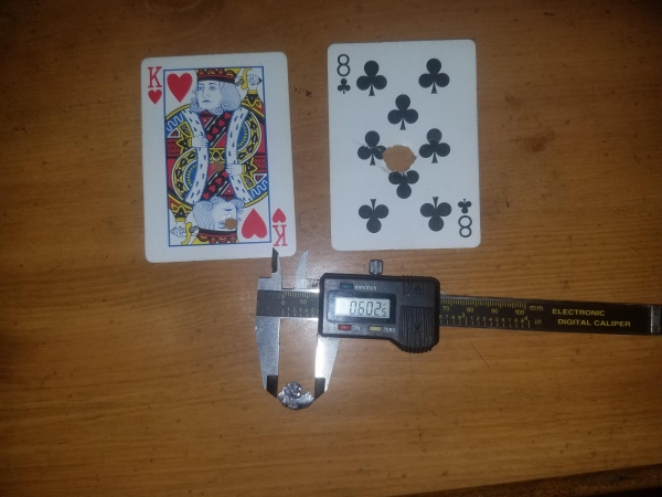

Thought I'd welcome those with powerful airguns and a deck of cards laying around to a test to see what it takes, or if its even possible, to shoot through an entire deck of playing cards (Calling all .452 slayer owners hah). My attempt was at a mere 56 muzzle FPE @ a safe distance of 10 yards. If you attempt either test please note your caliber / grain / distance from target / velocity or fpe / target material (if attempting max expansion) and expansion (can use percent calculator to figure percent increase from original). Most importantly, be safe, and use safety glasses! :)
Caliber: .25
Grain: 33.95
FPE: 56 (865 fps)
Distance: 10 yards
Target: Deck of cards
Cards fully penetrated: 23 (few more were damaged / cracked but not full penetration)
Expansion: .602" = 140.8%
(first card entry = king(king has 2 holes 1 from earlier 20 fpe shot), last card entry = 8)
This 'test' is purely for enjoyment / entertainment / bragging rights. May the lead measuring begin, lol. Lastly, feel free to guess what it will take to full penetrate a deck of cards, my guess is roughly 130 FPE.

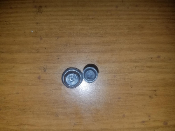

I had 3 decks and figured this would be a fun test, I performed it in the past at 40 fpe and was amazed how few cards I could make it through, still am at 56 fpe. Wonder if the dollar store carries decks of cards? I am willing to bet they do. The .25" entry and .602" exit in final card is quite amusing. The pellet actually fragmented to some degree, for a 33.95 gr mk ll to fragment means a lot of energy transfer. I've splattered some good lead on metal but doing it on paper is something else.

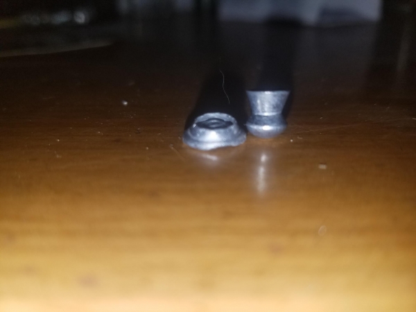

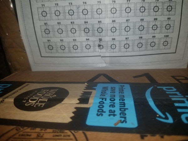

Welp, a Polymag did the job! This deck was secured with tape against the box of rubber mulch which likely favored it some, but still, I think it was more the Polymag that deserves the credit.
.25 Cal
26 Gr Polymag
930 FPS / 50 FPE
10 Yards
Deck of cards
Full deck penetration
.358" Expansion (pellet irretrievable in box of mulch)

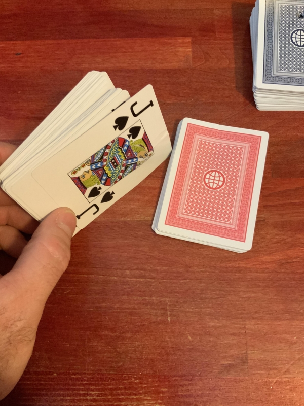

Pictured last card in deck: (the last 30~ or so were ripped like this as opposed to cut like one would normally expect/see) Quite interesting how the pellet ripped through as opposed to cut through towards the latter half of the deck.
Penetration into the box of rubber mulch. I was really shocked when I pulled the cards away from the box to see it.

Lol, that is a good approach to testing various pellets and their effects. With my test I am convinced a 50 fpe Polymag would be much more devastating than a 60 fpe MK ll.

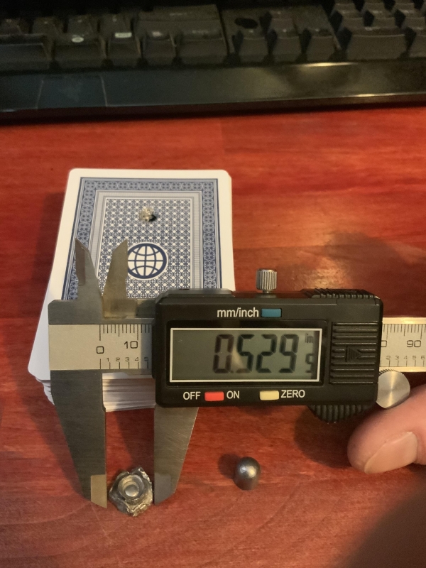

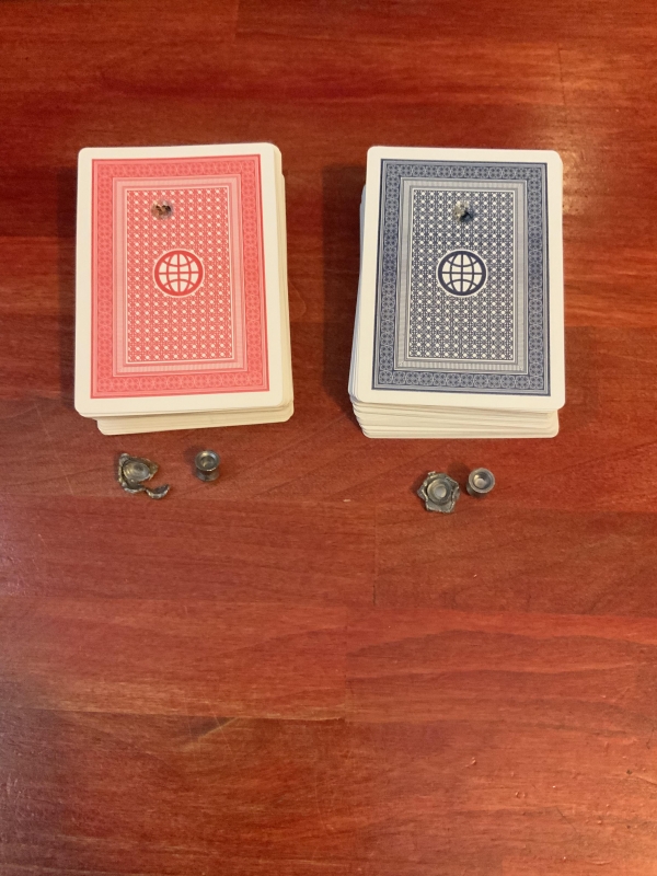

Hi All,
First off, for those of you interested, Dollar General has cards for a dollar per pack. I grabbed a couple of packs last night in anticipation of a nice, leisurely day off spent shooting.😁
Here are my results with JSB 50.15 and 44.75 grain pellets, I used tape to attach the cards to my box of rubber mulch at 10 yards.
The 44.75 gain partially broke apart and failed to penetrate the entire deck (stopped 10 cards short). The 50.15 grain tore through the last card but didn’t completely exit the deck.
Red Wolf HP .303 @ 10 yards
JSB Exact 50.15 grain
798 FPS
71 FPE
JSB Exact 44.75 grain
835 FPS
69 FPE

@Chunky_Munky Holy cow, incredible how a 50 fpe Polymag can do it but a 70 FPE JSB Domed can't. I also find it interesting my 33.95 MK2 expanded roughly the same as your .30 cal 44.75 gr....obviously both your jsb's out did the 33.95 mkll in my test being quite the higher energy.
So far this test has been quite intriguing. Obviously some deformation is good and desired to reduce over penetration, but with harder lead designed to rip holes gets put in the softer leads place, a lot more damage can result...which IMO makes me feel very confident in what low energy can accomplish with the right projectile/ammo hardness/design.
So far JSB's seem great to reduce over penetration, they expand and the expansion itself further slows down the projectile by having more surface area.
I kind of wanna go digging into my box of mulch to retrieve the polymag I shot through the entire deck of cards at 50 fpe..
