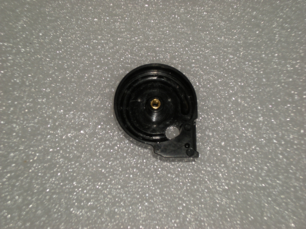

If pellets are tight going into the magazine, would it be a consideration that they may be tight coming out; thus scoring the pellets as they fire?
If so that could impact upon accuracy

Sure but if loose it can damage subsequent pellets too when it bumps the next round against the magazine stop when indexed just like the Theoben Rapid and Raw 177 magazines pkus loading pellets sideways and smashing the skirts closing the bolt home worse on accuracy than self sizing straight through virgin nagazines. Been there done that way too many times why do you think FX sideshot customers got problems some slugs tipping over sideways too loose fit in magazine.

I disassemble my Mrod mags before use. I polish the hole so pellets drop in and sinei I shoot H and N Terminators which have a point I use a screwdriver as a tool to tweak the surface that the tip rides in when rotating. There are injection molding voids which will allow the tip to catch on and prohibit rotation. Takes a few minutes but beats shooting without a pellet when hunting bushytails.
