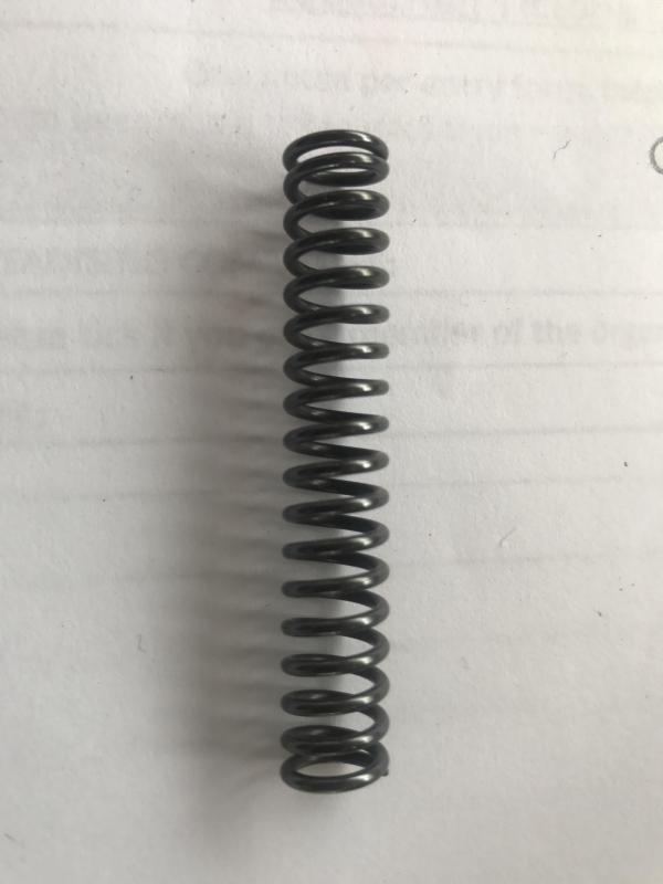

What I found was if I preloaded the hammer spring with the adjustment beside the power wheel I could get more velocity (It is not meant to be preloaded just no slack). So I knew the problem was either the spring or the hammer. My hammer weighed from memory 19.1 grams. I think even 1 gram extra would have got the velocity to standard 850-860fps.
I was struggling to get to 800fps before I added the weight.I tried for many days with many different reg pressures and spring settings. I have now got the new spring but haven't bothered to fit it. It may have also solved the issue.
​Spring is 56mm long 10mm diameter 1.4mm wire.

Yes that's the same as the one in mine I thought I wouldn't have time but I found a min and this is the same as what I got..
