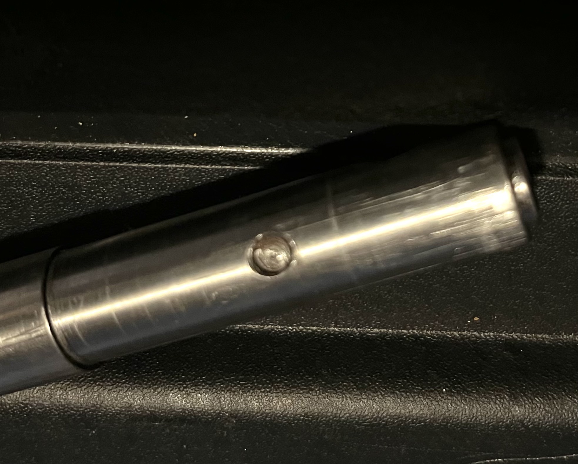

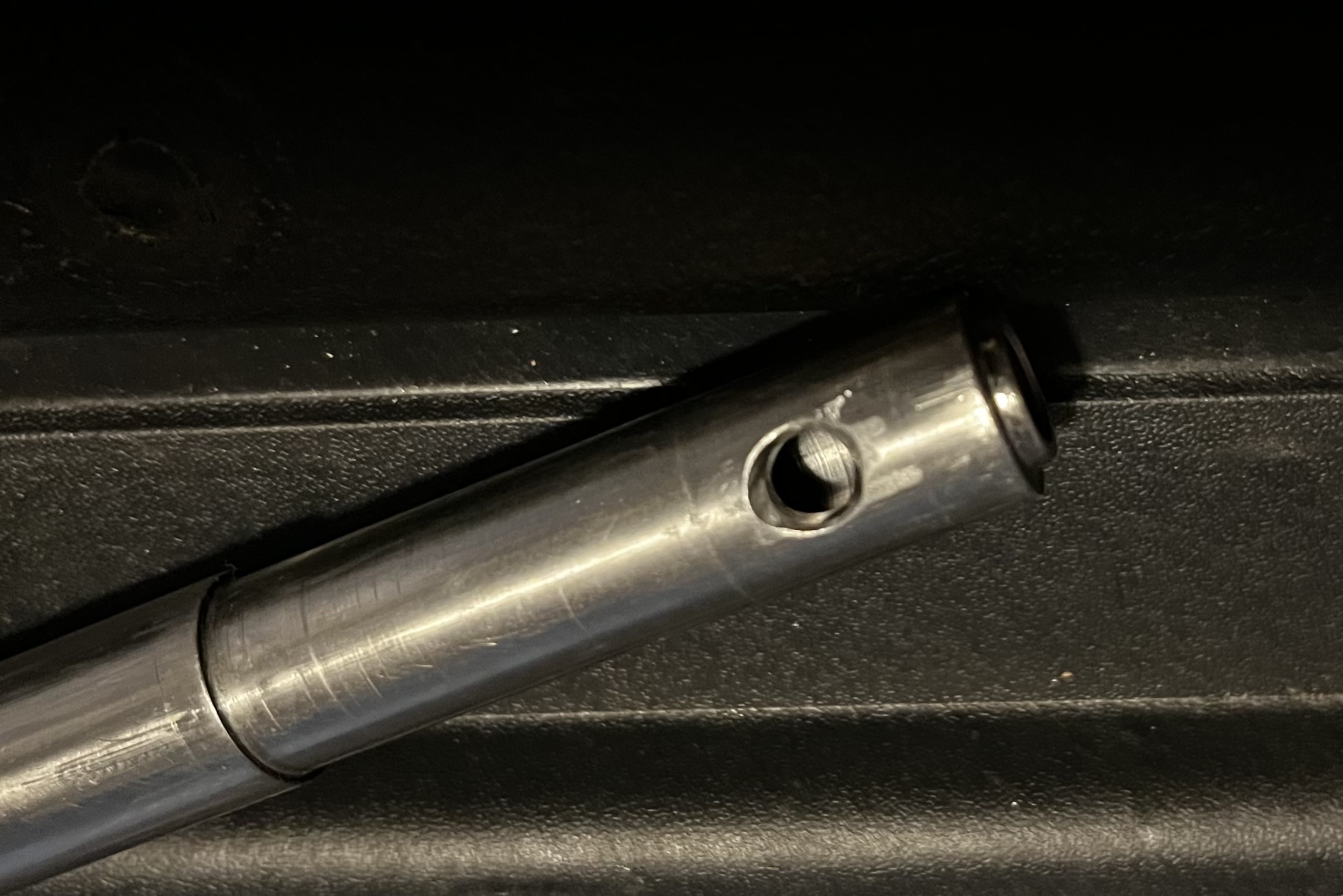

Here are 2 pics of the receiver end of my barrel. The entire barrel needed a couple thousands off and inside the breech needed an oring installed to go around the probe or bolt. Factory barrels are threaded on the end to screw on the air splitter but this just has a thick washer with oring on the outside fastened to barrel with 2 set screws. It really doesn’t seem like that much machining to me
Top is for a set screw bottom is where the air goes it behind pellet. Forgot to mention there is some machining for lead and the 2 steps you see
View attachment 456641View attachment 456642
