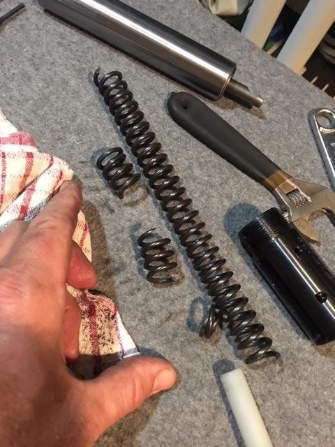

The irony is, it was acutally shooting pretty darn accurate and consistent at right about 9.5 ft. lbs. But when I opened it up for the first time to see about the low power I found not ONE spring ... I found FOUR! It was cocking fine and not making any wierd noises (no dings, pings, or grinds) Question: Why did I not get a more obvious indication that the spring was broken.. like a snap sound when it happened ... or something funny in cocking or firing? Further question: Should I just go with a new spring or upgrade to a kit? Notes -- the seal has good vacuum suction and return when I tested it with my thumb over the port. Seems the seal is good. Thanks gentlemen, and best regards.
Kinda shocked you didnt hear or feel that let go. Im guessing the lower power from the break was causing the accuracy improvement?
Exactly. Lower energy, less hold sensitive. She was shooting 1/2" vertical at 50 yards yesterday with CP 7.9s Windage not so much, but still... On chrony with very little spread but shooting slow -- like 730 fps.

I’ve never heard any crack or odd sound when a spring breaks. The give away that sometimes is amiss is loss of power or odd noises when the gun is cocked.

Broken springs are pretty rare. I’ve put between 80,000-100,000 shots through my hw97k, pro sport and R7s and have only had two broken springs. Once in an R7 with a Vortek kit that boosted power to about 7.5fpe and once in the pro sport with another Vortek SHO kit. But each of those kits gave me more than 15,000 shots so I can’t really complain. After putting 12fpe kits (ARH in the hw97k and Vortek in the pro sport) into my hw97k and pro sport I have yet to see a broken spring after 20,000+ shots. On an absolute basis, spring longevity is excellent and springs are cheap (i.e., $15-20) and easy to replace when necessary.
Best way to avoid a broken spring is to never dry fire the gun (i.e., shoot it without a pellet in breech). Keeping the power down probably helps a bit too, although if you want more power you’re still likely to get 10,000 shots or more.
