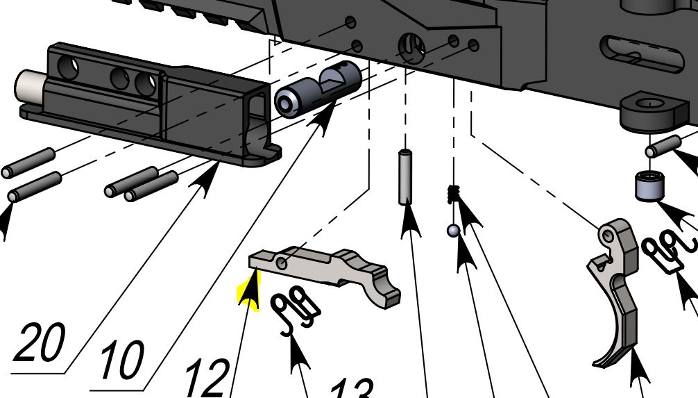

..... pushed the sear, pushed the hammer as hard as I can and it won't move...
Pushing on the front end of the sear should make it clear the hammer, but if not I would drive out the pin and dismount the sear

Towle, thanks for the info and diagram. I don't think the hammer is caught on the sear, (once the sear is decocked, I think the hammer is clear of the sear) what i think is happening is the hammer is getting caught on the trigger and there's no clearance to let the hammer move by it. I've pushed on the sear with a lot of force, doesn't seem to affect the hammer movement. I've pulled the trigger while trying to move the hammer and when the hammer gets to the trigger, you can feel the trigger stay in the pulled position, which tells me the hammer is trying to get by the trigger. I think the tolerances are off slightly on the hammer or trigger, one of them is a couple 1000ths too thick. Also, I did try ever so lightly, to punch out the sear pin, then the trigger pin. They are in there pretty good so I didn't want to force it. I'm not willing to damage anything since replacement parts are not readily available. I've watched Ed's video and XTX ltd videos, and their hammer seems to come out with little to no effort, certainly no force is used, so it's obvious to me that there's an issue with mine.

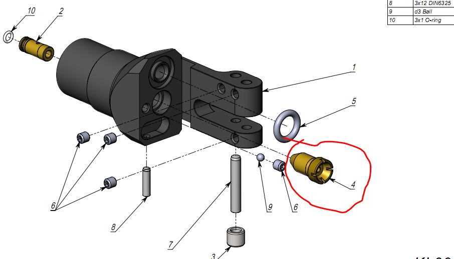

Could be Brian meant damage to the brass bushing, the contour of the first edition hammer could bottom out and damage that part if shot way under reg. pressure

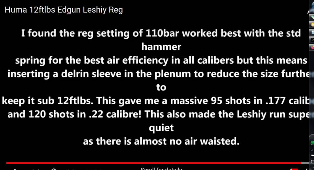

But wingman who did the design work on the 12fpe kit from huma designed the length of the valve spring to stop the hammer doing that
Just fund a screen shot I made from one of his videos, my memory was right

I did install the Huma 12 ft/lbs kit with valve, and left the stock hammer spring alone (I have no choice as of right now). Right now I'm getting about 19-20 ft/lbs for 40-42 shots depending on pellet choice. This was not far off from the previous Huma standard reg. I may turn down the reg and decrease the hammer spring tension to get back to 16 ft/lbs and see where my shot count is. I have plenty of spring tension to decrease to lower the FPS. I'm about 8-9 turns out from minimum.
Probably just leave the gun as is for now and not worry about the hammer spring.
