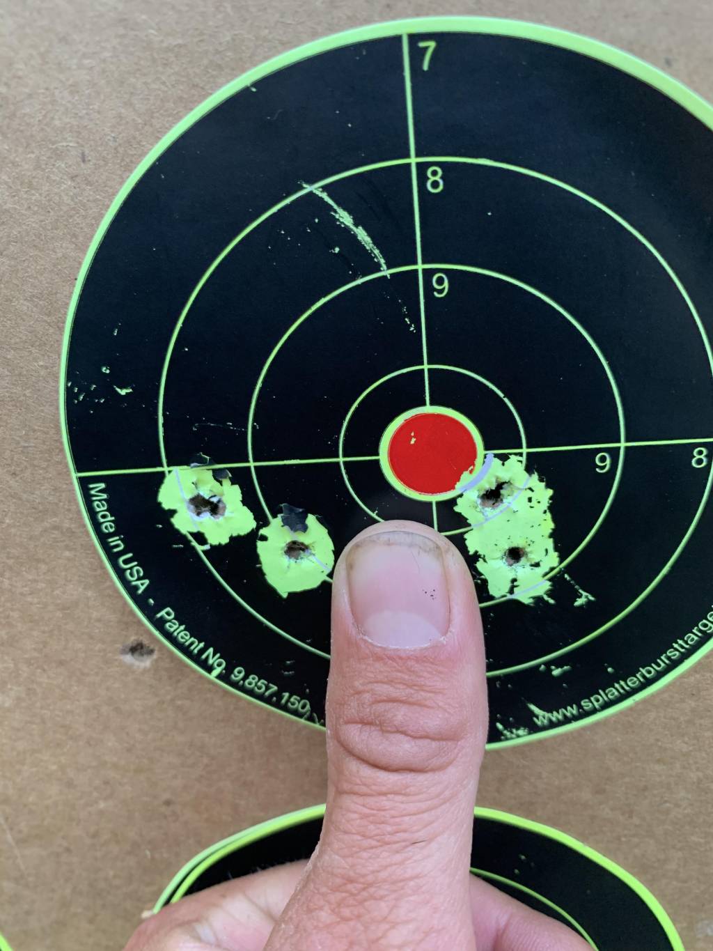

I've done some testing with .22 slugs, but most of it was for naught. I was testing some NSA slugs in my Cricket II and decided to give them a shot in the Leshiy 2. I had known from previous shooting that they were all pretty bad in the 875-950 fps range. The Leshiy 2 was setup for JSB 18.1 in the 860-870 fps range. I had the NSA 17.5 gr and 20.2gr, both in 0.2165". Loaded them up and it was shooting the NSA 17.5gr right around 825 - and the grouping was tight. I shot the 17.5 a lot more and was impressed. Re-configured the L2 to shoot the 20.2gr right around 825 and again accuracy was spot on.
I've taken both 0.2165 17.5gr and 20.2gr slugs out to just under 50 yards in my back yard and they're both giving under 1" to sometimes 1/2" groups. They handle my swirly windy back yard much better than pellets.
EDIT - I wanted to note I've lapped my .22/350 barrel twice with JB bore paste to get the accuracy I am getting. OOTB the barrel was shooting a bit of a spread.
I do get the one odd flier per mag which I've attributed to what others have mentioned already. Even though the feeding from the mag into the barrel is generally very smooth, I'm sure it doesn't take much for a poor feed to cause a flier.

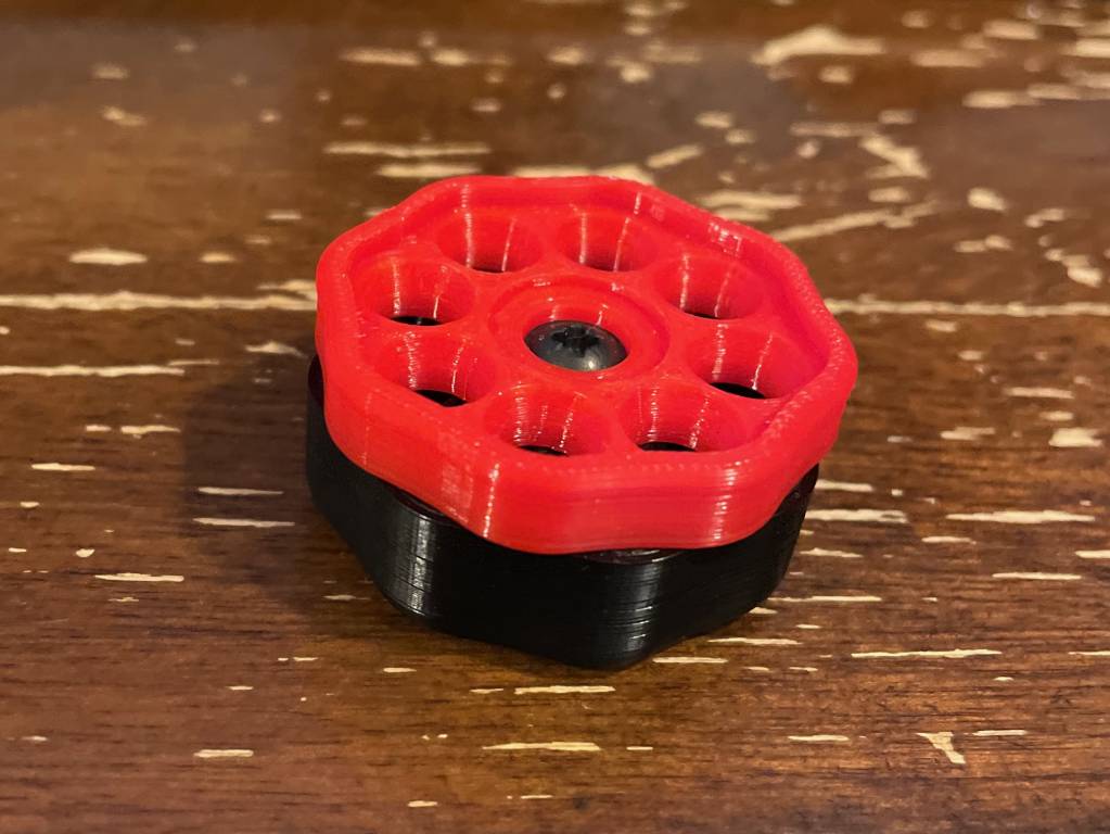

Now regarding the slugs falling through the magazine. You gotta get a speedloader and just keep the magazine in the gun. You simply remove the backplate, position the speedloader and let the slugs fall into the slots.
I have been playing with the nsa 20.2 grain .218 slugs and have been the best results out of all slugs I’ve tried. I got 7 in one hole basically twice and both had a ow right flyer. I did not change reg pressure yet and I think they were shooting around 800fps. Yes they still fall thru mag bit I use a speed loader that last plenty on a 300cc bottle and just fill mag on gun with no problems so far.
