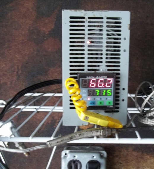

That’s just the way they come from the factory . They build them cheap to keep the cost down per unit. You can fix this problem by installing a P I D controller on the heating unit. It has a feedback temperature probe that keeps lead same temp if pot is full or one quarter full. It pulses the coil with electricity which heats up the lead. Then sensor sends feedback to the controller when to cut on or off. A lot better controller than a bi metal. Hope this helps, MM
