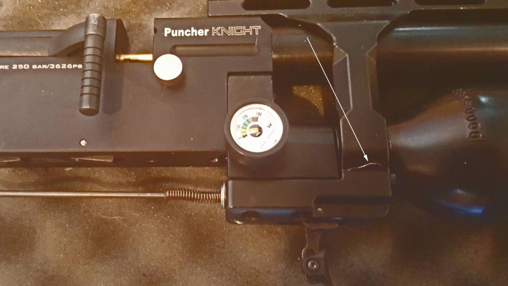

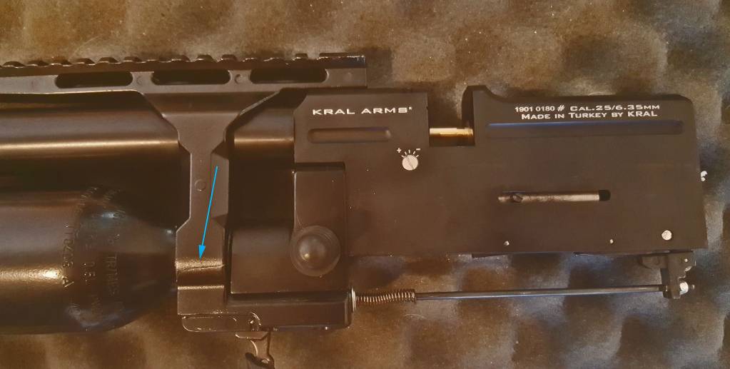

A quick update. I was incorrect in thinking that the "goo" was the culprit. It was actually caused by a broken component that I'd missed at the onset. The safety locked up again, and I once again pulled the stock. The part that is comprised of the top rear pic rail, and which the trigger mechanism and safety mount to, was broken. Snapped in half. I have no idea how to pull the air bottle in order to remove and replace the broken part. And so, off to Air Venturi...
