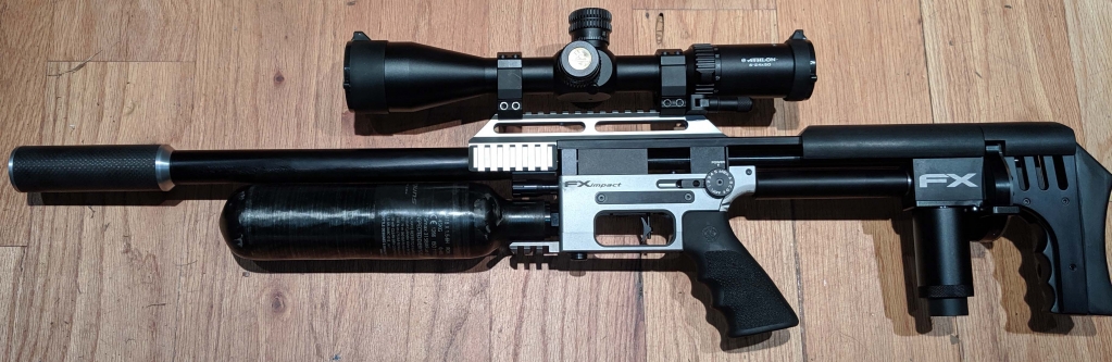

I just wanted to do a quick update. I just received my new Impact 30 cal with the power plenum. I haven't had a chance to really test it out yet. Just doing some chrony work on it inside. This is what I am seeing so far.
JSB 44 gr. reg set at 150psi the highest speed I could get here was right at 860fps. If I turned the reg up the speed dropped. I thought these came with a heavier hammer so this wouldn't have been a issue. I thought that the power wheel was almost maxed out, but after checking I had some more room to turn it in.

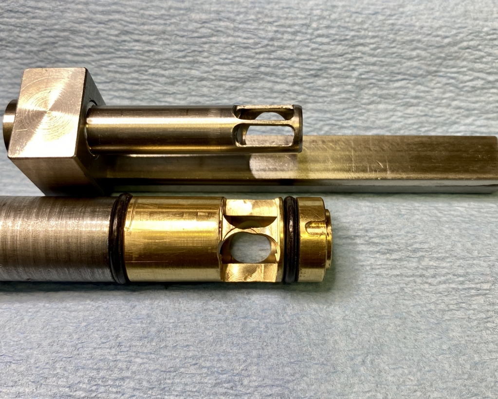

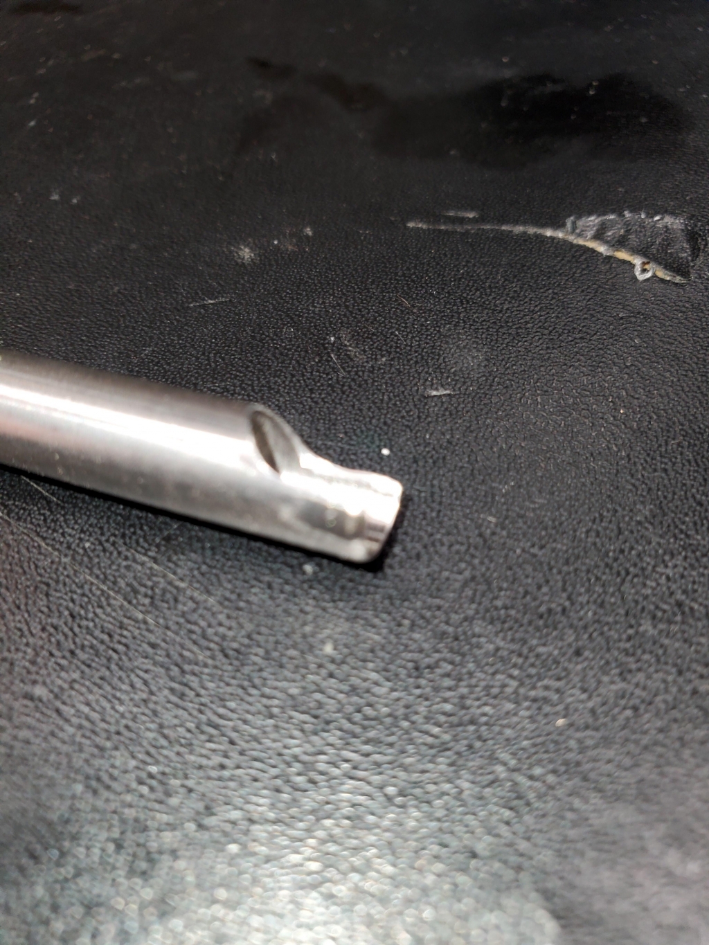

After I opened up the transferport and the pellet probe, the gun would not load pellets. I did the half moon on the probe, like I have on my 22 and 25 cal impacts, the 30 cal would not feed straight. I had 2 probes like that and neither would feed right. When I put a stock one back in it feed fine. I also checked and was able to get almost a full turn on the power wheel bolt. After doing that mod I was trying the Nielson 49gr slugs. Those where shooting 920fps. That is 92 FPE. Those are some good numbers. Hopefully I can get a little more power out of this with some more tuning. What I plan on doing is cutting the end off of one of the probes and drilling and tapping the end. Getting a rod that has some threads on the end and using that as a new probe end. I don't have access to a lath so I will give that a try for now.

Well I had a few minutes yesterday to tinker with my Impact. I turned down the reg to just over 140psi, power wheel maxed out but just free enough to turn. Shooting the 44gr JSB got me 930. The Nielson 49gr were right at 920. One thing I did find is the JSB do not load well from the magazine. I tried 3 different mags and they all would hang up. The Nielson loaded very smoothly. Not a issue for me as I plan on only shooting slugs with this.
Here is a pic of the mod I did to the probe. It would not load slugs or pellets.
