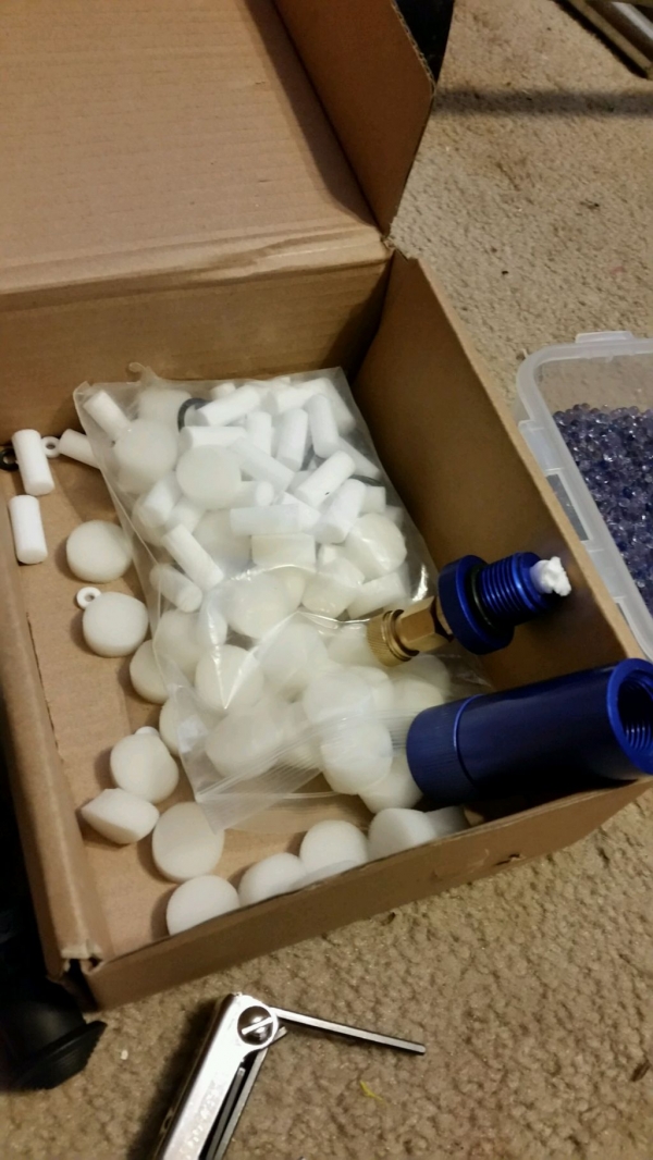

I got this filter (he took $25 offer). He sent lots of paper and foam elements with it. I use one of each at each end and then fill the center with silica beads.

Thanks guys. I just ordered the one off the link Bigtinboat provided. So BigTinBoat you say you put silica beads in the filter. Do you just cut the paper filter into sections and put the beads in between? How big of sections do you cut?

Here is a pic of the box that I was sent when I got the filter. I just put one of the "cigarette" style filters in the short end and one of the "disc" filters in the body. I then fill up the center of the body with my silica beads (got a qt from amazon a few years ago). You can see the one filter is "squashed" from me tightening it and compressing against the beads. Could probably jut cut that filter off even with the filter. I just use it so that no silica dust goes thru the filter.

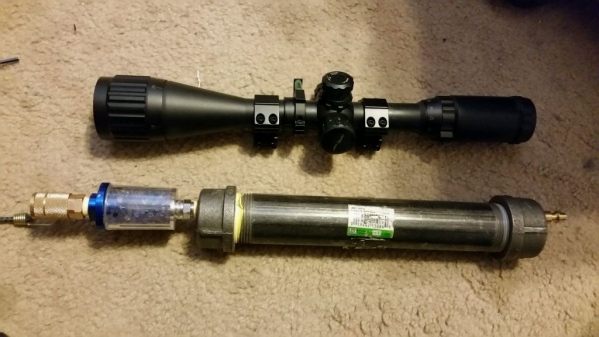

Now this other pipe is what I use as a preliminary filter between the two compressors. (shown next to CP 4-16 scope for size) I just tapped the end caps 1/4 npt and threaded QC connectors from Harbor Freight. I also use one of the "coil" hoses on each side of the filter. I got my coil hoses at Lumber Liquidators for $1 each. During the summer they have sales and sit them outside in buckets. Otherwise they are like $3 each at HF.
The clear filter was my original prelim filter and when I replaced it with the pipe I put it on the end so I can see how my beads are doing and when they need a recharge.

Thanks BigTInBoat. That makes more sense now I see it. Need to order the silica beads. I am sure I have not seen all the Shoebox videos on YouTube but have yet to see one where any of them have a filter between the shoebox and the tank. Most have the basic air dryer between the shop compressor and the shoebox. All swear they don't have any moisture. I would rather have something than nothing and for $30 it's worth a go before spending more.
