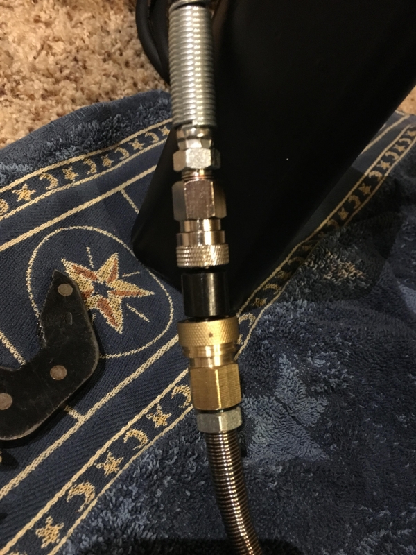

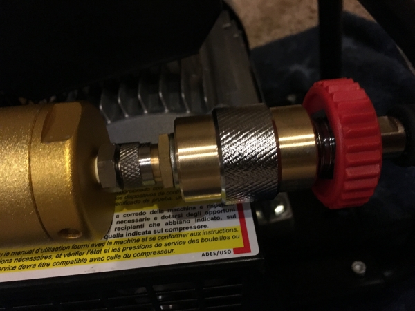

Here is the setup.
I got the DIN to foster fitting from AOA when I ordered - it came from Bestfittings. To connect the filter to tank I got a male-male quick connect from amazon.

knowing what I know now having had it in front of me, I probably would have gotten a male-male (bspp?) connection and screwed it into the filter, using the end of the filter with the quick connect to attach to the tank. Would have been cheaper and probably more sturdy.

"Centercut"@texagdds, nice setup, congrats. FYI, one thing that I do is put a female foster on both ends of each of my hoses, and a male foster on every other piece of equipment, compressor, filter, etc. This gives me maximum flexbilty to connect my equipment.
Which brand/seller foster fitting do you use? I recently got hose whipped pretty bad when my Chinese QD fitting blew a oring at around 4000psi. Happened twice with 2 separate fittings, so I'm looking to change all of them out on my compressor.
@texagdds Congrats on the compressor. I almost went that direction as well, but wanted to adjust the cutoff lower. I wish they made the type two in 120V. The AV is working good for the time being. Did you do the molecular sieve in the gold filter? Watch the hose on the filter; Mine started leaking. I got the Chinese supplier to replace it after an email duel. I ended up getting a custom hose made here. I doubt it will bust in my lifetime. Threw the extra hose in the parts drawer.
I did use zeolite in the filter. I’m replacing the hose that came with the filter with a quick connect, likewise on my regulator so I can attach a super flexible microbore hosequickly and easily.
