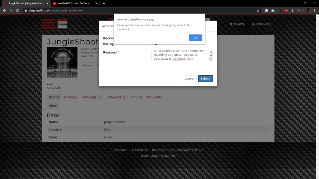

Not Cool, and I'll be reporting this to Michael..
I just tried to leave a thank you [+1 Accuracy] and the system refused.
[Here's a screen-capture, before the site deleted it and redirected me]
It's bad enough that Google/Facebook/Youtube/Media/etc. is censoring,
and/or using sketchy algorithms.. We don't need sort of thing here.
*Sigh*
