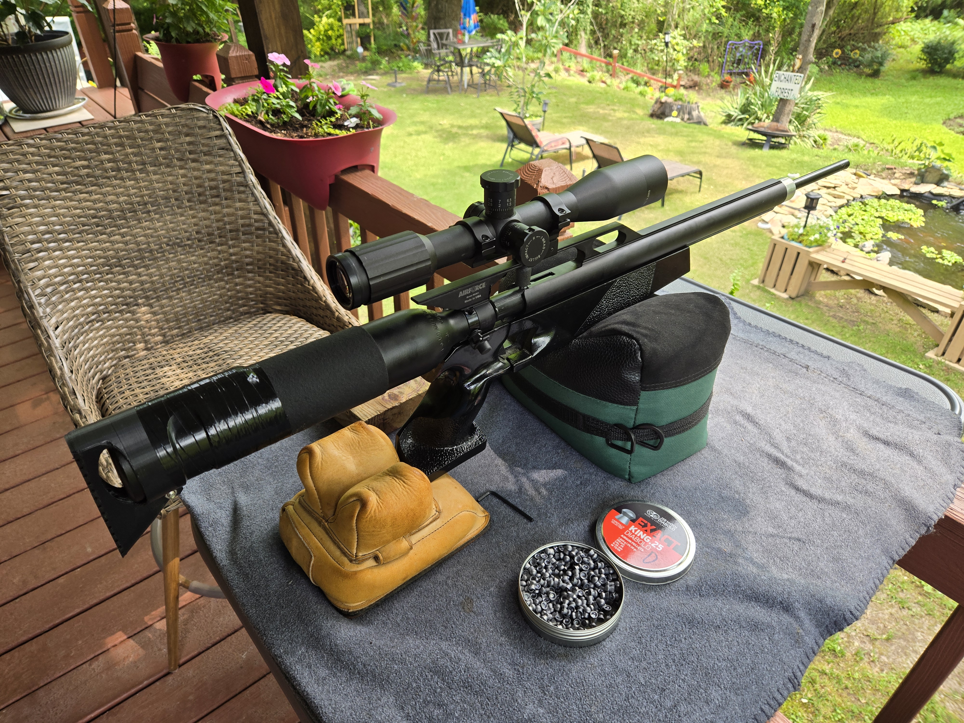

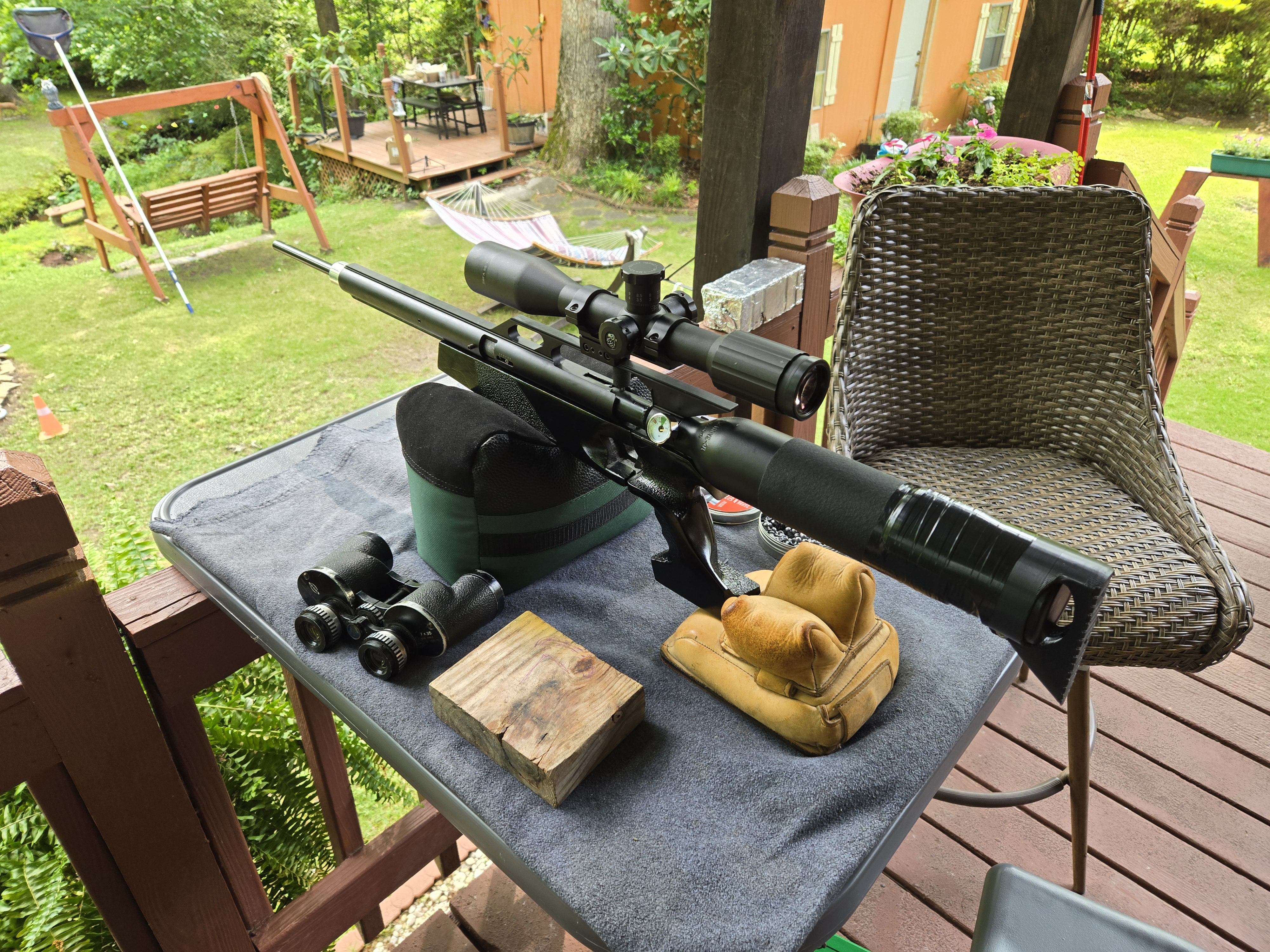

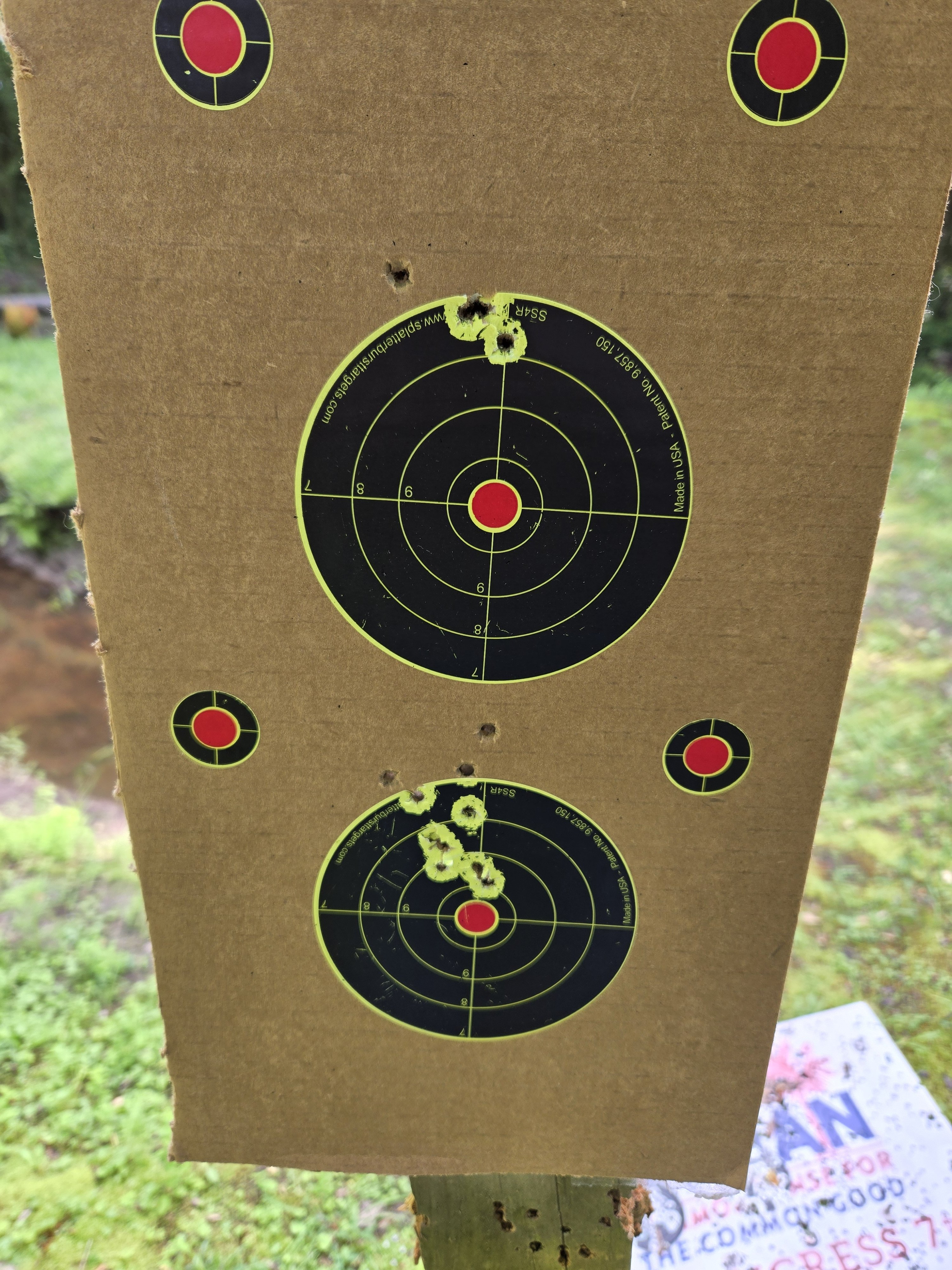

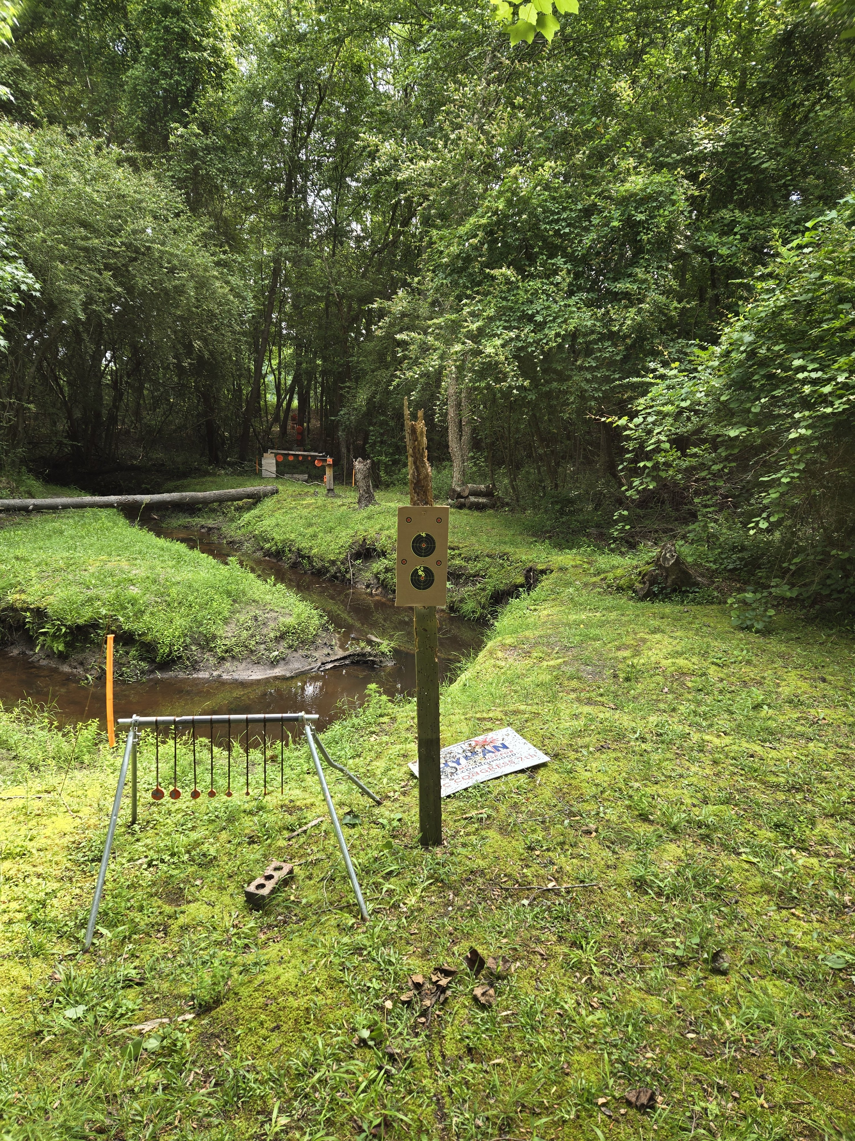

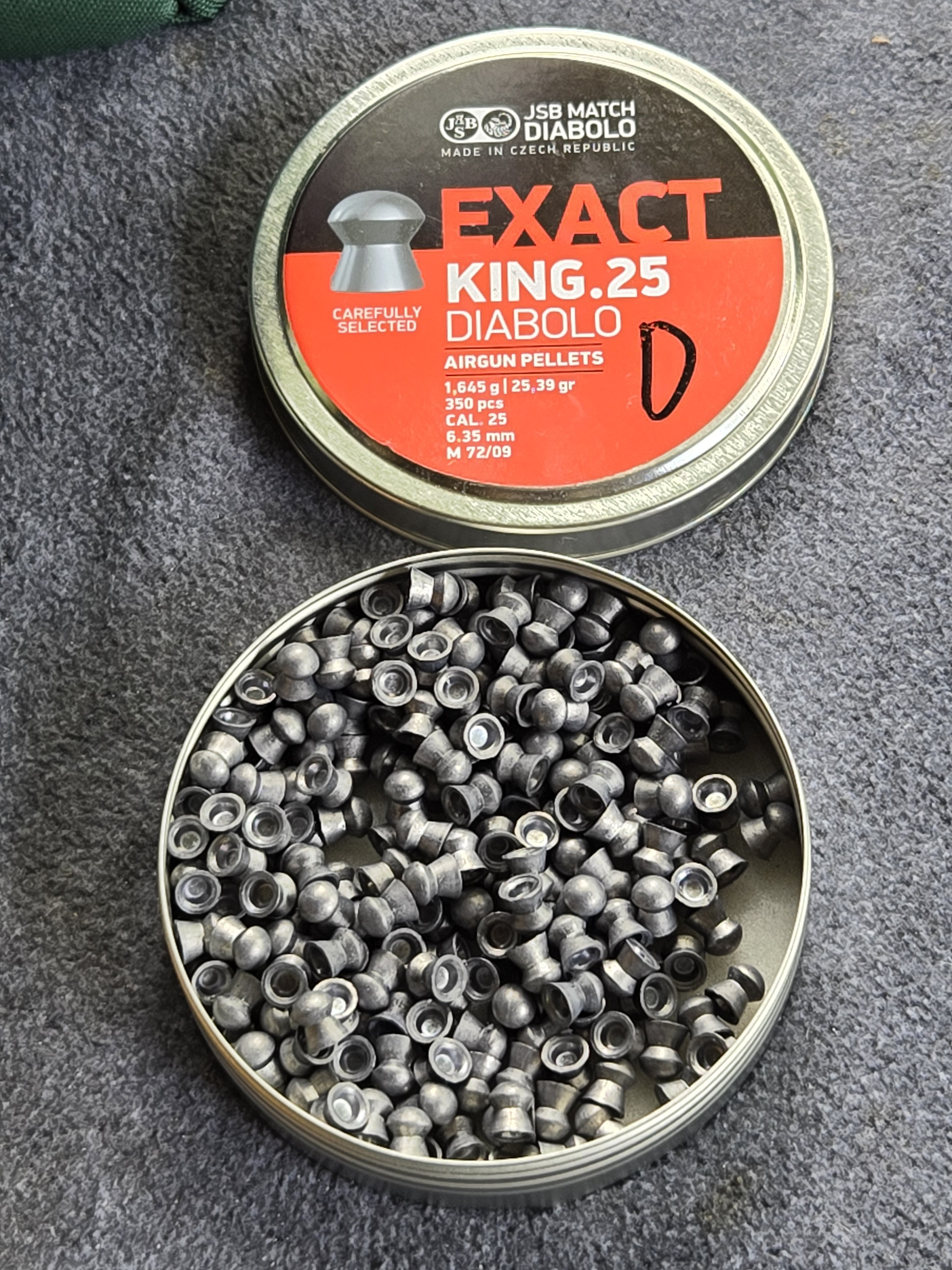

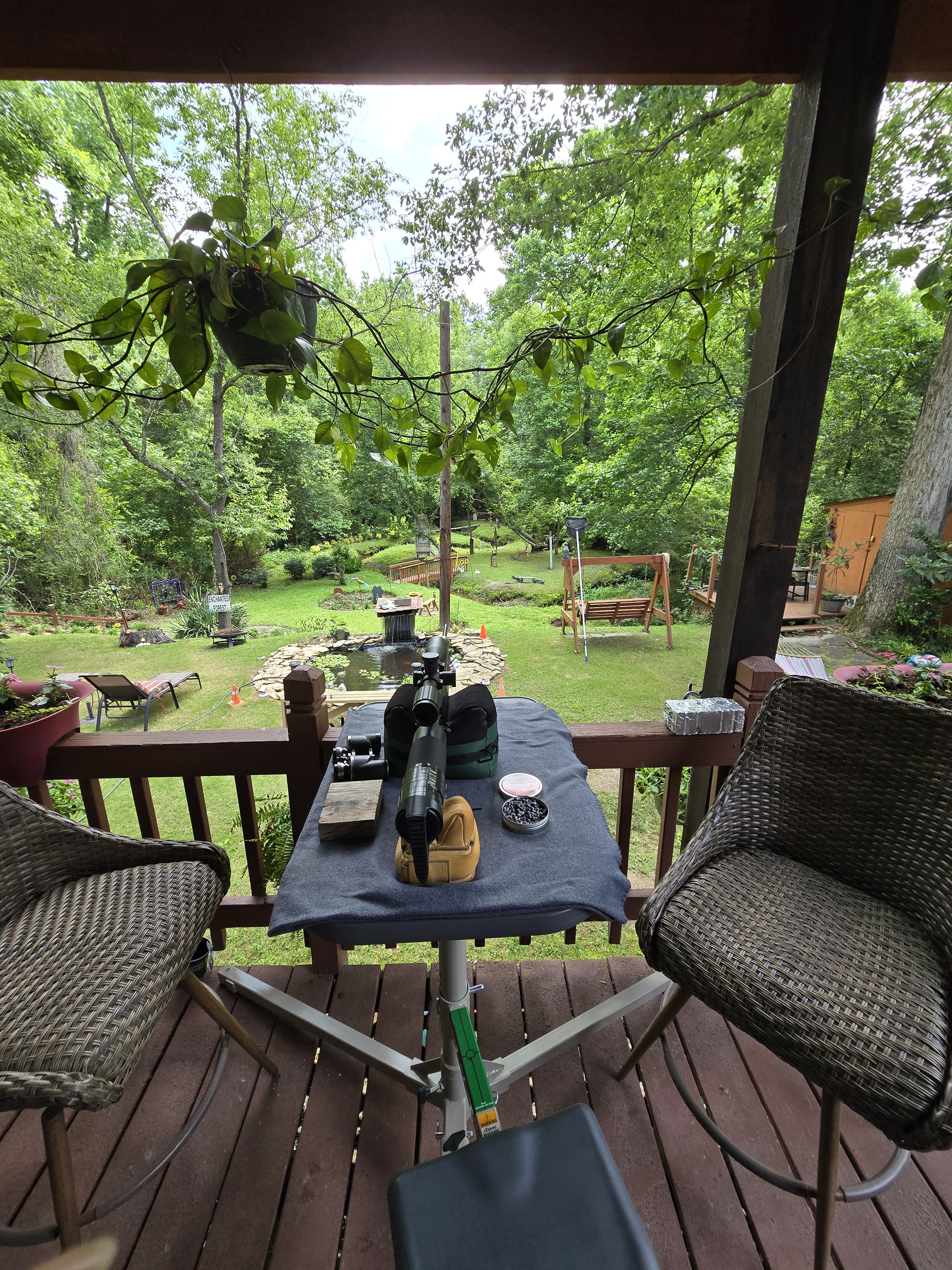

Building a condor .257. Waiting for Doug valve to complete build. Decided to try pellets in bbl. The 25.4 sorted and the 251 head ride on the 250 lands and the 260 skirt will seal for nice fit. Target @ 45 yds . Settle in @ 920 fps top Target, 4 touching and one flyer. Did not expect to shoot this good.
That's a nice group! Beautiful backyard btw!
