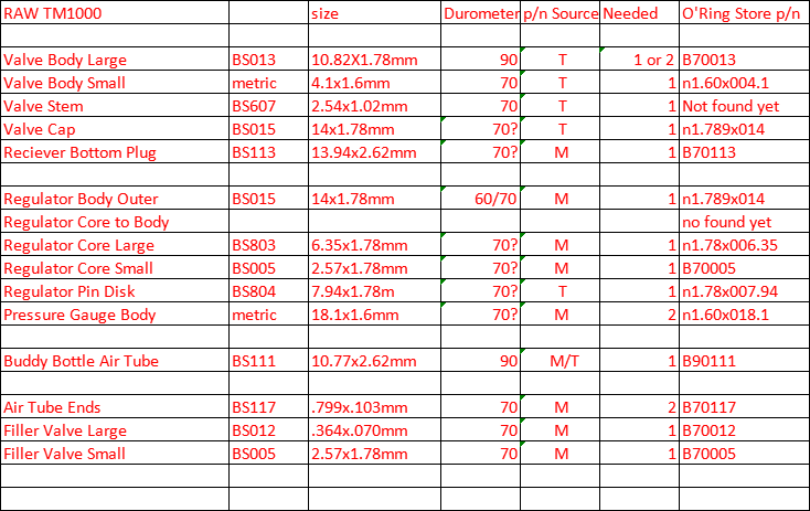

These supposedly fit TM, HM & HMx.....not positive but hopefully someone that KNOWS will chime in.....
