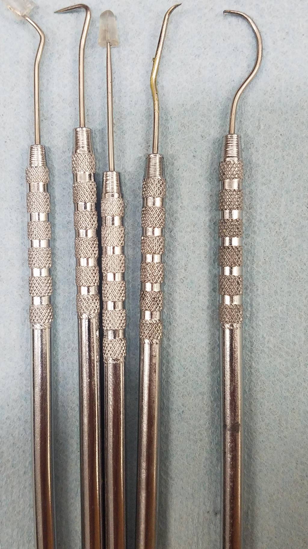

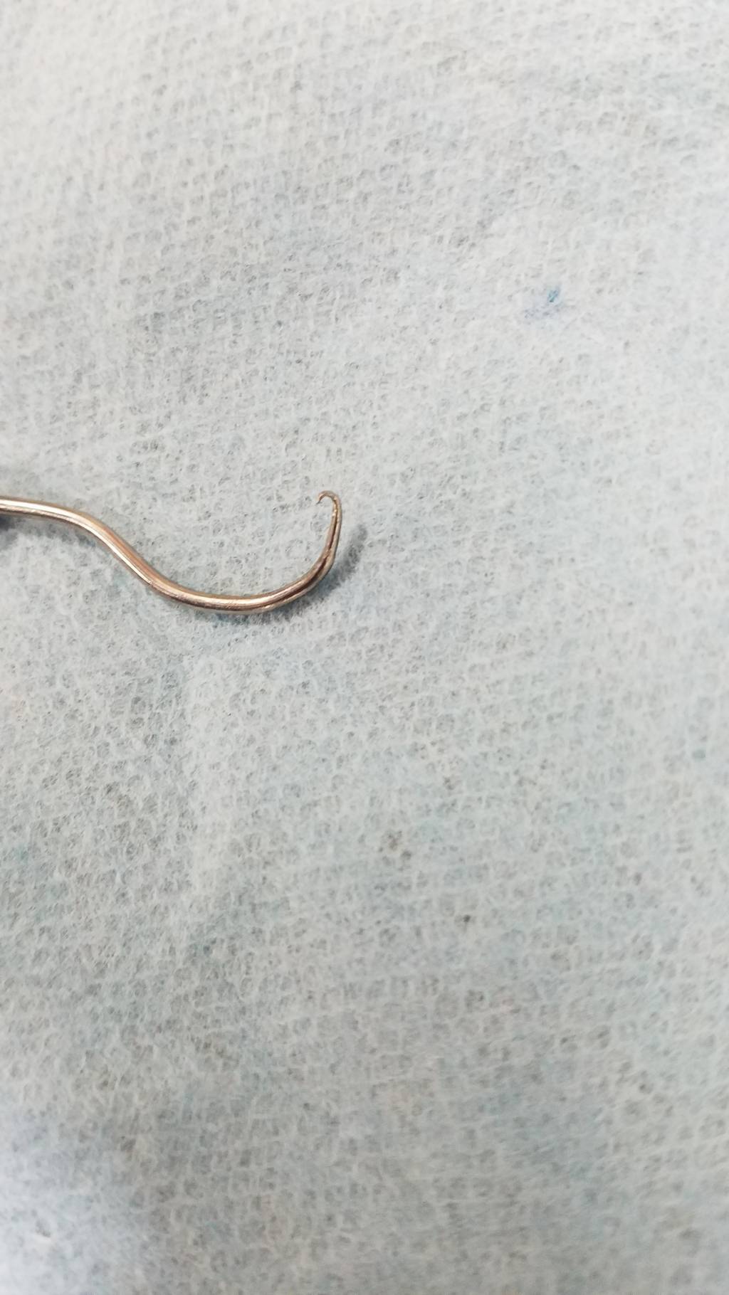

A friend showed me this.
This is a dental pick set from Harbor Freight for $2.50. Bent the tip near 180 and to slight angle. Push down beside the oring and rotate carefully and work under the oring, then pull out. Takes 10 seconds once you see what you need to do. If careful, you can reuse the oring. I remove the breech oring for every barrel cleaning. . Pull through or rod. I bought several sets to have one in cases and on bench.
Bob
