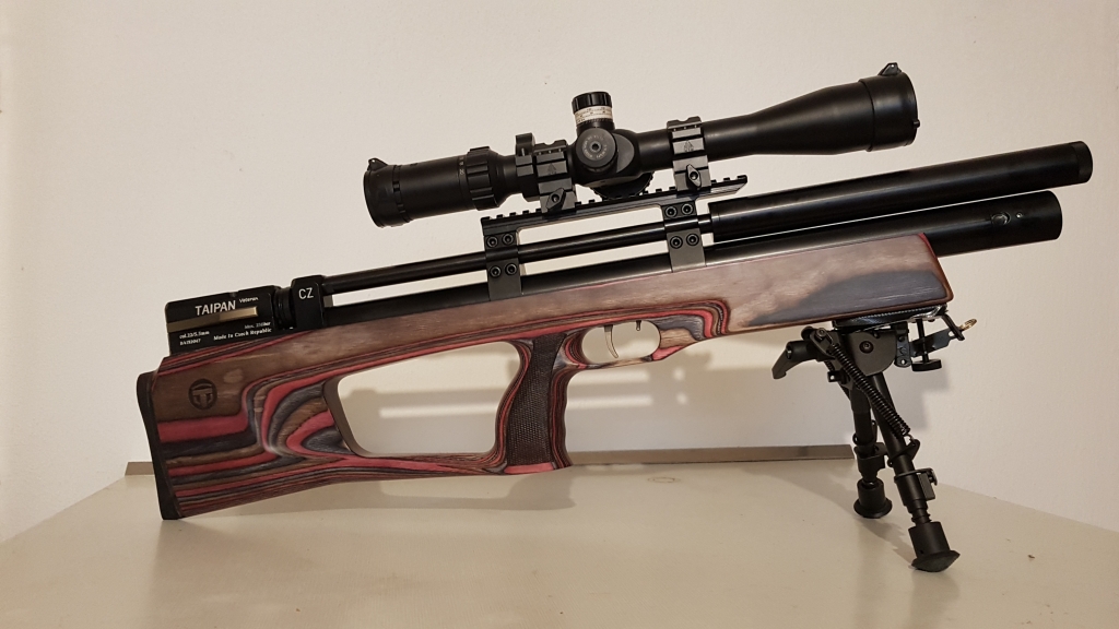

Is taipan veteran affected to change POI?
I found a tutorial from Ernest on Tallon forum some years back how correct tighten screws...
Original sentence:
I filled the AT to top off pressure 245 bars and I also taped the trigger and safety pin so they don't fall out again. Using a Wheelers torque wrench I started on the bottom row of hex screws and compete each row before moving on to the next row in blue first, yellow second and red last. I starting from 5 in/lbs and increased the wrench by 1/2 turn with each sequence until I reached 20 in/lbs. I went back and torqued the middle row in yellow again.

Sam -
IF there is a specific method of assembly and tightening in place - It's usually for a reason!
In this case, keeping the components square / true [and that could affect alignment]
If not done in the recommended / specified order, issues can and will occur.
**** [EDIT] ****
You showed that you worked from bottom to top, however, also showed tightening in a 'cross pattern'.
Left outer, Right outer, then Left inner, then Right inner.
When Wilhelm does the assembly / tightening of this section, he works from bottom to top, but,
he also just works from Left To Right. Then moves up to the middle row - Left To Right.. Then top row - Left To Right.

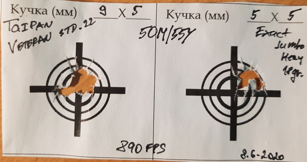

No poi change with mine. Haven't swapped scopes in over a year and I've still got the same zero in that same time frame. Shot it for the first time in around 8 weeks day before yesterday and was killing critters, didn't even verify poi before because I just know that it can be trusted.
Very reliable poi with the Veteran, messing with those screws in your pic would probably change that though.
My Veteran POI has been very stable, maybe the best of any rifle I've owned. Regarding the assembly process and sequence of tightening the screws, it might be one of those things we can overthink. I've had the barrel off of mine for cleaning, and I loosened the top eight screws. As with most assemblies containing numerous fasteners, they should be brought to the desired torque in a uniform manner. Beyond that, I don't think the precise sequence is critical. I had not heard of this specific recommendation at the time, and can't remember the sequence I used in tightening them. I believe the goal is to avoid ending up with uneven stresses on the assembled pieces, and how that is accomplished can vary. Just my opinion.

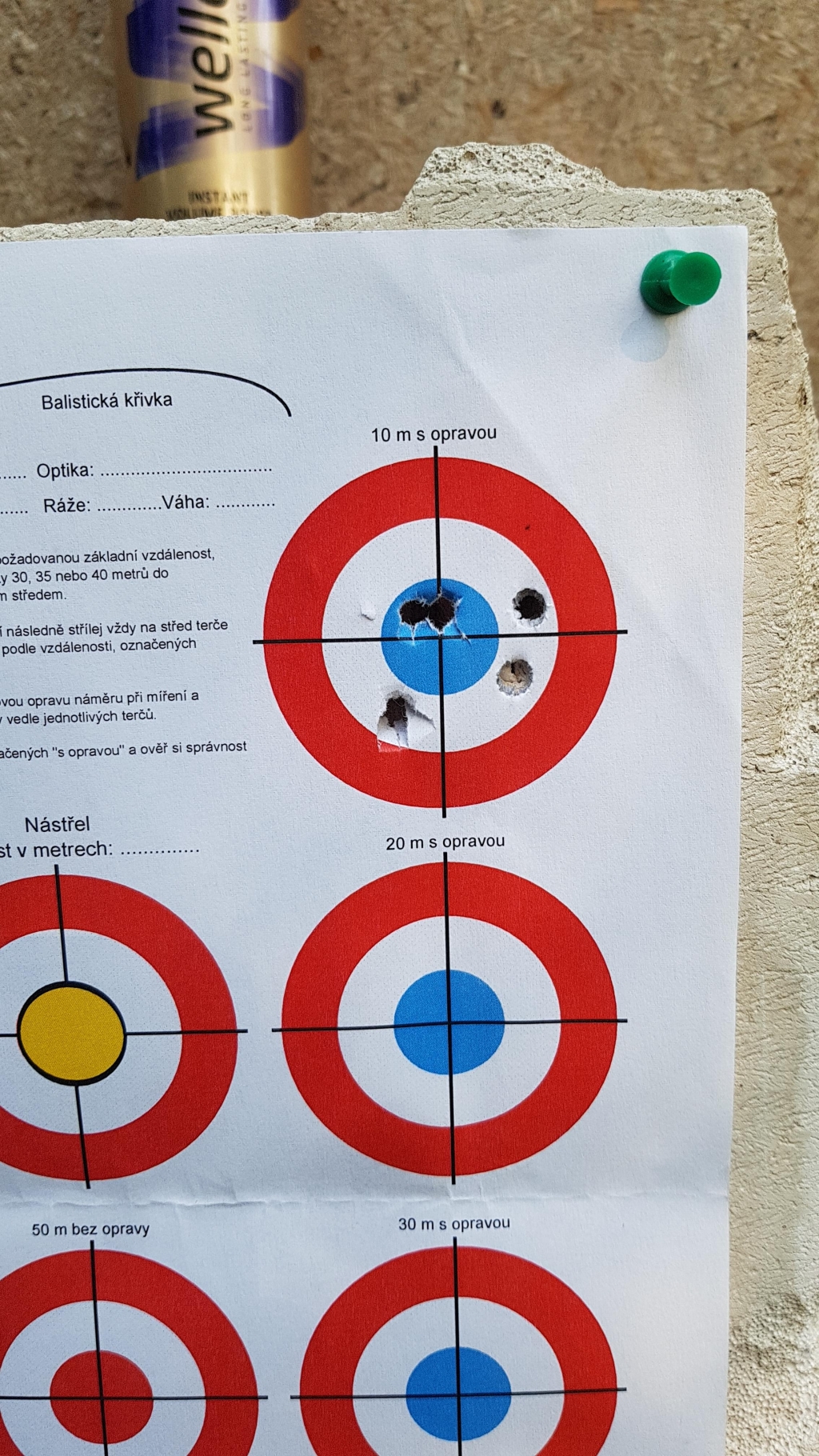

But Ernest did this tutorial may be 5 years ago :) The men in production doesn't have moment key and he working with no pressure in At. Ernest suggest to fill at 245bar. I would like to know if all users of taipan does not have any change poi?
